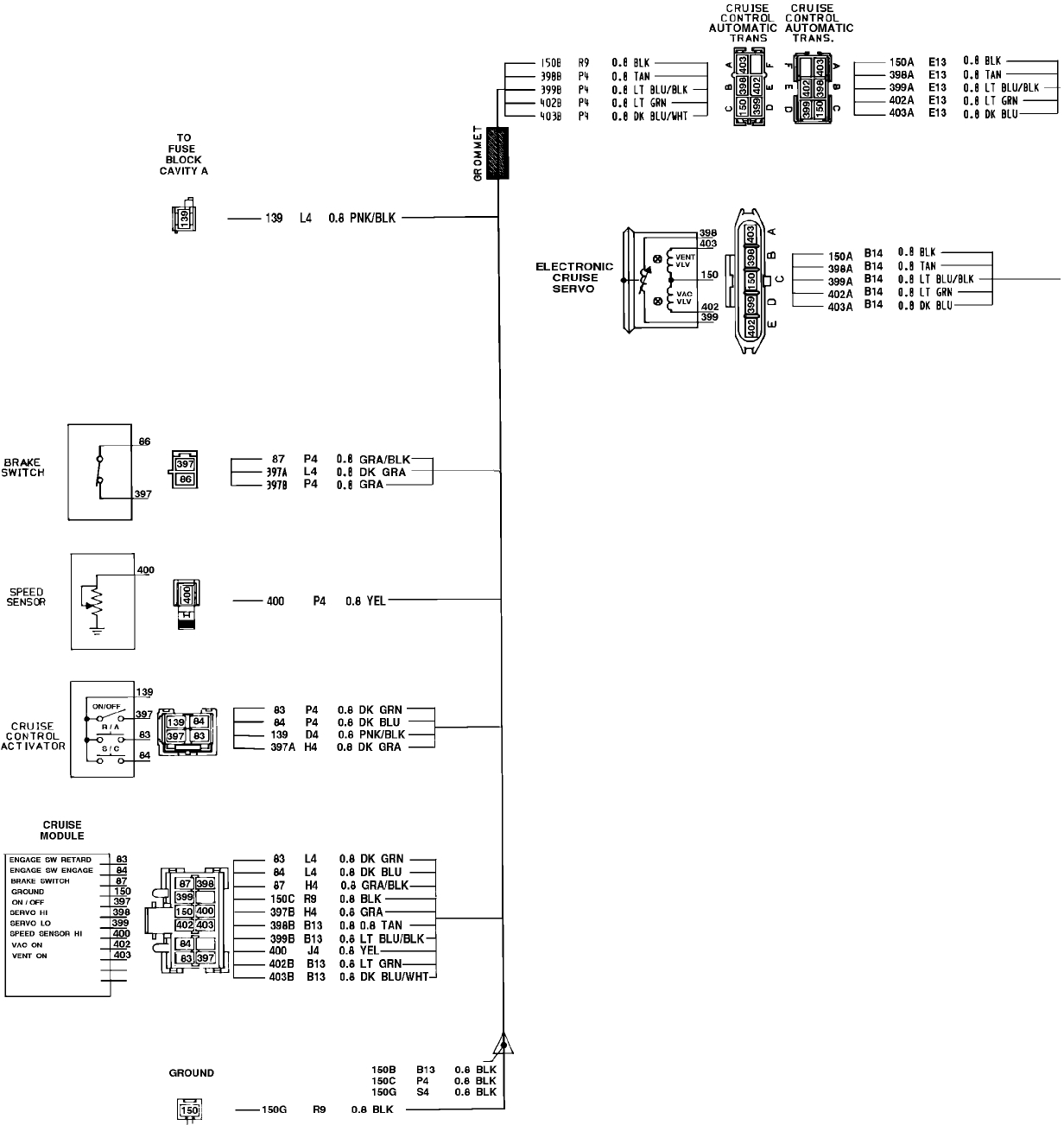

Wires on cruise control switch broke off at connection. the switch is made by ALPS it has four pins side by side wire colors are red, blue, green and yellow. which wire goes to which pin?

if it is not a factory connection we do not have any schematics on that contact the company that made it.

Looking at the wiring diagram I don't see those colors for any of the OEM cruise parts. Think you could take a picture of the switch and the cruise under the hood? It's possible the switch is a replacement or non OEM. Is this the switch on the stalk or the one on the brake pedal?
