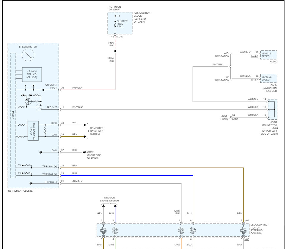

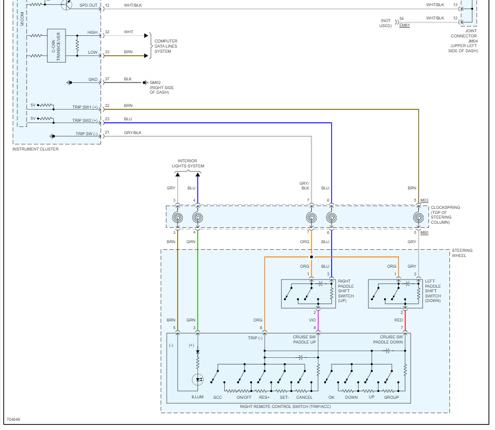

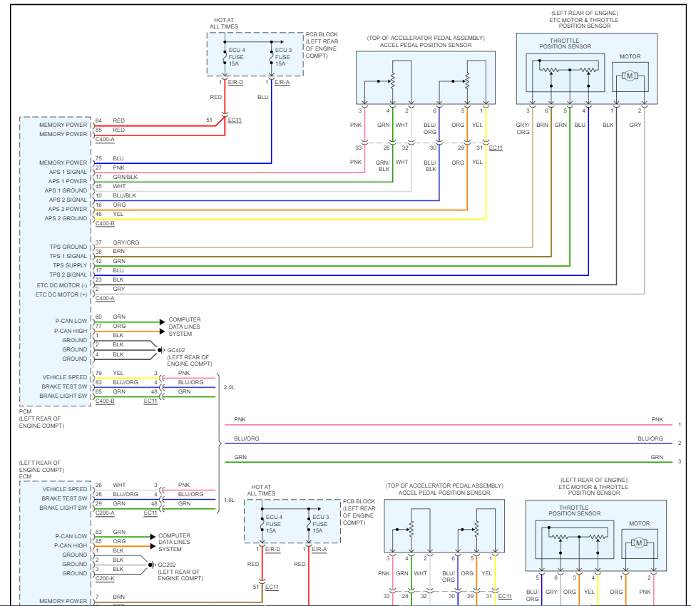

Once I set my cruise control, instead of staying at the speed I set it at it fluctuates up to 5-7 miles faster / slower. Cruise control is supposed to maintain the speed it's set to correct?
May 21, 2023 at 1:17 PM
  • 55,214 POSTS

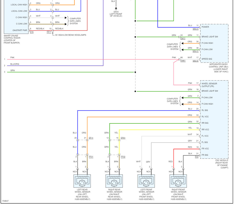

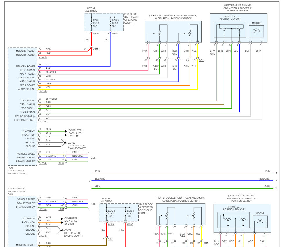

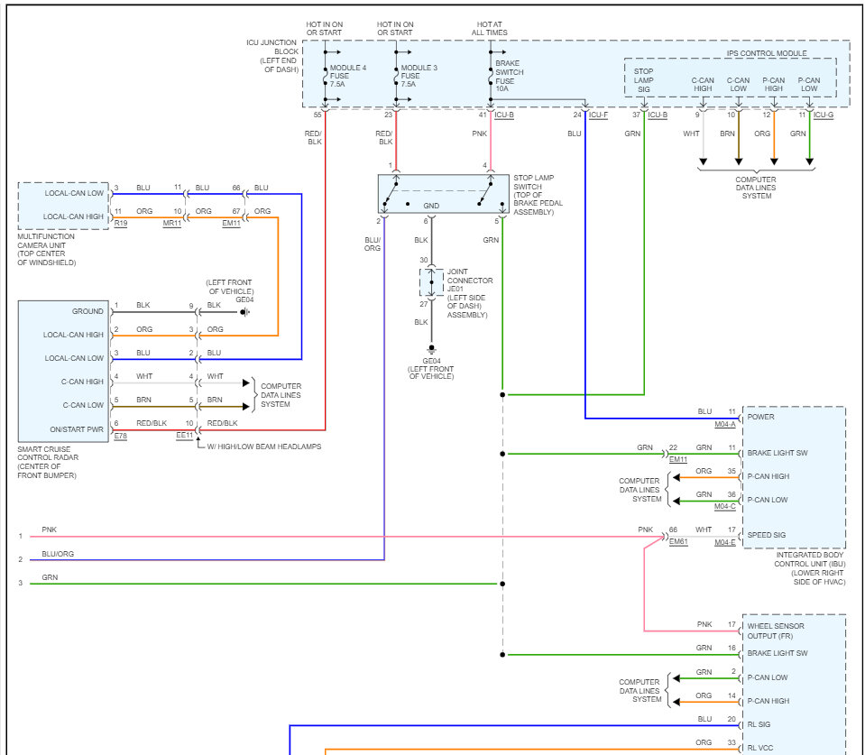

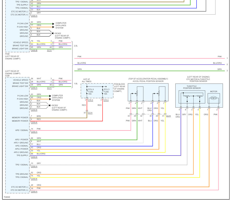

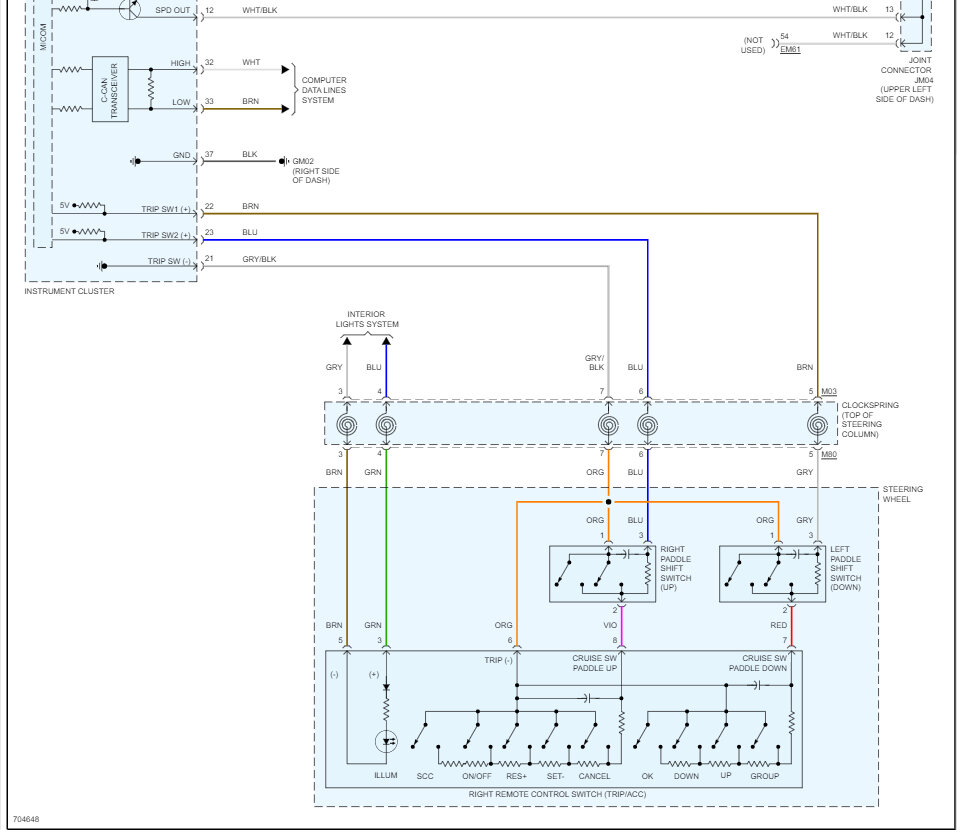

It sounds like you may have a radar sensor that is going out which affects the cruise control. We should run a CAN scan; you can get a CAN scanner (Controller Area Network) which will work on most cars from Amazon.
https://youtu.be/u-4syLc-ifQ
and
Here are the cruise control wiring diagrams so you can see how the system works. Check out the images (below). Please let us know what happens.
