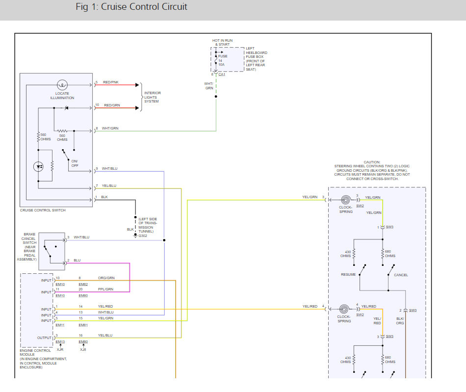

Cruise control not working and have a surge, put on diagnostic shows nothing.
Dec 18, 2019 at 12:32 AM
  • 55,433 POSTS

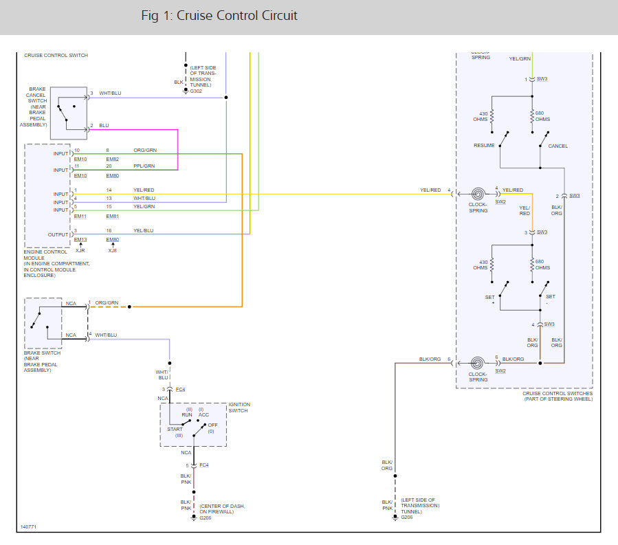

It would check the fuse #14 for the system first and then test the clock spring behind the steering wheel which goes bad often. Here is guide to help check the fuse with the cruise control wiring diagrams below so you can see what to check and how the system works:
and
https://www.2carpros.com/articles/steering-wheel-clock-spring-removal
