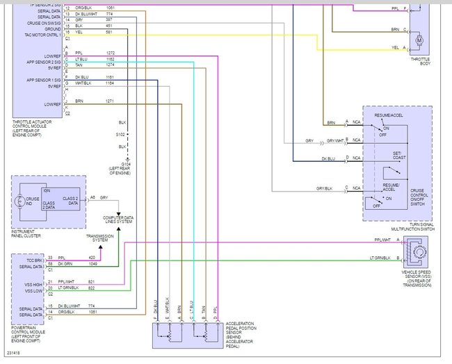

Hey Guys. The cruise control stopped working a year ago so I replaced the fuses, brake light switch and steering column wiper/turn signal/cruise lever. It did not fix the cruise. And there are no codes when I check with the code reader. This weekend I hooked up a U-Haul trailer to move some stuff and the cruise control worked again all day while the trailer lights were plugged in. I used a 7-pin adapter to plug the 4-pin U-Haul lights into. After I disconnected the U-Haul the cruise stopped working again. I plugged in the 7-pin adapter thinking that may have had something to do with the cruise coming alive, but no luck. Is there some type of load sensing switch that controls the cruise control under a load? I am stumped! Thanks

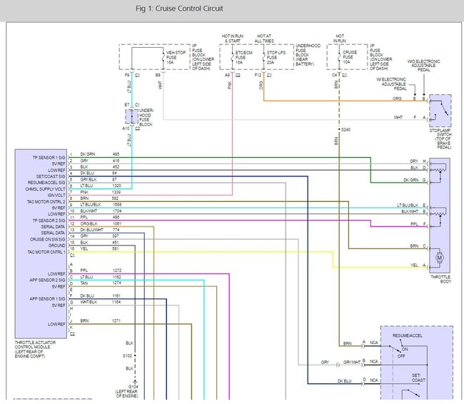

Nothing like a load sensor for the cruise. Did you happen to notice if the cruise only worked when you had parking lights on?
If you have a trailer brake controller you might try unplugging it from the fuse box and see if the cruise works then. Maybe it is feeding just enough voltage into the brake light circuit to make the cruise think you are stepping on the brake and shuts the cruise off?

Penzfan, I was talking to a couple other techs about your problem. All of us came to the same conclusion. It did what! :-)
I do have a strange test. Try pulling the CHMSL fuse out of the lower fuse panel and see if your cruise returns. That is the circuit that feeds the trailer brake lights and tells the PCM to shut off the cruise control. Perhaps some corrosion or something could be causing enough current flow to shut the cruise off (just like stepping on the brake).
With the the light converter and the trailer that may have created enough of a load to stop that current flow and the cruise turned back on.

  • 55,748 POSTS
Hey PENZFAN,
It sounds like it could be the switch, here is a wiring diagram and guide for you to start testing the system.
Please run some tests and get back to us so we can continue helping you.
Best, Ken
Jan 9, 2017 at 6:03 AM
PENZFAN
  • 11 POSTS
Thanks for the feedback and diagrams Ken. Do you mean the turn signal/cruise/wiper switch? Because that has been replaced. Where should I start testing the circuits?
