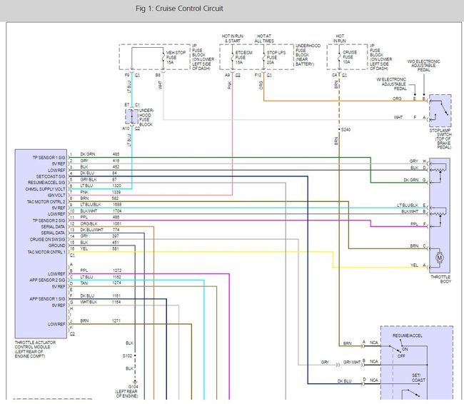

Hey Guys. The cruise control stopped working a year ago so I replaced the fuses, brake light switch and steering column wiper/turn signal/cruise lever. It did not fix the cruise. And there are no codes when I check with the code reader. This weekend I hooked up a U-Haul trailer to move some stuff and the cruise control worked again all day while the trailer lights were plugged in. I used a 7-pin adapter to plug the 4-pin U-Haul lights into. After I disconnected the U-Haul the cruise stopped working again. I plugged in the 7-pin adapter thinking that may have had something to do with the cruise coming alive, but no luck. Is there some type of load sensing switch that controls the cruise control under a load? I am stumped! Thanks

Nothing like a load sensor for the cruise. Did you happen to notice if the cruise only worked when you had parking lights on?
If you have a trailer brake controller you might try unplugging it from the fuse box and see if the cruise works then. Maybe it is feeding just enough voltage into the brake light circuit to make the cruise think you are stepping on the brake and shuts the cruise off?

Penzfan, I was talking to a couple other techs about your problem. All of us came to the same conclusion. It did what! :-)
I do have a strange test. Try pulling the CHMSL fuse out of the lower fuse panel and see if your cruise returns. That is the circuit that feeds the trailer brake lights and tells the PCM to shut off the cruise control. Perhaps some corrosion or something could be causing enough current flow to shut the cruise off (just like stepping on the brake).
With the the light converter and the trailer that may have created enough of a load to stop that current flow and the cruise turned back on.

If the cruise starts working maybe get a short extension harness (cheap one, as it's going to get cut). Then cut each light feed one at a time. When you cut the one that stops the cruise from working post it here. Along with the make model of the adapter. Maybe it's a diode or feed in the system that is letting it work, like a better ground or ?????

Hey PENZFAN,
It sounds like it could be the switch, here is a wiring diagram and guide for you to start testing the system.
Please run some tests and get back to us so we can continue helping you.

Thanks for the feedback and diagrams Ken. Do you mean the turn signal/cruise/wiper switch? Because that has been replaced. Where should I start testing the circuits?

OK here is a possible item. Talked to a GM engineer about this, he said that the system won't activate if it detects the wrong resistance from the bulbs. This might explain why it worked with the trailer plugged in. The trailer lights added enough resistance to make it work. He said they have seen this with LED replacement lamps and with some brands of bulbs. I'm wondering if you have a similar issue. I can't think of a way that resistance would drop in a common circuit though, usually it's a case of higher resistance.
