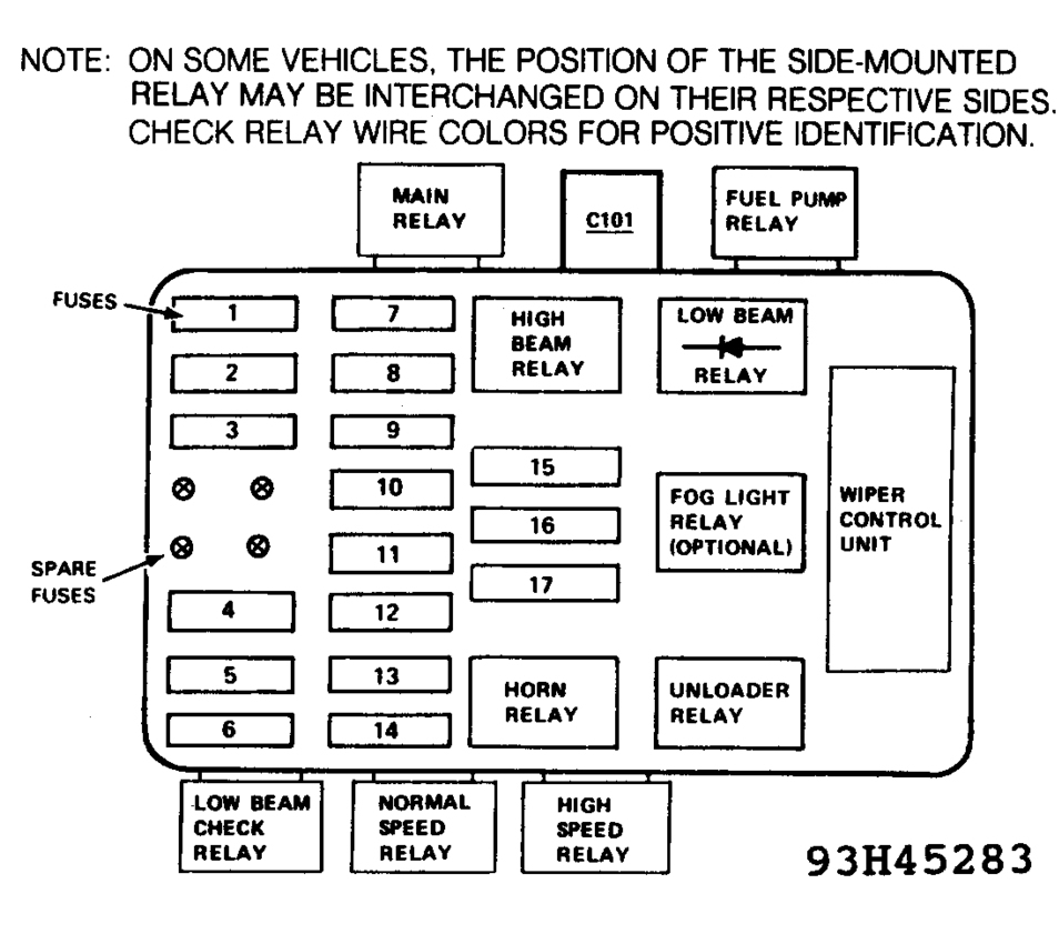

When the vehicle is cold, the cruise control works, after a trip (or when the engine warms up) there is no response.
How does the cruise control work/how can I fix it?
Apr 16, 2016 at 7:02 AM
  • 55,612 POSTS
Hi DELTAKILO,
It sounds like the cruise control module is bad and when used the heat stops it from working, but just to be sure check the fuse to make sure its not loose in the holder, here is a diagram to help. The fuse is number is 6 and 12.
Please let me know what you find
