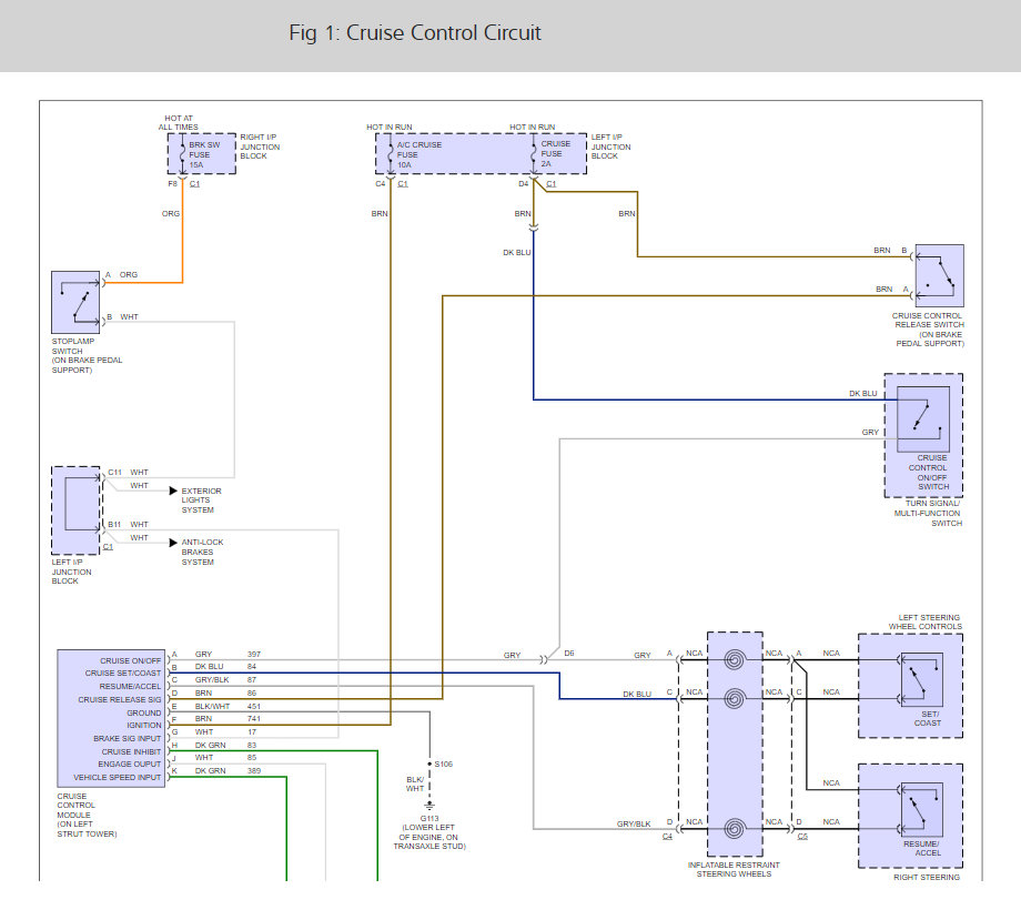

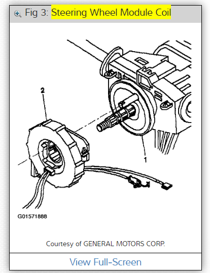

Cruise control turns off and on by self, even if cruise is off with switch. Cruise controls blower. Mileage/dash does not light. Gas gauge does not not display properly.
Oct 10, 2018 at 3:15 AM
  • 55,746 POSTS
These sound like seperate problem please start a new question for the gas gauge. Please post your new question here, you must be logged in.

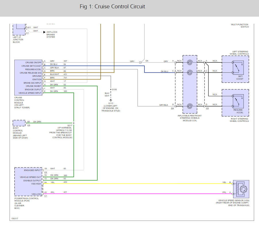

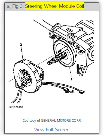

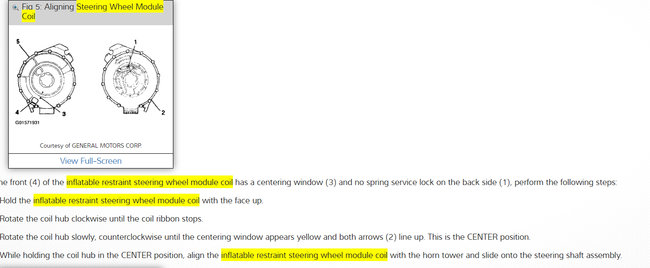

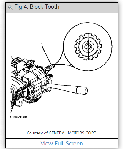

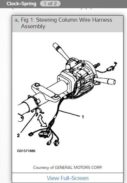

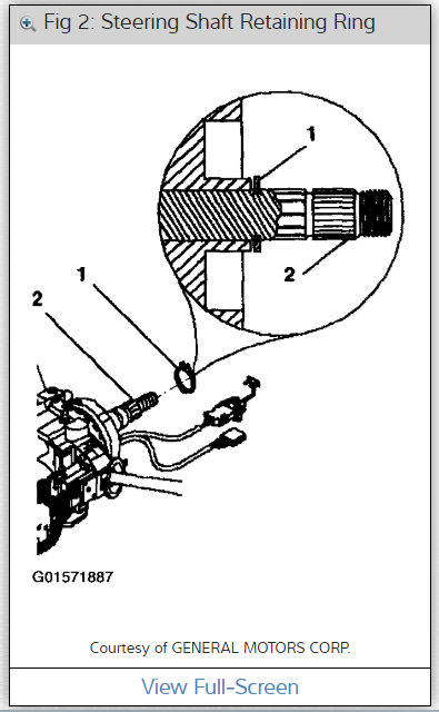

As far as the cruise control it sounds like the clock spring behind the steering wheel is going bad which will cause issue you have. To be sure here is a guide to help you check the wiring with the wiring diagrams of the cruise control so you can see how it works and how to replace the clock-spring if confirmed:
https://www.2carpros.com/articles/steering-wheel-clock-spring-removal
and
Check out the diagrams (below). Please run this test and get back to us.
