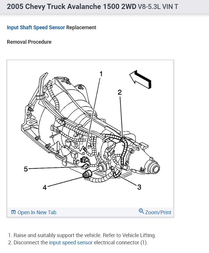

Cruise control is set, when going up hill the control tries to get a lower gear to maintain speed, when all of a sudden the engines RPM pegs to over 5K engine shuts down. I have to put it in neutral while moving to start engine. This issue never happens when cruise control is off. What can be done? Thanks

It could be. To be sure lets do a CAN scan which is the future of automotive repair you can get a CAN scanner from Amazon for about $50.00. here is a video to show you how:
https://youtu.be/InIlnsjOVFA

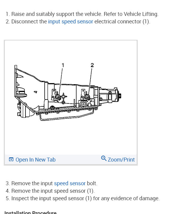

I have seen the input shaft speed sensor cause this issue as well. Here is the location so you can check it out.
