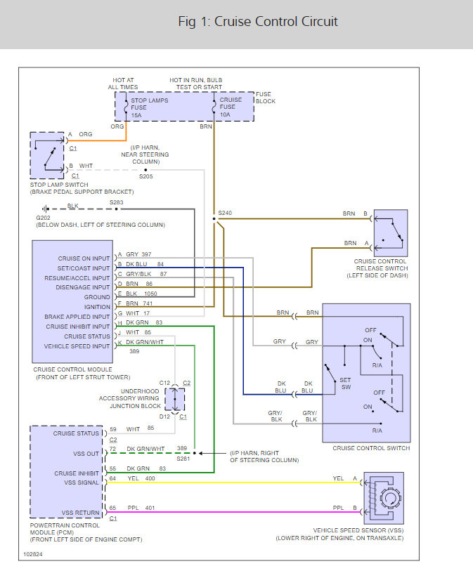

Recently developed. Cruise control works great for forty miles early in morning going to work. After weather warms in afternoon going home only about fifteen to twenty.
What it does it kicks out. Feels like you cut a tight rope pulling the car and it breaks. when it is on it performs perfectly. It will come on again after about 4.5 miles and kick off again after three miles. this happens after those first miles and times of day as noted above. it seems heat related. No light but after that three miles something happens and it will engage for about four miles. I had a mechanic replace the brake switch, no help. I found one marginal lamp in brake system no help. It works perfect when it will turn on.
What should we try next. Brake pedal returns fine.

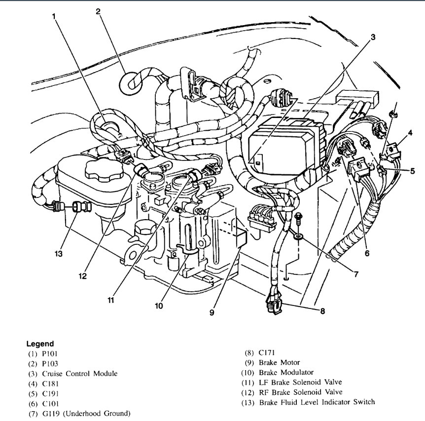

9 times out of 10 its the cruise control module. Here are instructions that walk you through the steps with diagrams below to show you how on your car and the cruise control wiring diagrams so you can see how it works. Check out the diagrams (below). Please let us know what you find. We are interested to see what it is.
