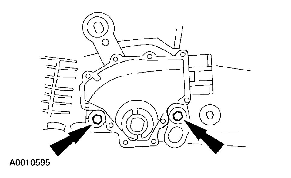

Car shuts off power but when you touch the battery clamp it turns on but you can only start car on neutral.

Good afternoon.
The first thing I would do is to clean the battery cables so you have a good connection.
As far as the starting, you may have either a bad park/neutral switch or it is out of adjustment.
Image (Click to enlarge)
