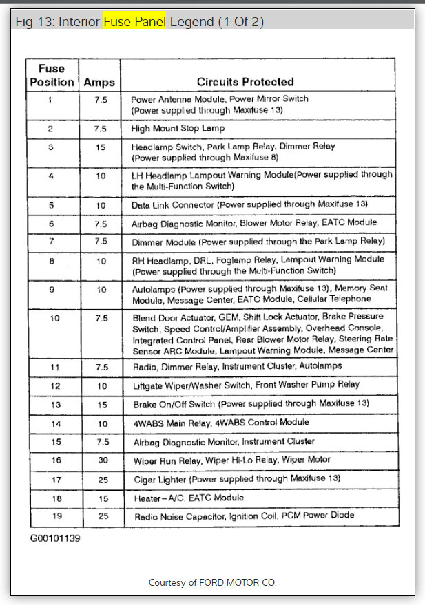

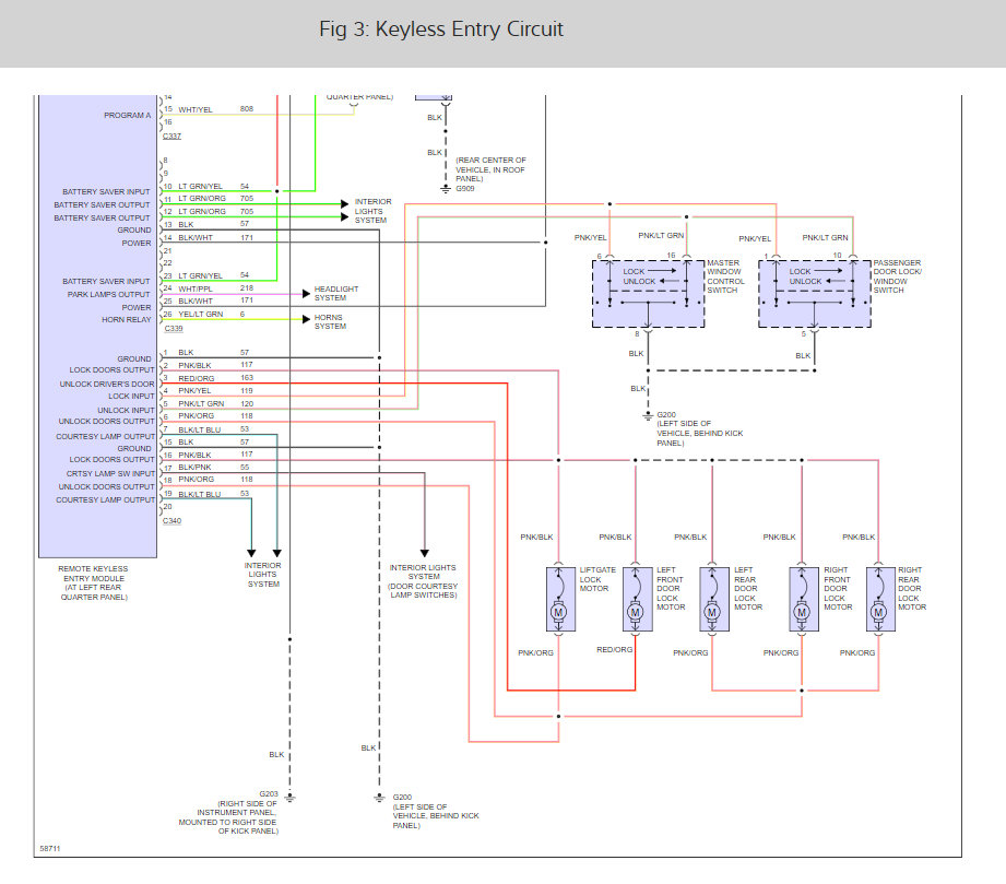

Door locks do not work
120,000 MILES • 4.0L • 6 CYL • 4WD • AUTOMATIC
ELWITHAM
Both lock-Unlock works headlights while off.
Remotes do not work.
Door unlocks don't work.
Door locks work.
Drivers Seat adjust doesn't work.
Pass. Seat adj. Works.
Radio doesn't work.
Checked fuses under hood - okay.
Didn't check fuses under dash.
Rear hatch doesn't unlock with key or button.
Everything else works.

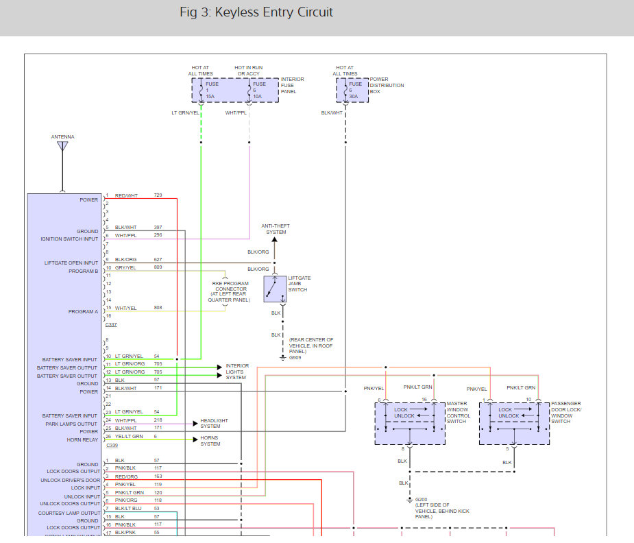

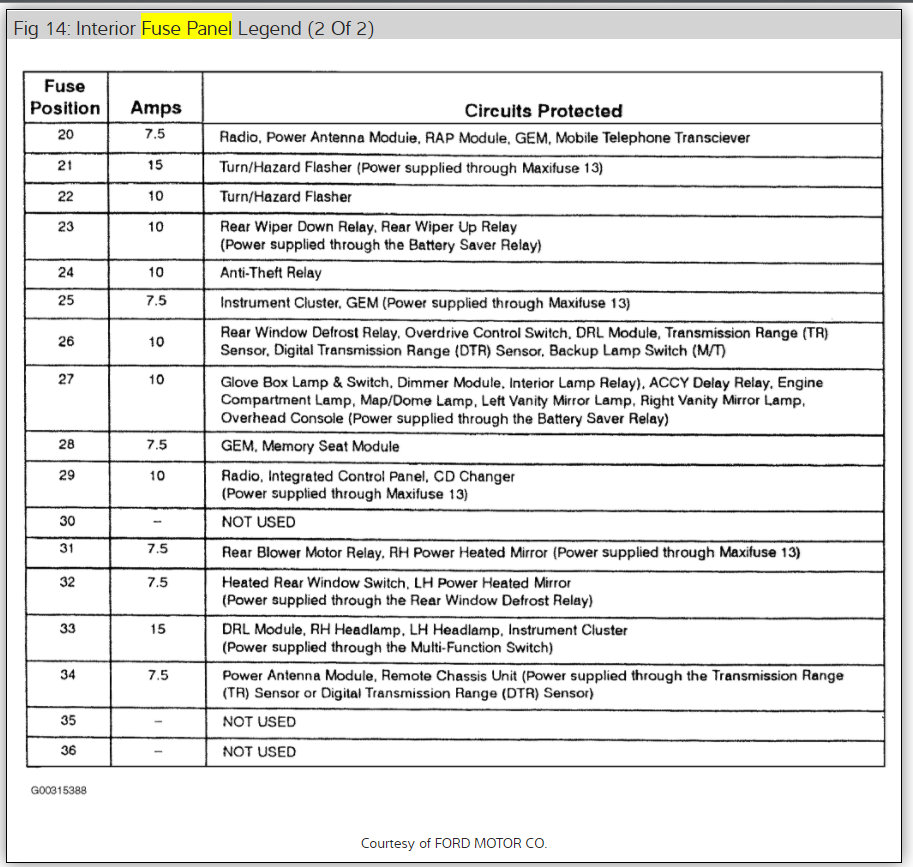

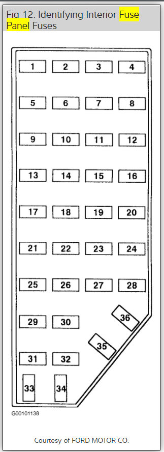

Can you see if you have power at fuse # 1 and 6 ? Here is a guide to help and the fuse location with the wiring diagrams for the door locks so you can see how the system works:
