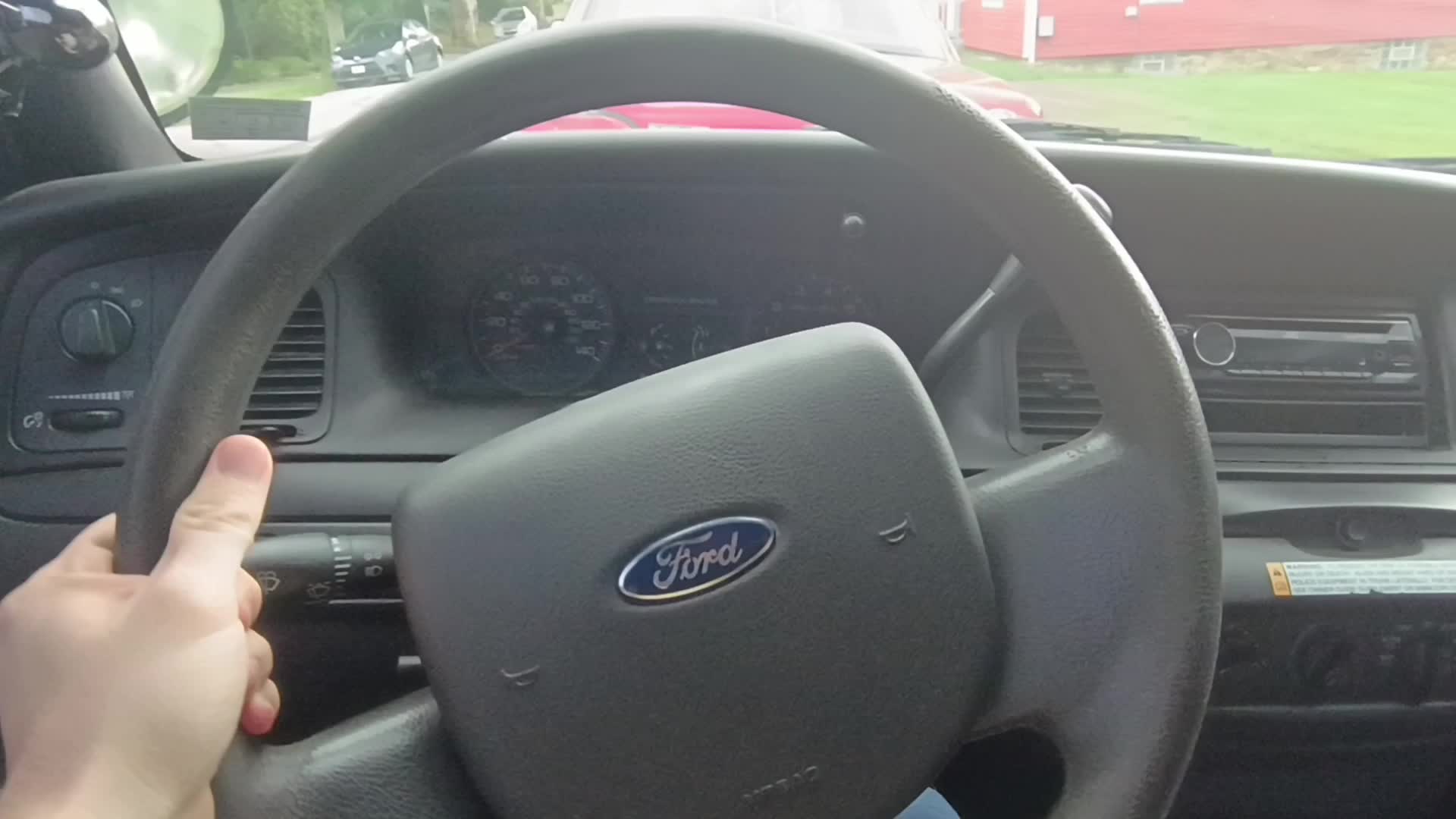

I have a 2011 Ford Crown Victoria Police Interceptor that has it's steering wheel crooked about 15 degrees to the left. I have had the whole front end suspension replaced along with 2 alignments from different shops. If I let go of the wheel while the car is driving, it drives straight but the wheel misaligns itself. If I take a sharp left the wheel becomes more crooked (about 20 degrees to the left) but a sharp left results in it nearly straitening itself out (only being about 5 degrees to the left).
If I have the wheels straight and I turn to the left while at a stop, there is a very faint vibration. No such vibration exists when turning right.
Another detail that might be important is that when the key is out of the ignition, the wheel will not lock itself when turned to the left. However, it will still lock when turned to the right. I will attach a video of this.
I have owned the car for almost a year and it has always had this issue but just assumed it just needed an alignment. It has never had the other symptoms of a bad alignment like pulling or worn tire tread.
I spoke to my mechanic about this and he suspects a bad U joint but has to remove the steering column to be sure. I just wanted to see if I could get a second opinion or find more information to provide to my mechanic to see if I could narrow this down anymore.
Thank you in advance.

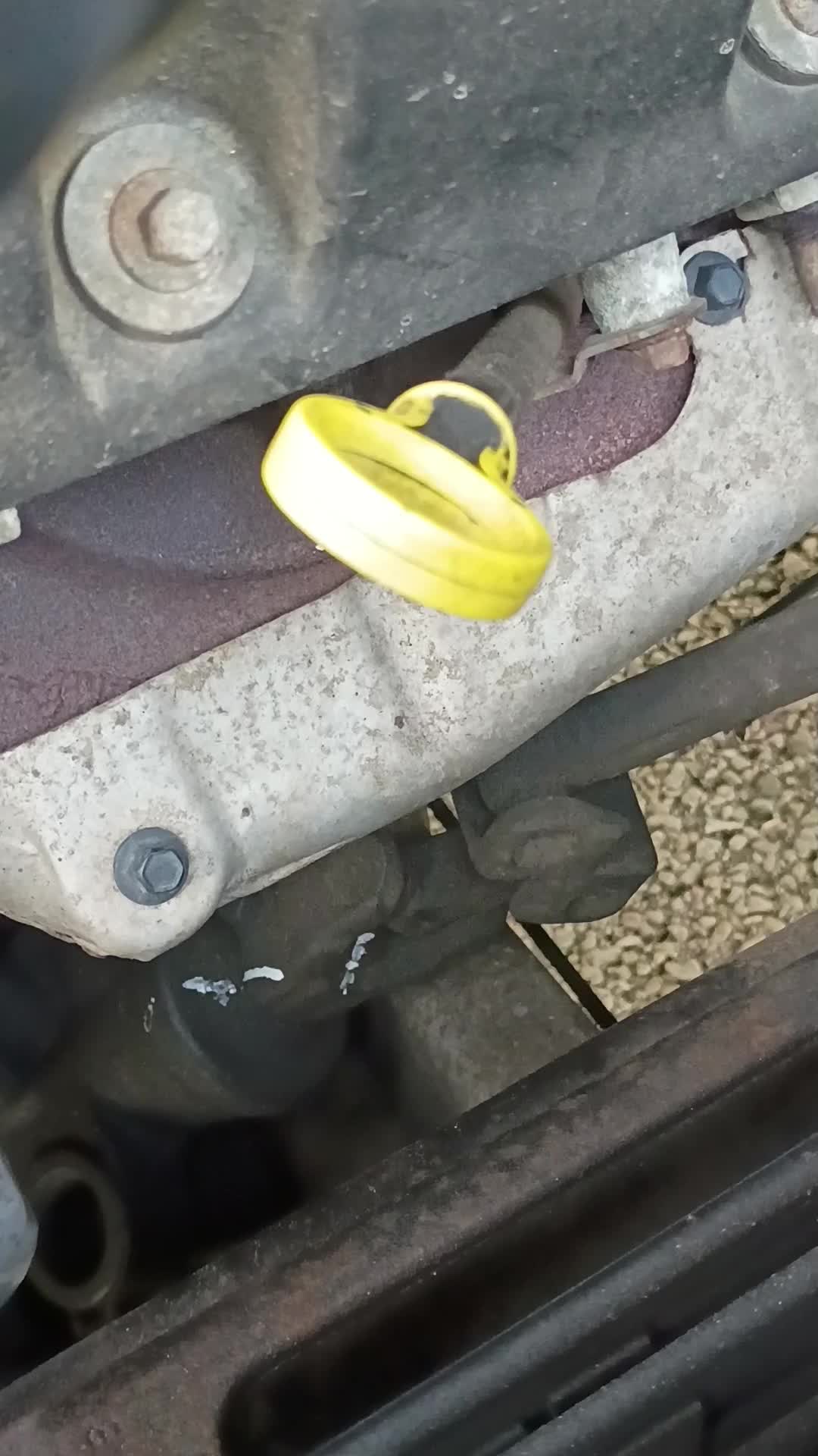

As moving the wheel also changes the angle I suspect it's either the U-Joint(s) in the shaft or the steering shaft itself. They are made to collapse in an accident so are generally made of two telescoping parts that they inject plastic between to lock them in place. I have seen the plastic fail for various reasons and it lets the wheel move because the upper shaft can move slightly from the lower. The parts circled in the image can all cause the issue you are having. The under hood parts (lower 2 items) can be checked using a grease or paint marker. You would turn the wheel to the steering stop turning right. Now with it held lightly there, draw a straight line across the pieces in the two joints. Now turn it to the left stop. Did the marks go out of alignment? If yes you found at least part of the problem, the other flex is in the column around the bottom of the dash and is what allows the column to tilt. It could be the problem if neither of the other two show movement.

Thank you so much for your detailed response and diagram. I've inspected under the hood and I think I've been able to trace the abnormality. I found play where the lower steering shaft connects to the rack. I'm attaching a video to see what you think of it.

That would cause play in the steering for sure. The question now is it the shaft in the rack or is it the steering coupler on the shaft (item 4 in the picture) That shaft is normally round with a flat on it and the bolt goes across the flat and squeezes the coupler onto the steering rack shaft. I would start with the lower shaft. Set the steering wheel straight and try tightening the bolt that clamps the If it has gotten loose it could be the cause. However I would also check to see if the shaft from the rack is moving with the shaft, if it is then the play is inside the steering rack and replacement of the rack would be the solution. I cannot tell if that is the upper chalk mark showing the inner shaft moving? If yes then the rack needs to be replaced. Depending on this cars past life it could just be wear from use.

It's difficult to tell but it definitely seems to be moving with the coupling. Not ideal but it's not the worst thing to have to replace. I'm just happy to have what seems like a conclusive answer. Now I guess the issue now is trying to find a rack. Do you think it's best to get a remanufactured one or to grab one from a junk yard? I'd like to stay away from 3rd party parts as I worry about their quality.
