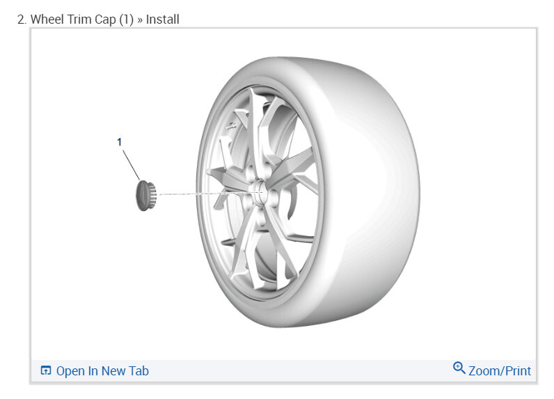

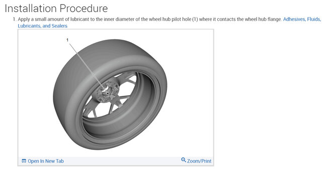

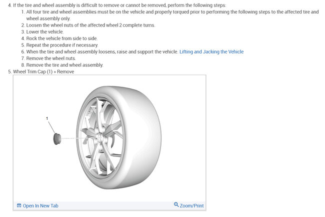

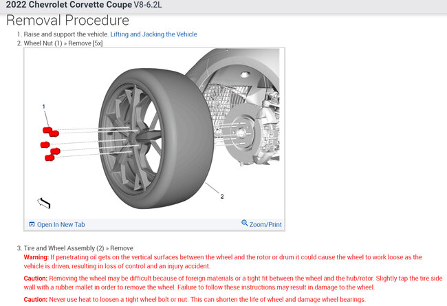

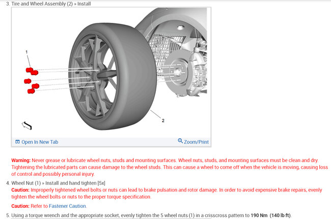

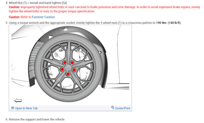

Did you need to remove the rear wheels when doing the job? I would go over the lug nuts. I have included the torque specs and instruction on how to properly install the wheels. You will need a torque wrench. Check out the images (below). Let us know what happens and please upload pictures or videos of the problem so we can see what's going on.
