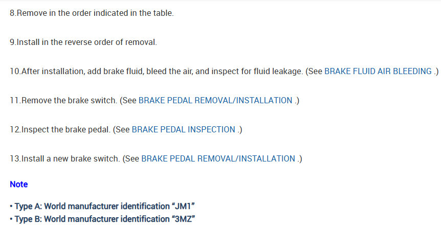

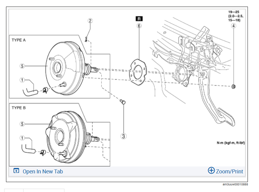

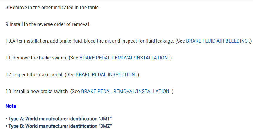

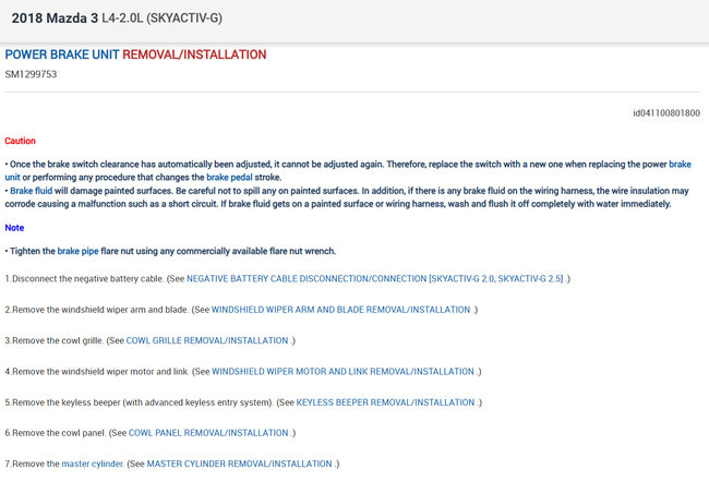

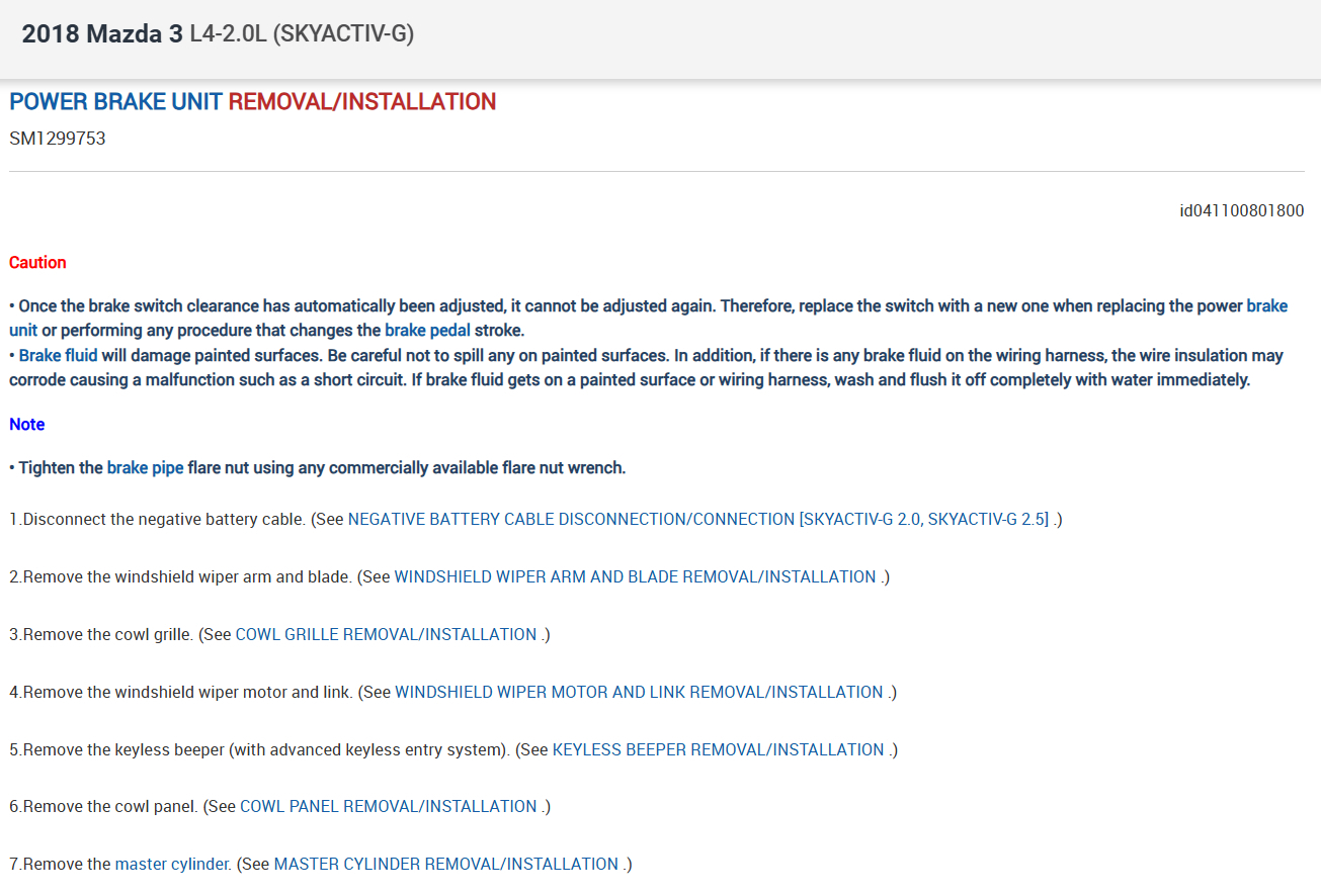

It sounds like the brake booster had gone bad, here is how to change it out to help fix the problem. Check out the images (below). Please upload pictures or videos in your response of any problems so we can see what to help you with.
