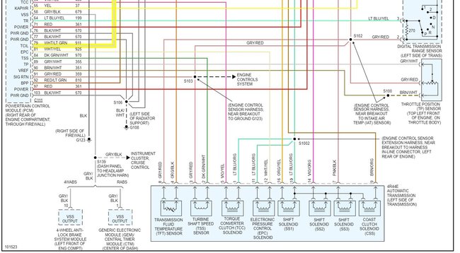

Is there a pair of wires on the multi-pin connector going to the transfer case that carry a speed signal of some sort?
1999 FORD RANGER
100,000 MILES • V6 • 4WD • AUTOMATIC
JOSHUA L RICE
Bought the truck listed above no reverse (automatic). Build date 9/99. Titled 2000. Included with purchase was salvage yard (newer than 1999) auto transmission. I installed it without noticing the newer transmission has no two-wire connector on the back top driver's side. The truck wiring harness has two pin connector. I didn't think much because I guessed it was speedometer only. Wrong.
It affects the overdrive light now flashing.
Here's my question:
Is there a pair of wires on the multi-pin connector going to the transfer case that carry a speed signal of some sort? I can parallel feed to the two-pin connector to let it see some kind of shaft speed.
Mar 12, 2022 at 1:45 PM

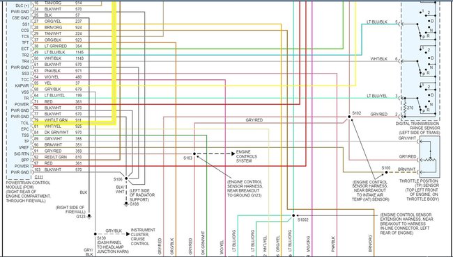

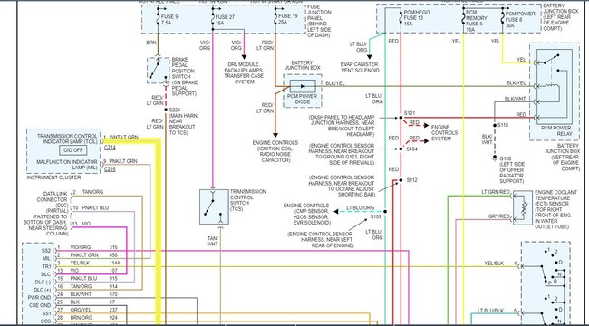

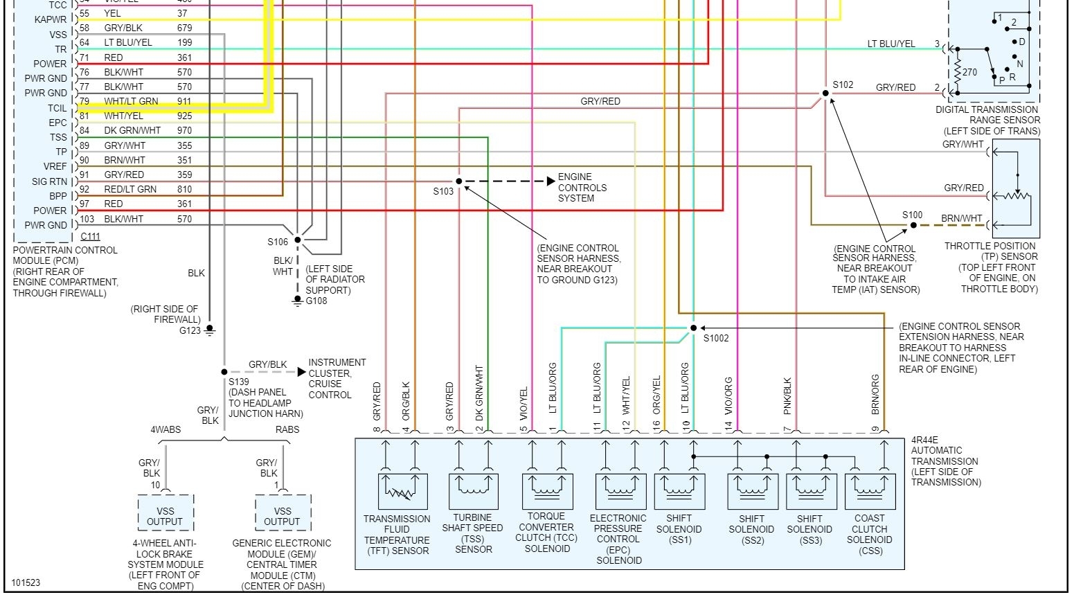

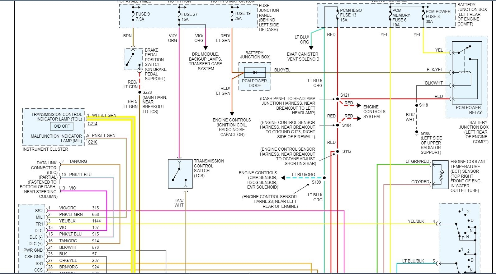

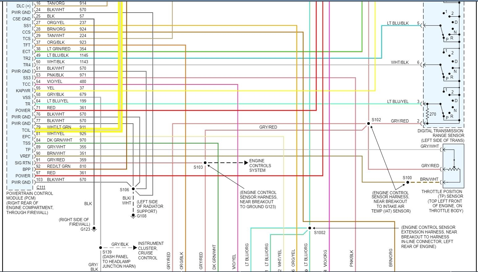

Good morning,
Can you tell me the color wires for the 2-wire connector?
I attached the wiring diagram for you for the 1999. 2000 is identical.
The only difference is the PCM. If you give me the colors, I will trace them out.
The simple answer to the other feed is no. If that were the case, the factory would have used it that way.
