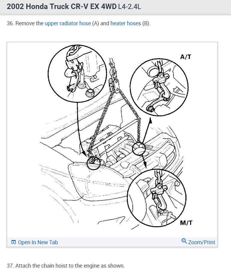

At a complete stop there is a creaking noise. When the brake is let off or when putting transmission to park it is gone. Sometimes the sound comes at 60 mph.

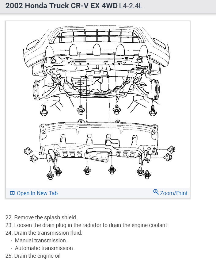

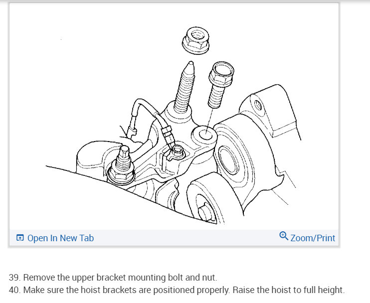

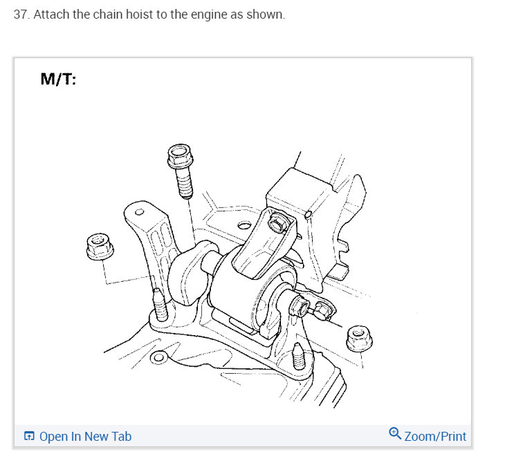

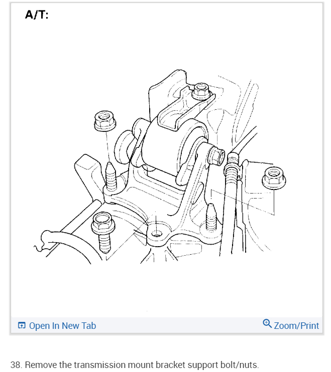

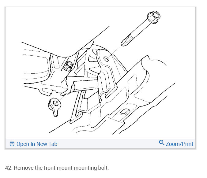

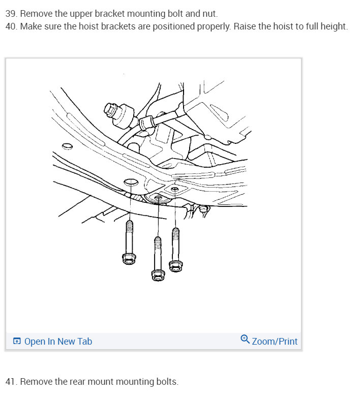

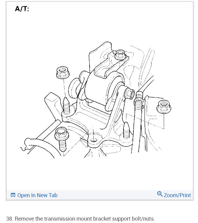

Thanks for the video it really helps. This sounds like you have an engine mount that needs to be replaced. here are diagrams and instructions to help do the job. You can get a full set from Rockauto or Amazon. Check out the diagrams (below). Please let us know what happens.
