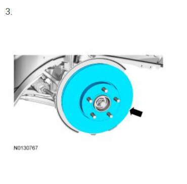

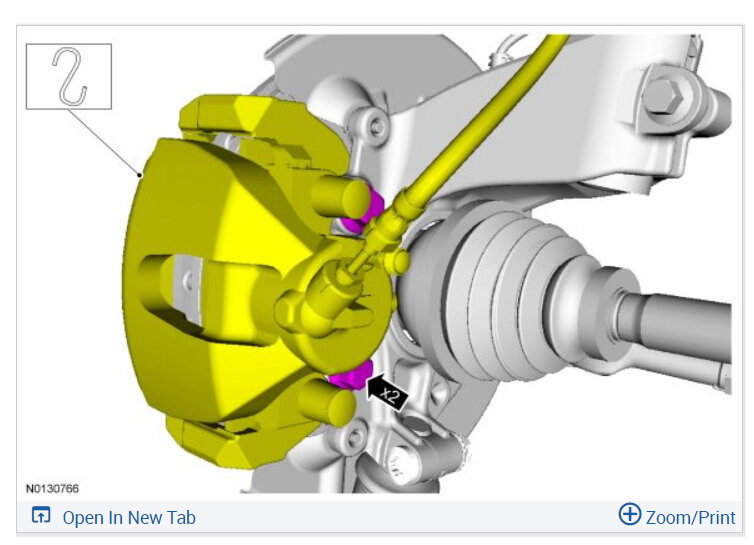

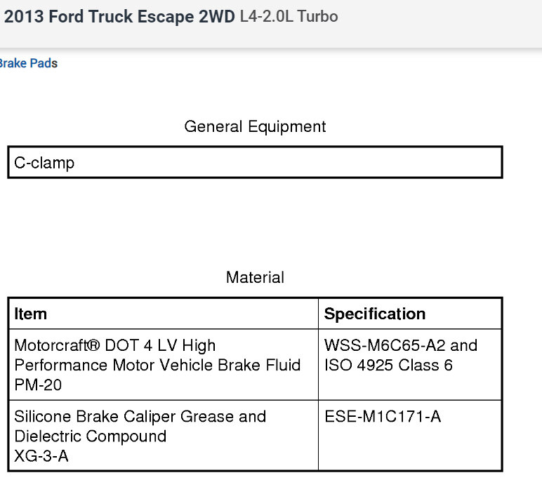

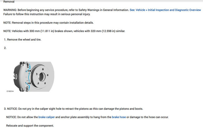

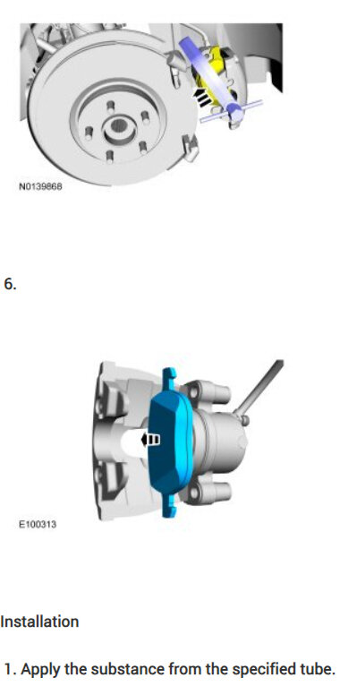

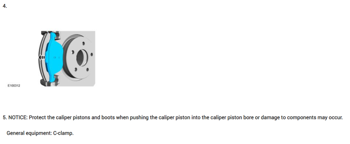

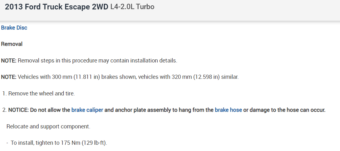

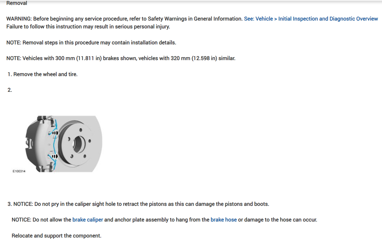

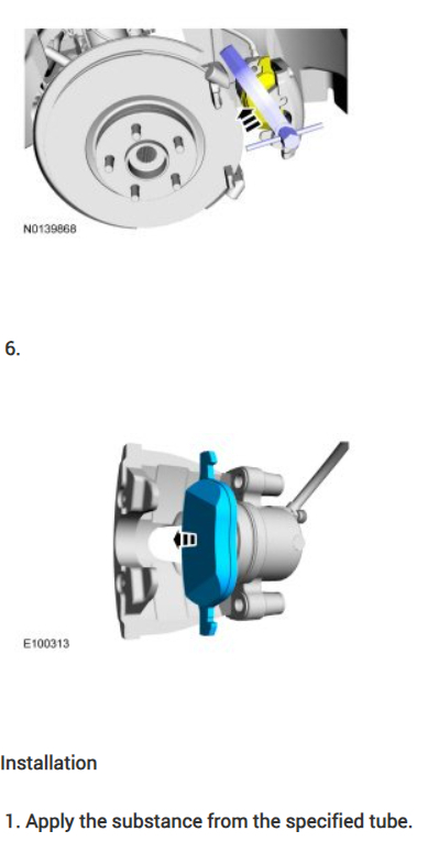

Yes, if the brake pads are worn, they will not release correctly. To be sure, can you please shoot a quick video with your phone so I can hear the noise? That way I can tell for sure what's going on. Here is how to replace the front brakes so you can see what needs to be done:
This video should help with instructions below for your car:
https://youtu.be/dlIUJOYnYQc?si=EdqdsZBZJefQ6-0j
Check out the images (below). Let us know how it goes.
