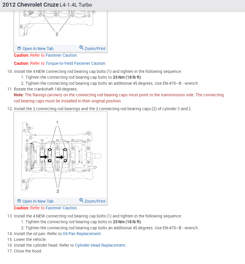

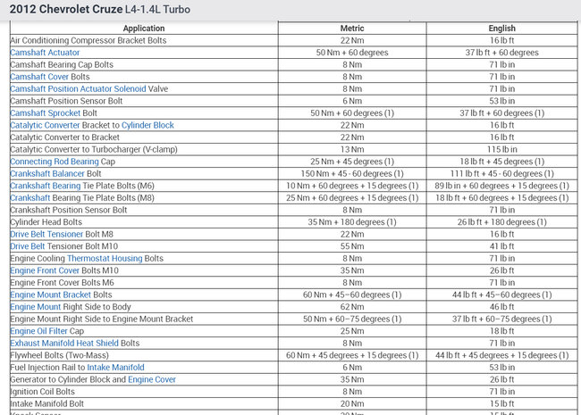

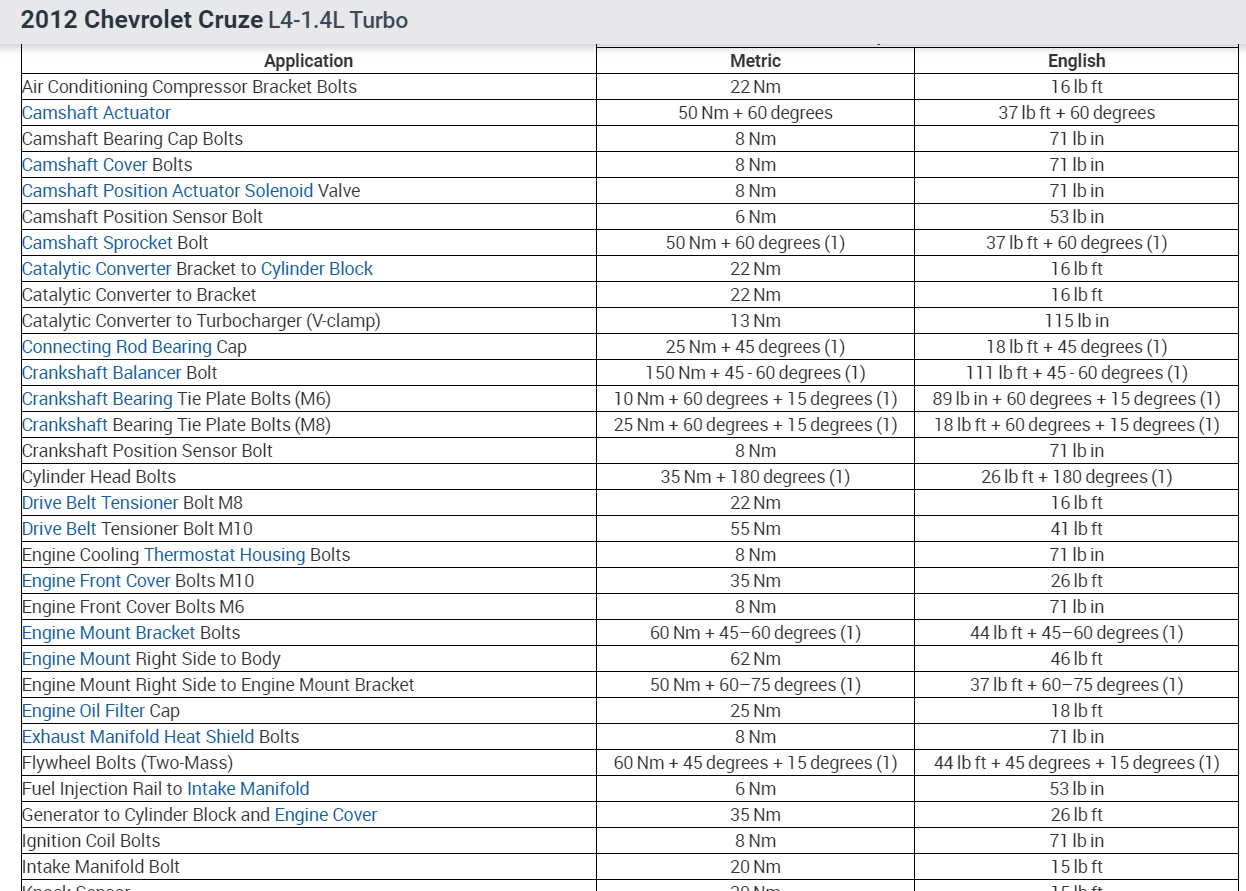

I’ve been looking everywhere for the torque specs for the main caps on my car.
May 17, 2022 at 4:38 PM
SQM
  • 6,383 POSTS

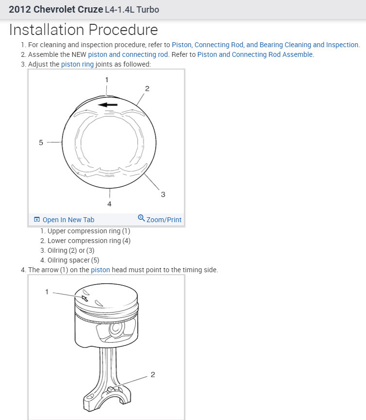

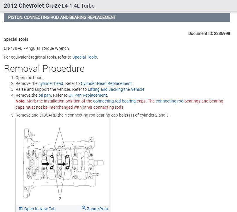

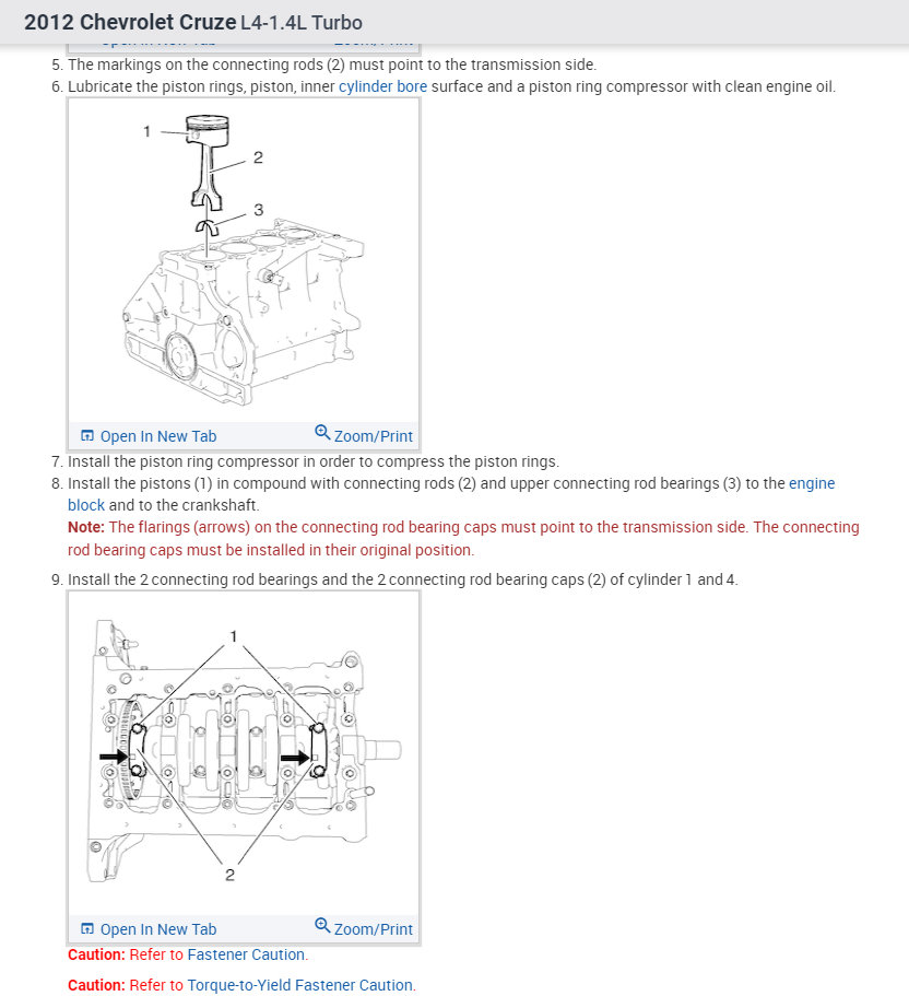

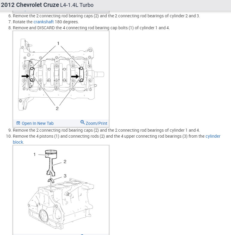

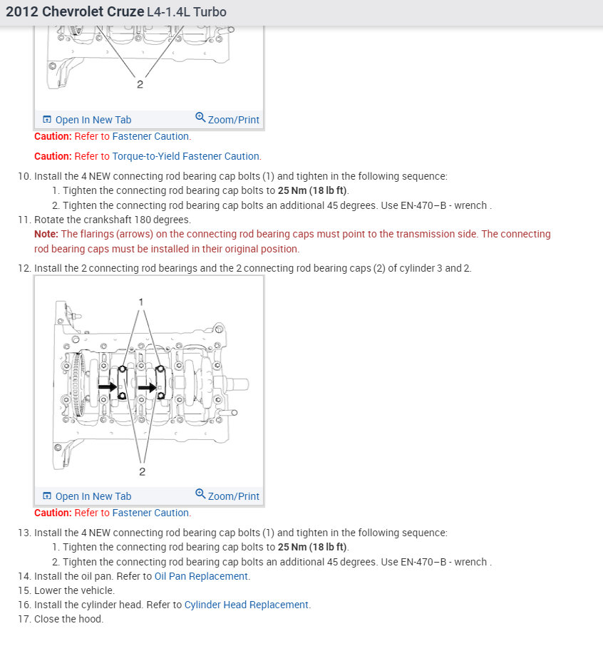

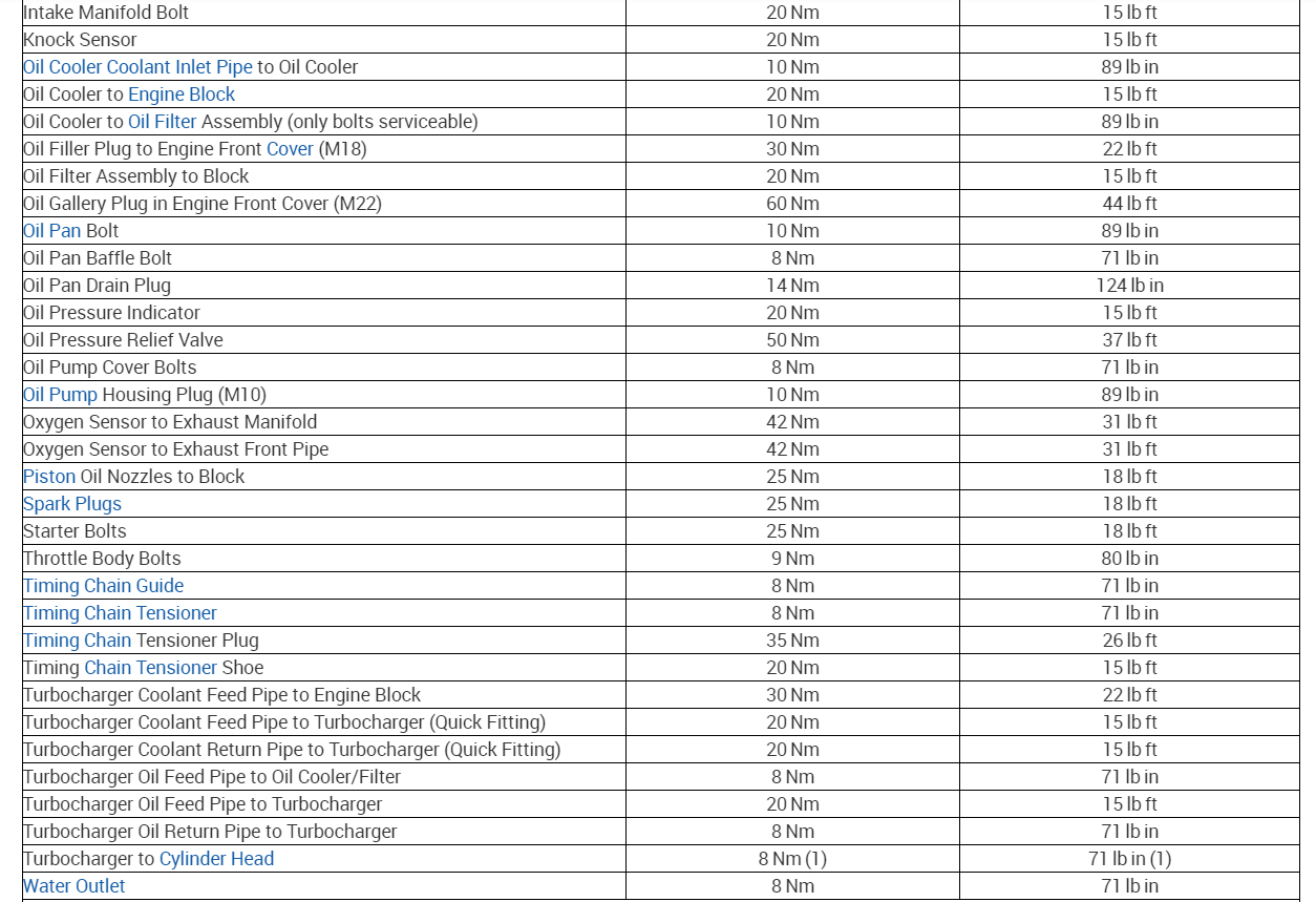

The connection rod bearing caps are torqued at 18 lb. ft
I have attached the procedure below for your reference.
Let me know of any questions. Check out the images (below). Let us know if you need anything else.
