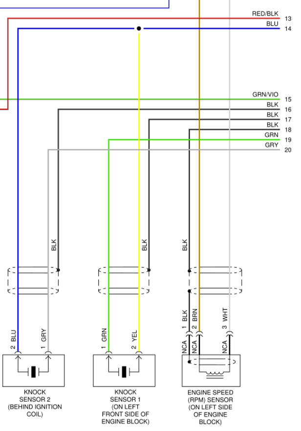

Okay, so here's what happened: the harness side coming from car side of harness to crankshaft sensor is messed up. I'm not even sure where or how far back it goes but it looks like it's going to be hard to trace. so, i wanted to just use butt connectors and crimp the wire, but I'm noticing some foil looking sheathing or wrap. I'm wondering what that is and how important it is. It's so fragile and thin it just keeps breaking apart. And i can't tell if I'm seeing some sort of green very thin wire or not. what's this for? And how important is it to be connected for the sensor to work? Can i get away with just connecting the 3 main wires? And if it's needed is there anything i could use in that area to substitute? I have foil HVAC tape or aluminum foil as options but I'm not sure if that's a good idea. would appreciate some clarification on this. thanks

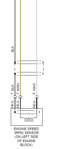

The thin foil you see is the shielding around the main wires to stop outside interference.
It is important to retain this as without the foil the ECU will receive a false signal and most like will not be able to start the engine.
You can splice in another part of harness, but I would suggest using a part of used engine harness which has the screening pre-installed. Any 3-core screened wire of appropriate length will do. The unscreened end splices should be kept as short as possible.
Please see the image below for the engine speed sensor pin out.

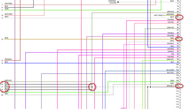

The black wire on pin 1 shares the ground at ECU pin 108 with both knock sensors.
See image 2 and 3.
Hope this helps.
Cheers, Boris

Thanks for your response. would foil Matic tape be the same thing as a substitute? Or not? I'm thinking it may not work because i know foil conducts i think, right? Wouldn't that be doing the opposite? If so, that's a big no am i correct in thinking? Or would it work I've been trying to find some shielded cable somewhere but guess i may have to order some if there is nothing i can use in place of of the foil is so thin it breaks up and falls apart super easy.

Normal foil tape will not work. It would be best to order some shielded 3 core wire.

Okay, is there a drain wire outside insulation on this harness or no?

Looking at the wiring diagram there is no external drain wire. The black wire joins in the loom with the 2 other black wires from the knock sensors on to brown/blue wire to pin 108.
