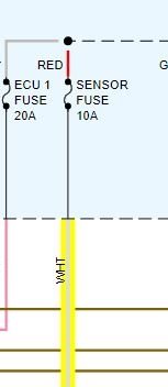

The three wires should be white, brown, and blue. White should have 12 volts from the fuse panel in the engine compartment. The brown is ground and blue signal.

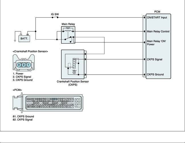

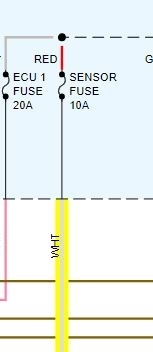

Based on your description, it sounds like the plug itself is bad an causing a short across all three wires. If you remove fuse the sensor fuse under the hood (see picture 3) does the power go away?
Since the pins at the ECM seem good when things are disconnected, I really questions the harness to the sensor as well as the plug. Check continuity in each wire. In other words, disconnect both sides and see if there is resistance in each wire. Move them around to see if there is a possible short.

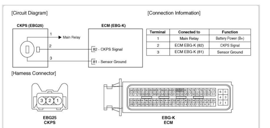

Let me know. I attached schematic pictures in case you needed them. I highlighted the wires in question.

Pin 1 is 12 volts in to the sensor, pin 3 is sensor ground through the ECM. With the crank sensor plugged in pin 3 should be grounded with the key on. Pin 2 is signal to the ECM, should be ac voltage while cranking.
it sounds like the plug at the crank sensor may be bad and shunting voltage to all three wires. You should have ground on pin 3 however from the ECM.
