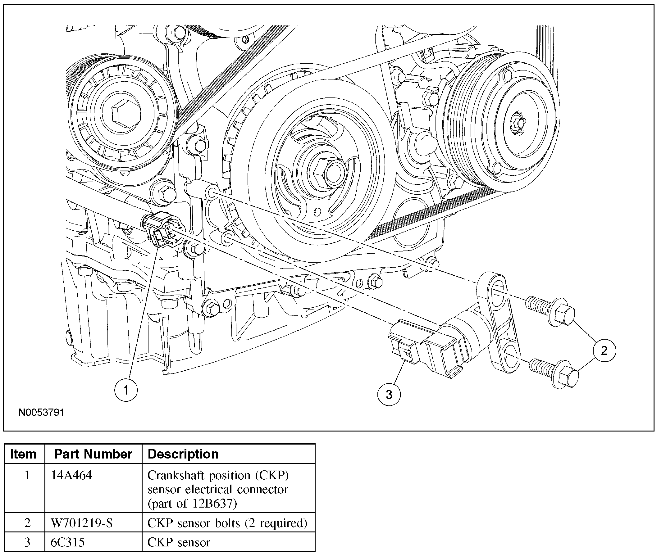

When I went to buy a new crank sensor, it mentions an alignment tool only sold from Ford I will need. But in your video on this I did not see you mention anything about it. I have read on online forums guys taking it off and replacing it then the car will not start. As this is my only mode of transportation I have been driving with it like this for awhile because I simply know nothing about adjustment of timing. I was wondering if you can explain what I may need to do in order to replace this. Thanks, Garrett
Nov 30, 2018 at 9:07 PM
  • 110,194 POSTS

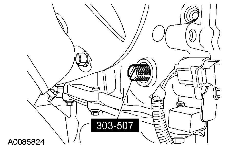

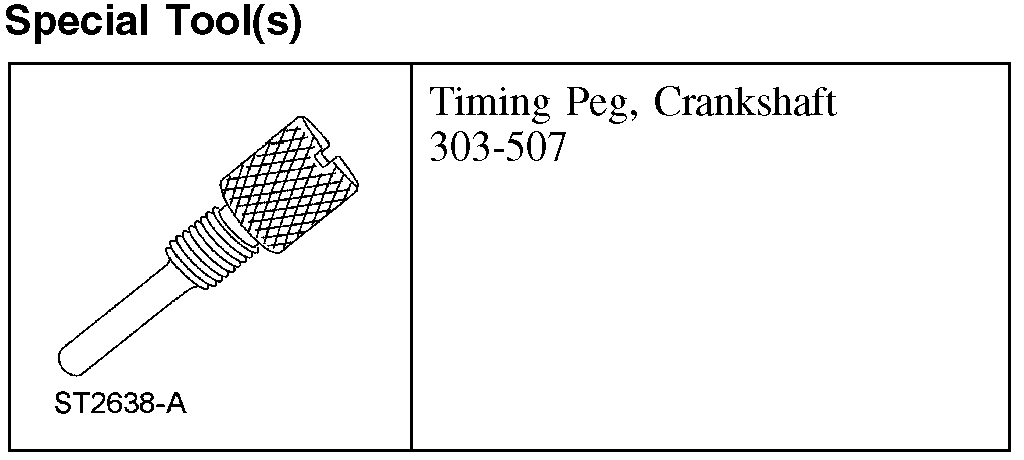

First, there are a couple things you will need on this vehicle. There is a plug on the side of the engine block where you will install a timing peg tool.
Basically, you place the vehicle at top dead center and install the peg to prevent the engine from turning. Next, there is an alignment tool that is used when installing the sensor. However, there is not even a tool or part number for the alignment tool. Normally, they come with the new sensor. At least that is what I have experienced as well as the manual's directions indicate. If you order an aftermarket sensor, check. If there is not one, this may be one of them times you have to go to a dealer for the part. These directions indicate the alignment tool is not available separately. Therefore, any sensor you purchase should have one. Regardless, here are the directions specific to your vehicle for this process. The attached pictures correlate with these directions. One last thing. You listed this as a 2.0. That is not an option, so I went with the 2.3 since you said four cylinder. If that is not correct, you have to let me know.

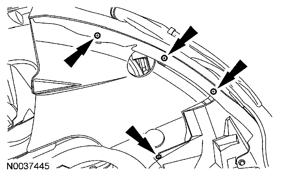

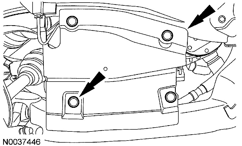

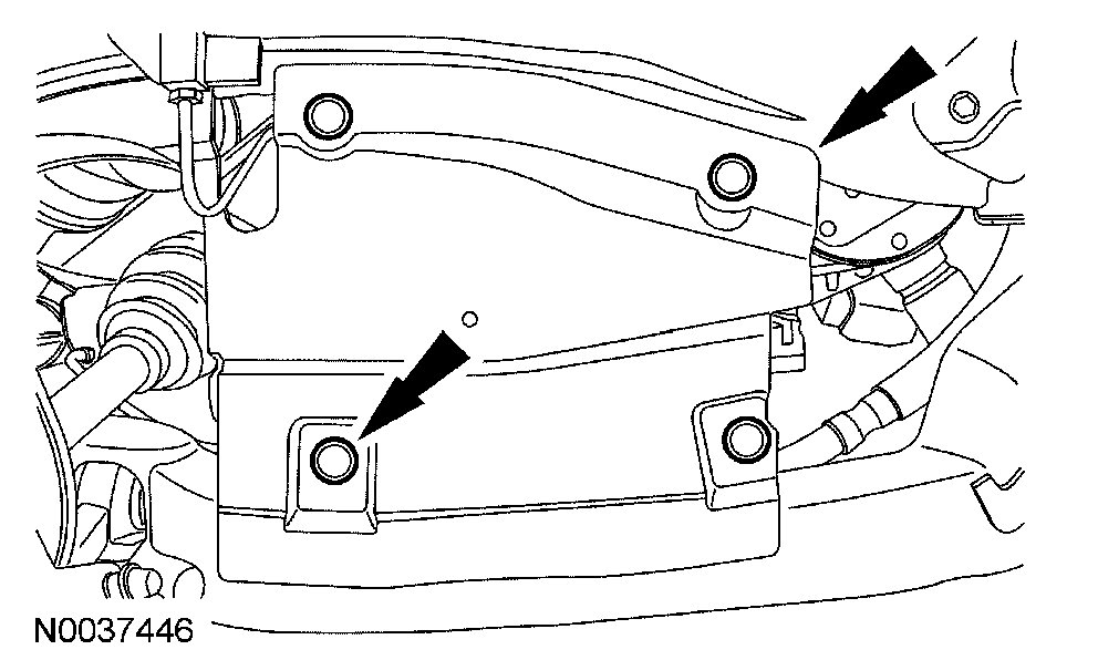

2. Remove the 4 screws and position the RH fender splash shield aside.

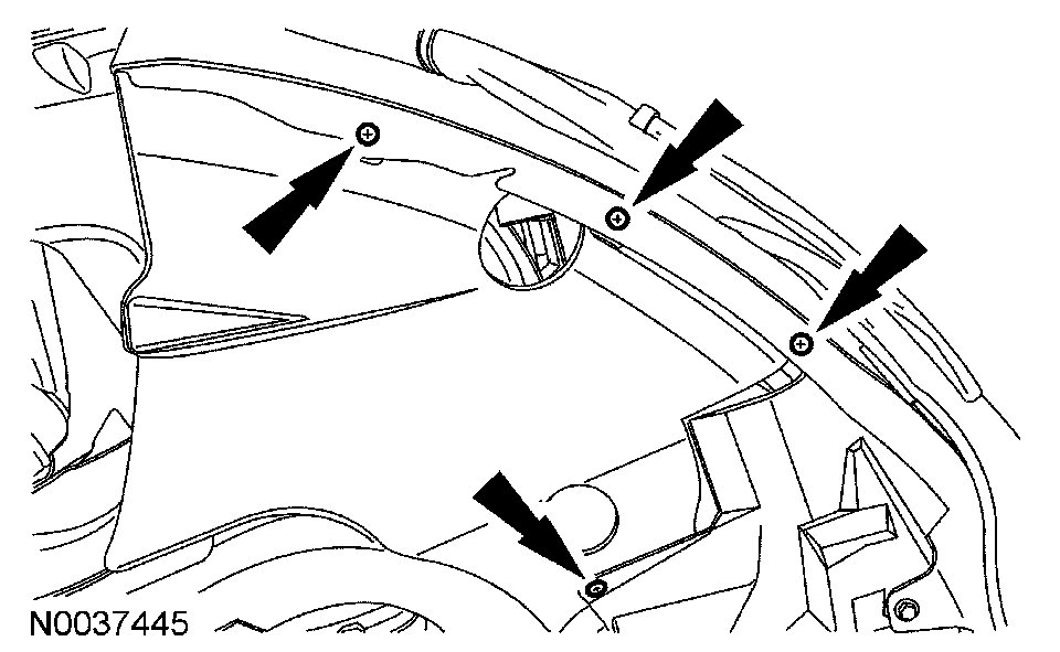

3. Remove the 6 pin-type retainers (4 shown) and the RH splash shield.

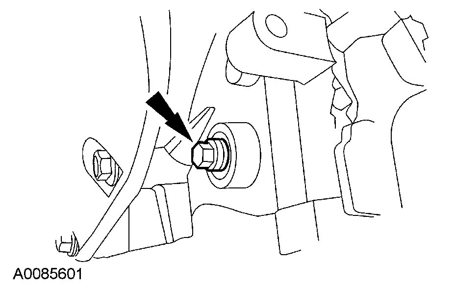

4. Remove the cylinder block plug.
5. Turn the crankshaft pulley bolt to position the No. 1 cylinder at top dead center (TDC) and install the special tool.

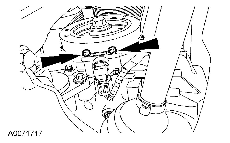

6. Disconnect the crankshaft position (CKP) sensor electrical connector.
7. Remove the bolts and discard the CKP sensor.

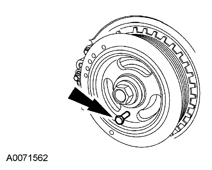

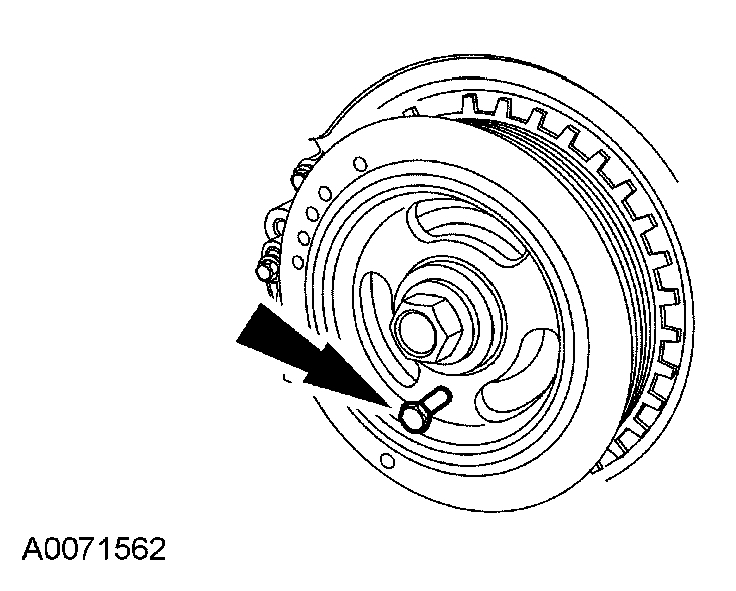

1. CAUTION: Only hand-tighten the bolt or damage to the front cover can occur.
Install a 6 mm (0.23 in) x 18 mm (0.7 in) standard bolt in the crankshaft pulley.

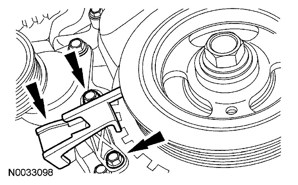

2. NOTE: Whenever the crankshaft position (CKP) sensor is removed, a new one must be installed using the alignment tool supplied with the new part.
Install the CKP sensor and the 2 bolts.
- Do not tighten the bolts at this time.
3. NOTE: The CKP sensor alignment tool is supplied with the new sensor and is not available separately.
Adjust the CKP sensor with the alignment tool.
- Tighten the 2 CKP bolts to 7 Nm (62 lb-in).
4. Connect the CKP sensor electrical connector.
5. Remove the 6 mm (0.23 in) bolt from the crankshaft pulley.
6. Install the cylinder block plug.
- Tighten to 20 Nm (15 lb-ft).

Also, how do I find TDC for cylinder 1?
Nov 30, 2018 at 10:20 PM
  • 110,194 POSTS
Welcome back.
You are correct. I looked up a Fusion. Ugh. Getting tired. However, yes its the same. As far as TDC, install the Crankshaft TDC Timing Peg and rotate the crankshaft slowly clockwise until the crankshaft balance weight is up against the Crankshaft TDC Timing Peg. The engine is now at Top Dead Center (TDC). Only finger tight with the tool.
