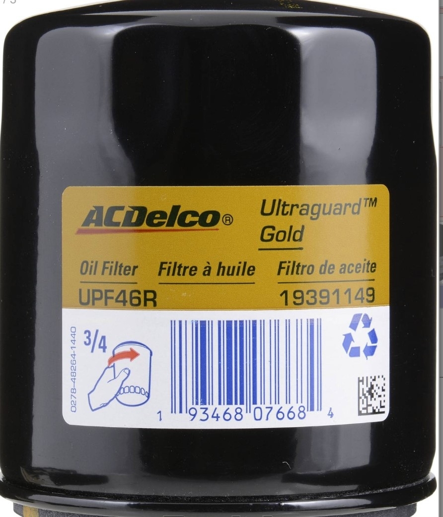

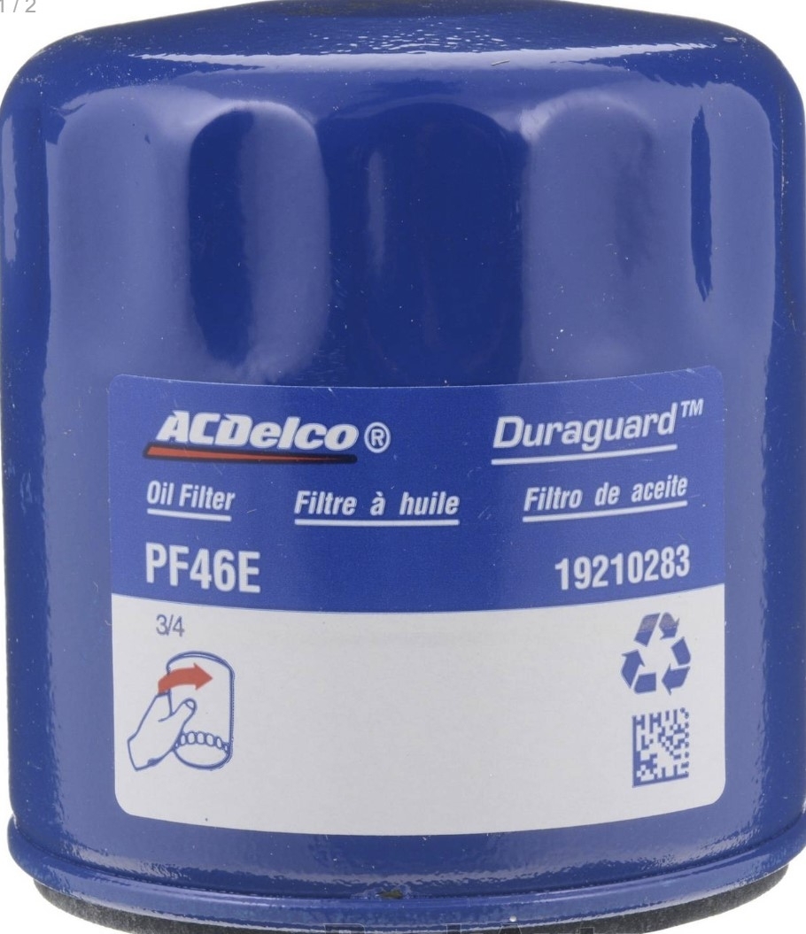

My suggestion is to start with the oil itself. I would change the oil and the filter. I use Castrol High Mileage 5w30 in my 6.0 LQ9 and it's at 228k, I am at about 40 psi at idle. Mobil 1 5w30 is good too and cheaper but both meet the oil standards set by GM so I would stick with one or the other. Use a good filter too, K&N or Fram or AC Delco are good options. I think this is a good place to start so at the very least we can rule it out as a possibility. Your vehicle takes 6 quarts.
