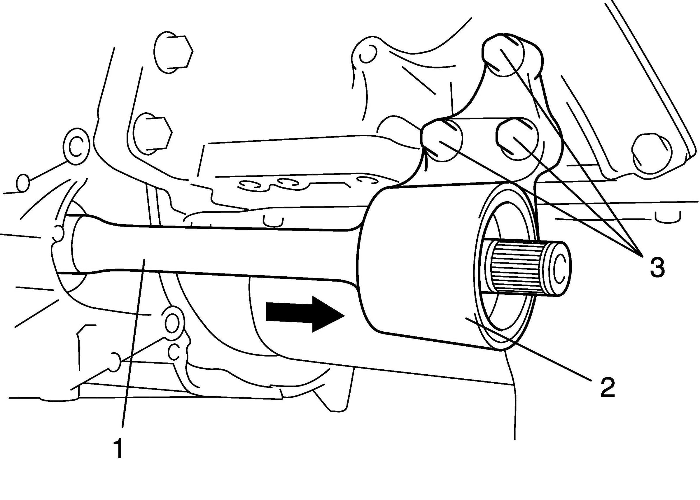

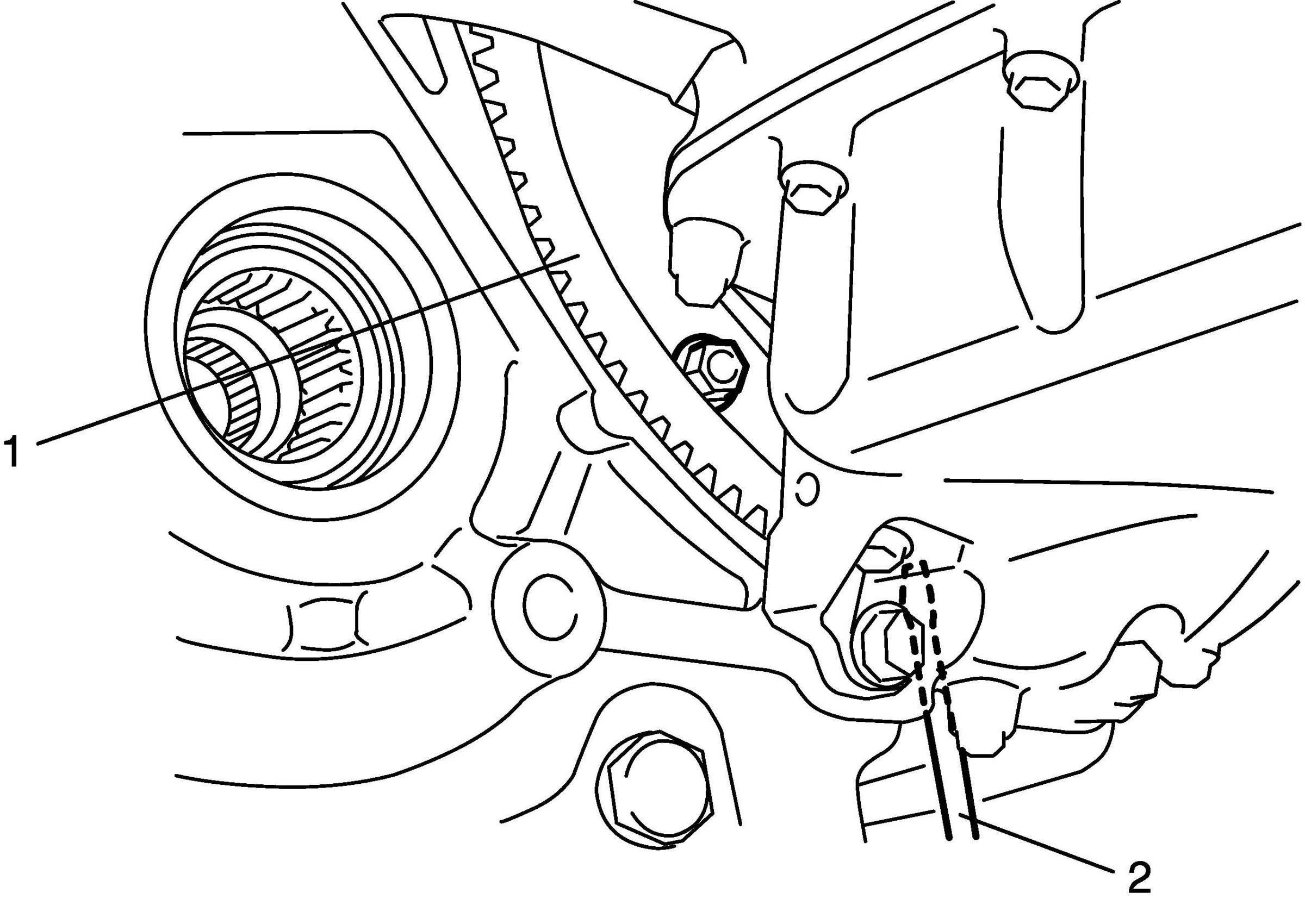

I was driving the car all of a sudden the car just stopped was not able to start crank. car will not start or crank. had it scanned and got the code p0335 crankshaft sensor. I would like to know the location of the crank shaft sensor if possible.
Jul 29, 2019 at 12:16 PM
  • 110,240 POSTS
Welcome to 2CarPros.

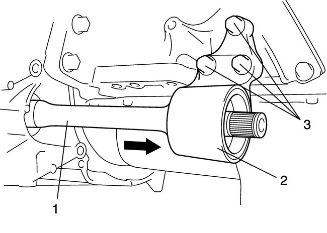

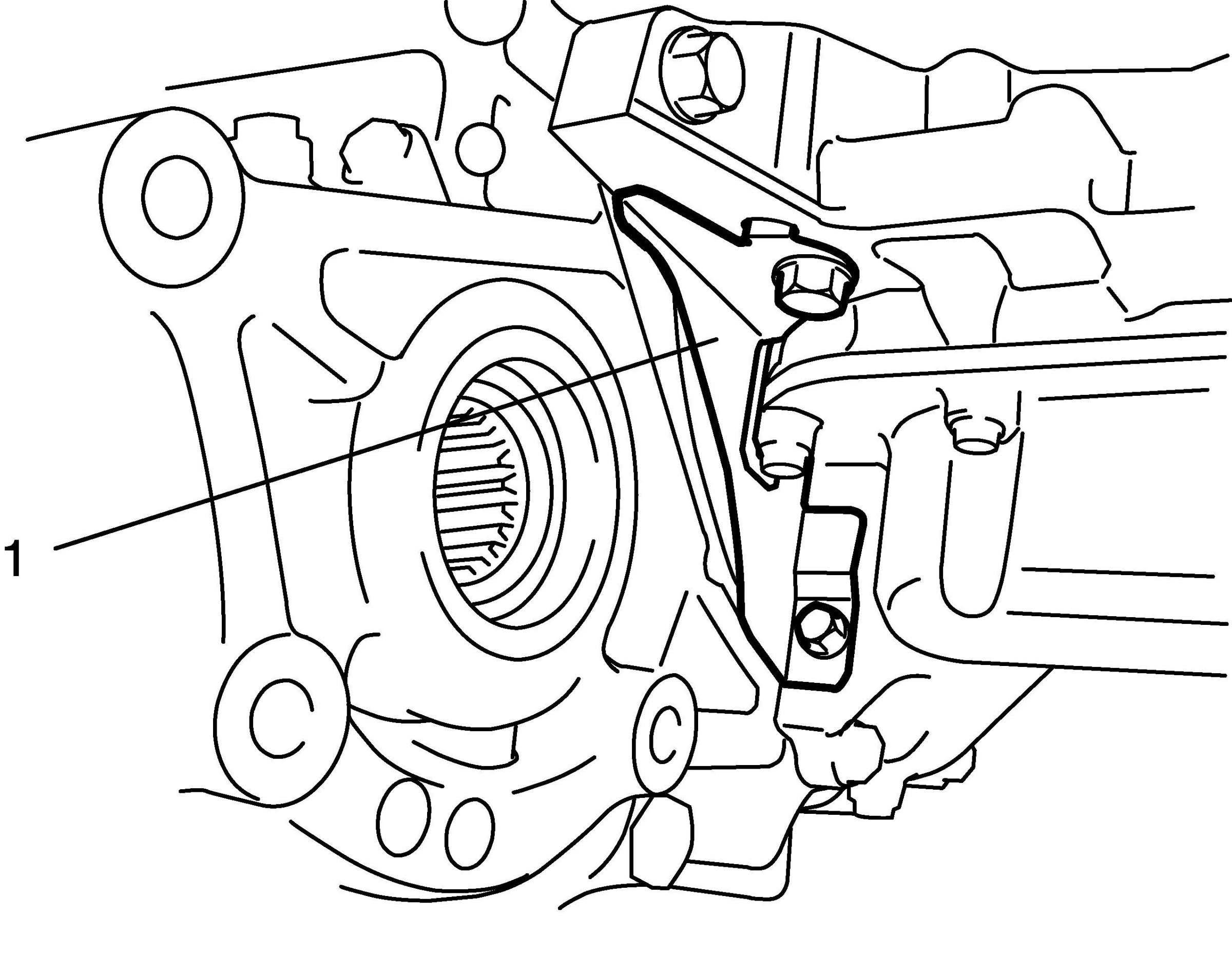

If you look at picture 1, it shows location of the sensor. Here are the directions for replacement. Picture 2 correlates with the directions. I hate to say this, but the first thing indicated in the directions is to remove the transmission
_______________________
2007 Suzuki SX4 4WD L4-2.0L
Crankshaft Position (CKP) Sensor Removal and Installation
Vehicle Powertrain Management Sensors and Switches - Powertrain Management Sensors and Switches
CRANKSHAFT POSITION (CKP) SENSOR REMOVAL AND INSTALLATION
Removal
1. Remove transmission assembly from vehicle referring to Automatic Transaxle Unit Dismounting and Remounting or Manual Transaxle Assembly Disassembly and Reassembly.
2. Remove drive plate or flywheel from crankshaft.

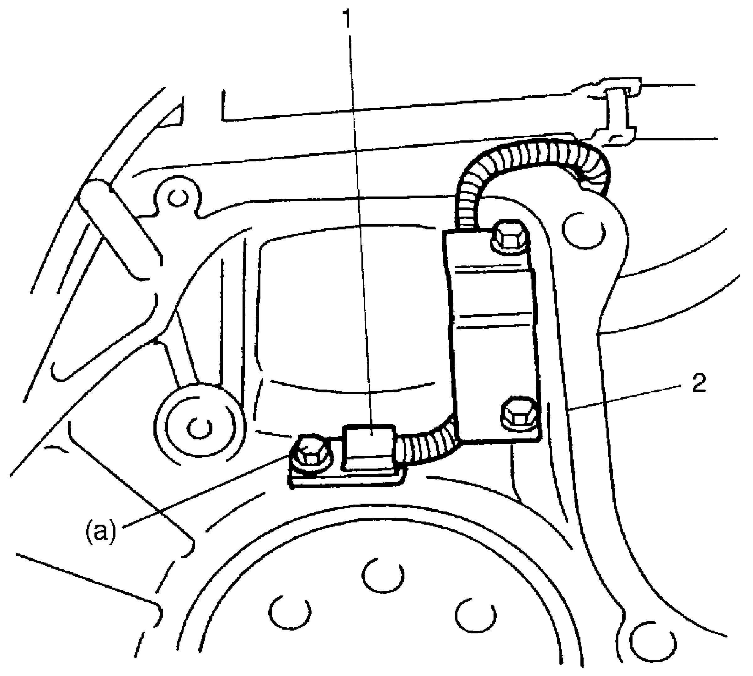

3. Disconnect connector from crankshaft position sensor.
4. Remove CKP sensor (1) from cylinder block (2).
Installation
Reverse removal procedure noting the following.
^ Apply engine oil to O-ring of sensor.
^ Tighten CKP sensor bolt to specified torque.
Tightening torque
CKP sensor bolt a: 11 Nm (1.1 kg.m, 8.0 ft. lbs.)
^ Connect connector and fix wire harness with clamp securely.
Here are the directions to access the sensor. I have no idea why they put these things in hidden places. Normally it takes about 30 minutes to replace a crank sensor. This one is a major undertaking. It calls for 6.4 hours labor.

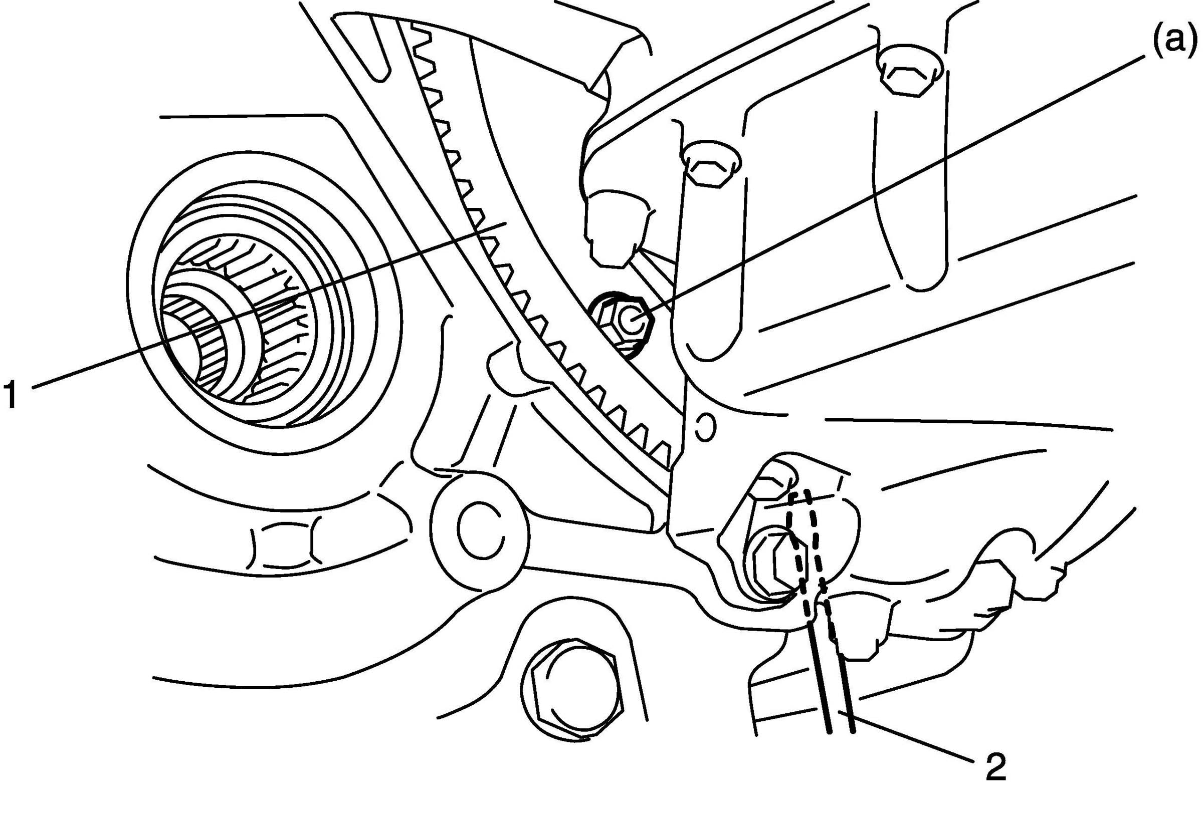

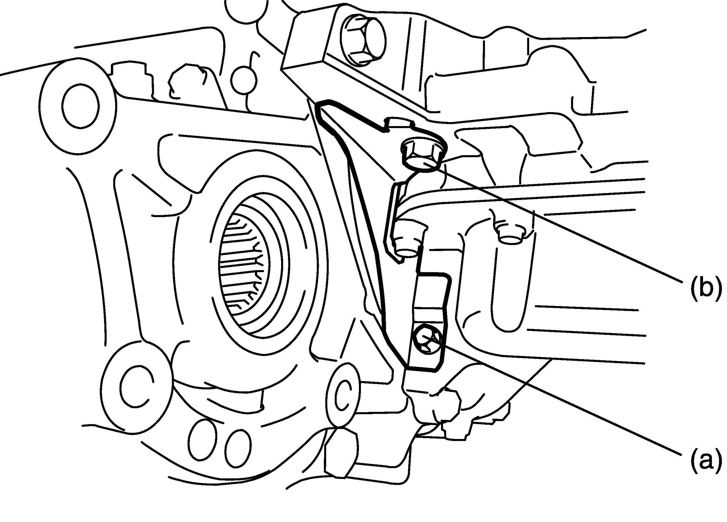

4. Remove center bearing support bolts (3) and remove center bearing support (2) with center shaft (1) from differential side gear (for 2WD vehicle).
pic 3

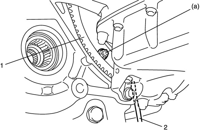

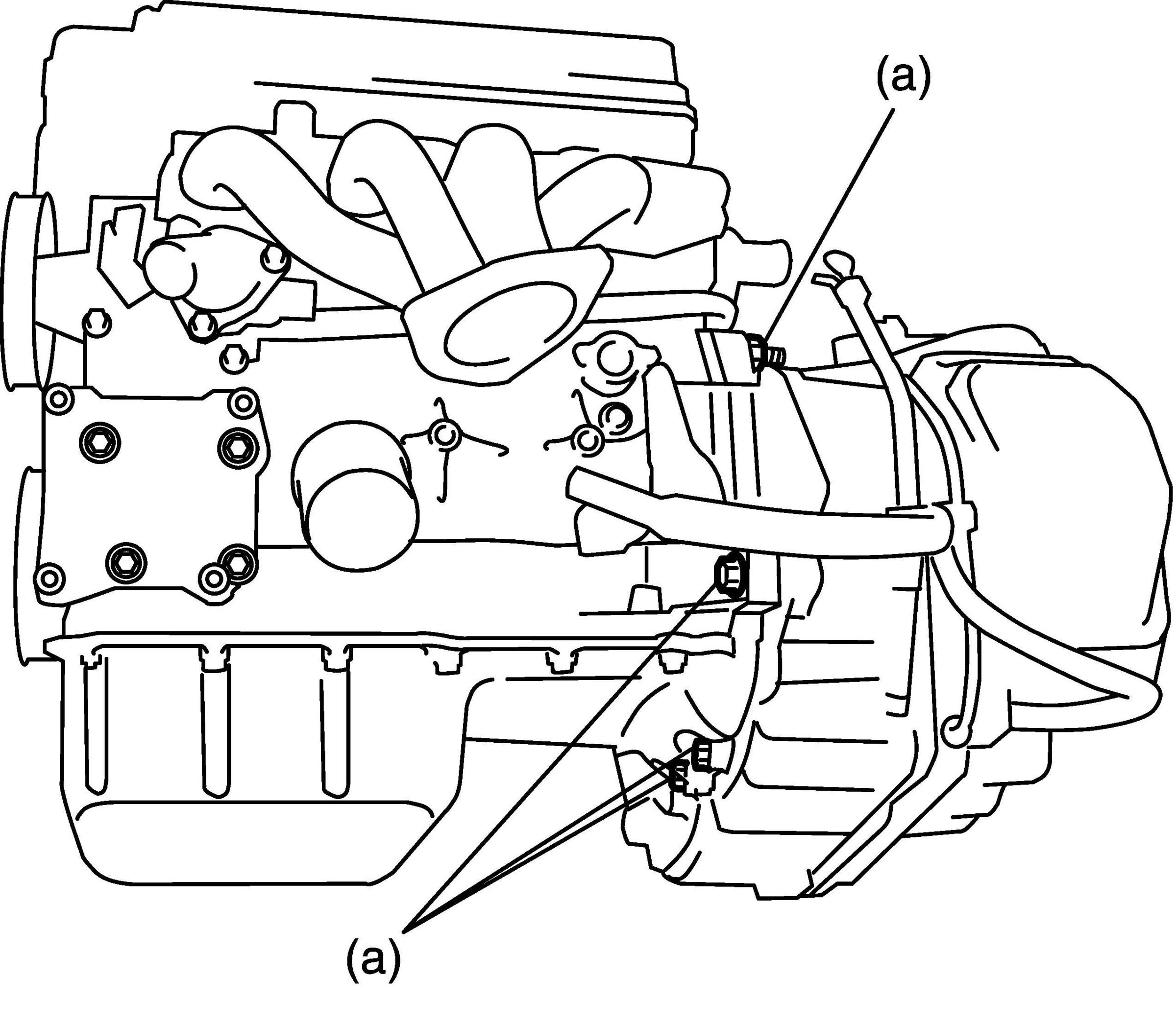

5. Remove clutch housing plate (1).
pic 4

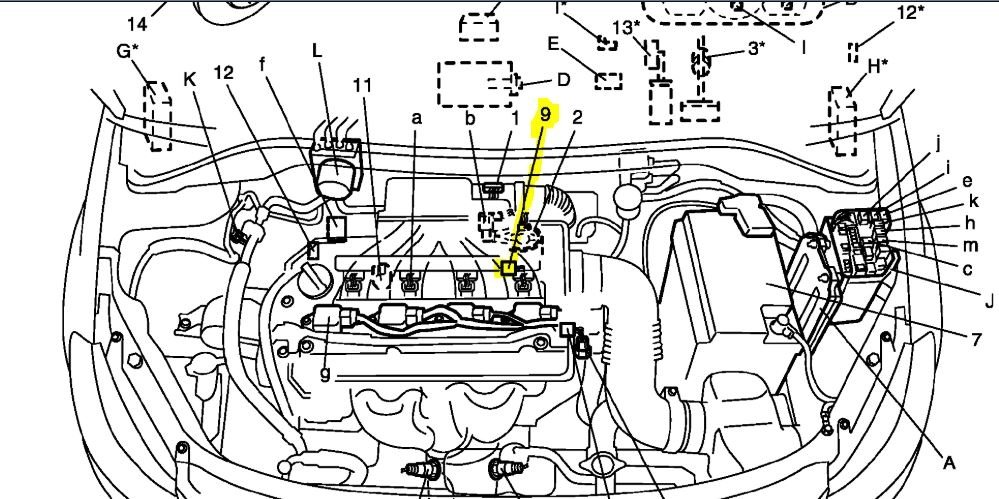

6. Remove torque converter bolts.
To lock drive plate (1), engage a flat head rod or the like (2) with drive plate gear.
pic 5

WARNING: Be sure to keep transaxle with torque converter horizontal or facing up throughout the work. Should it be tilted with torque converter down, converter may fall off and cause personal injury.
pic 6
