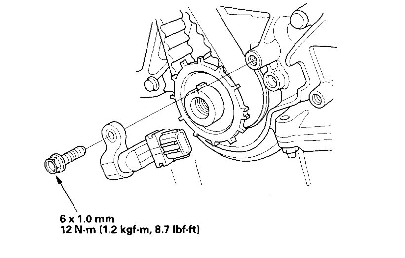

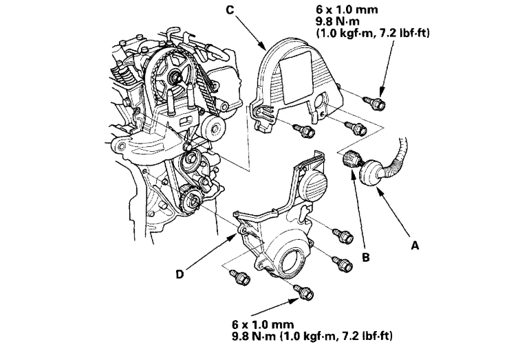

My car's tachometer started dropping to zero, and eventually stop the engine. The car runs totally normal for several miles if driving. Then the tachometer starts bouncing off and on again.
My engine light does come on eventually, and my code reader says it is a crankshaft positioner sensor.
All of my research tends to say that a crankshaft positioner sensor is either bad or good.
Like I said, my car runs like a top until this tachometer bouncing starts, accelerates fine. It has stalled while idling in my driveway several times though.
The check engine light goes off by itself sometimes. I reset it myself many times though.
Thanks.
Dec 31, 2018 at 11:38 AM
Good afternoon,
What is the exact code? there are many for the crank sensor.
https://www.2carpros.com/articles/check-engine-light-top-ten-reasons
The crank sensor is common but needs to be verified. check engine light rarely identifies bad parts just failed systems.
