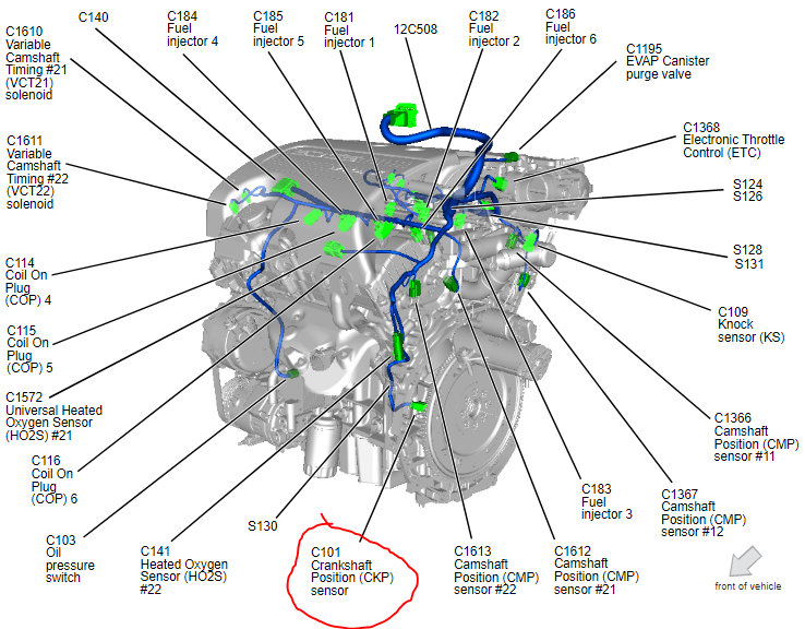

Where is the crankshaft sensor location on the car listed above? What side it on I can't find it at all?

Hello, I'm Danny.
Here is a tutorial showing how to remove/replace a crankshaft position sensor:
I've attached a picture below of the location and circled in red.Hope this helps and thanks for using 2CarPros.
