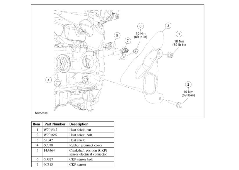

what is the procedure to change the crank sensor? This vehicle is a Taurus X.

Good evening.
Picture attached and procedure.
Removal and Installation:
1. With the vehicle in neutral, position it on a hoist.
2. Remove the left hand catalytic converter.
3. Remove the bolt, nut and the heat shield.
- To install, tighten to 10 Nm (89 lb-in).
4. Remove the rubber grommet cover.
5. Disconnect the crankshaft position (CKP) sensor electrical connector.
6. Remove the bolt and the CKP sensor.
7. To install, reverse the removal procedure.
