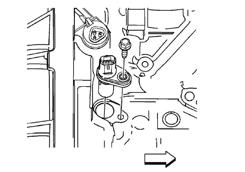

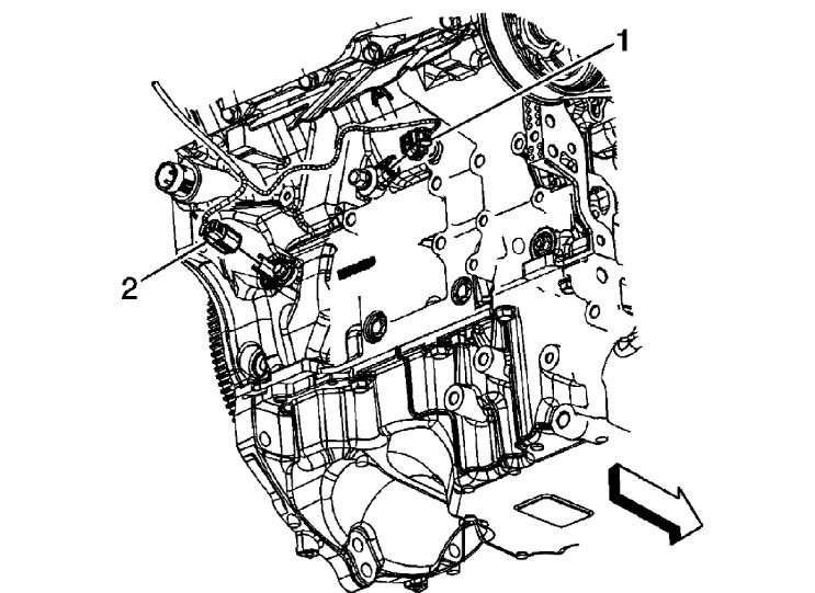

I need to replace my crankshaft position sensor. I'm being told it's extremely hard to get to. Where exactly is it located? And how do i change it?
Mar 2, 2020 at 11:30 PM
Good morning,
I attached a picture of the location of the sensor for you and the procedure for replacement.
Removal Procedure
1. Raise and support the vehicle. Refer to [Lifting and Jacking the Vehicle].
2. If equipped with all wheel drive (AWD), remove the transfer case. Refer to [Transfer Case Assembly Replacement].
3. Disconnect the engine wiring harness electrical connector (2) from the crankshaft position (CKP) sensor.
4. Remove the crankshaft sensor bolt.
5. Remove the crankshaft sensor.
