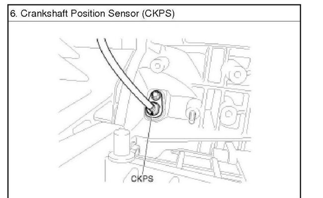

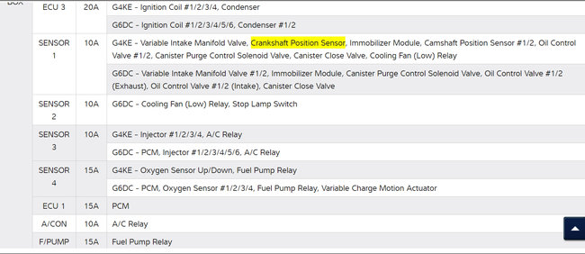

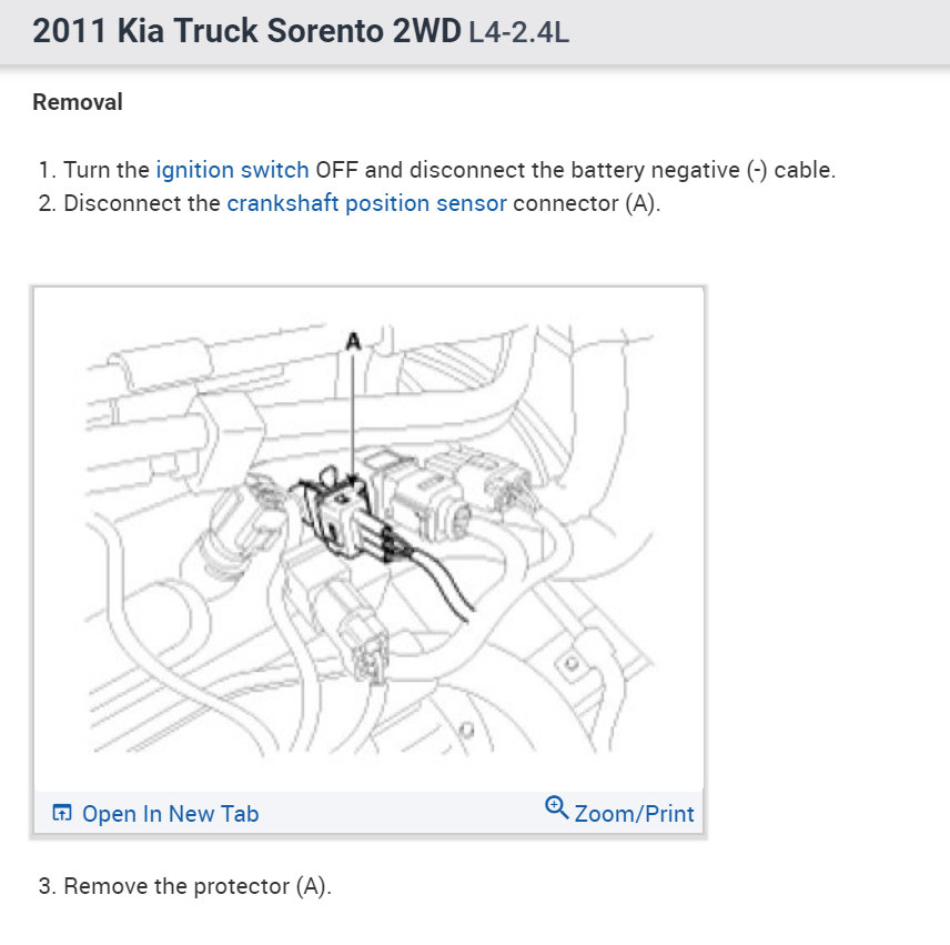

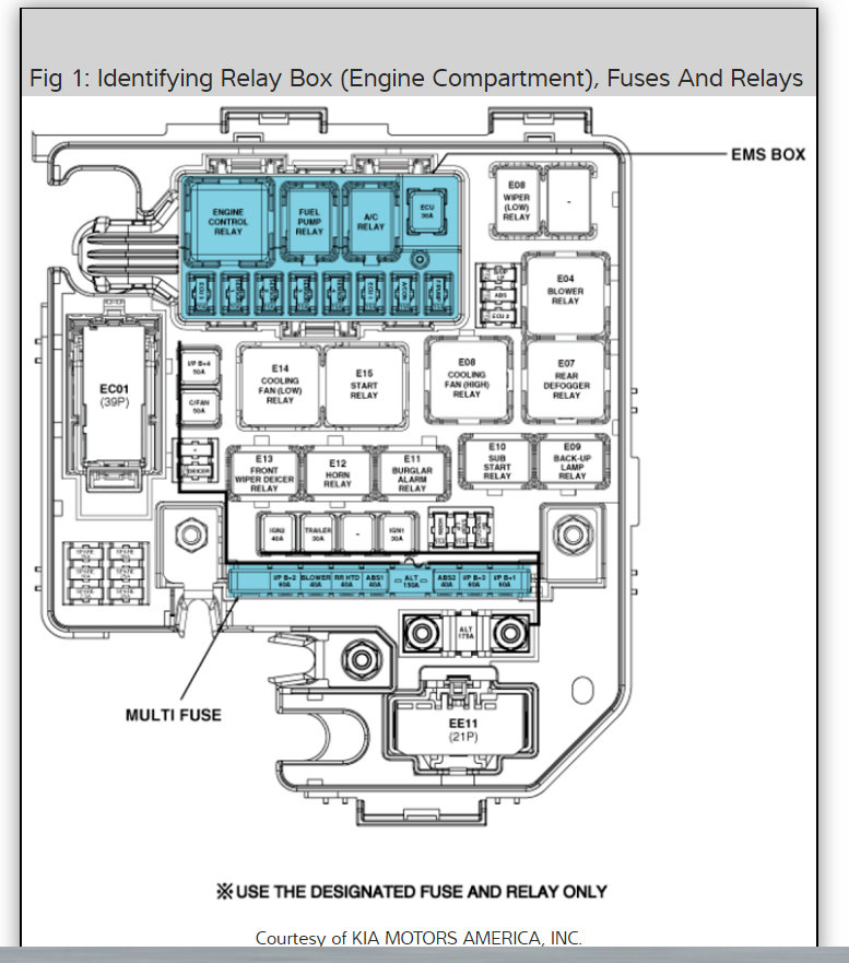

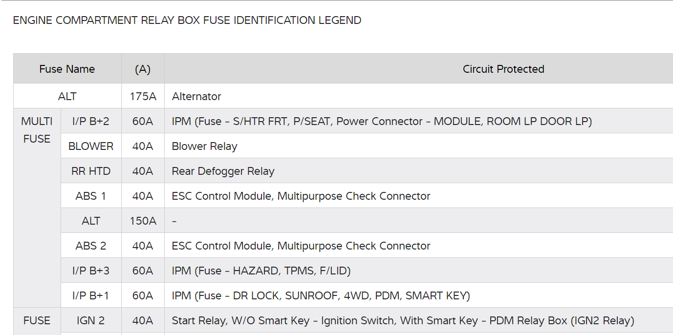

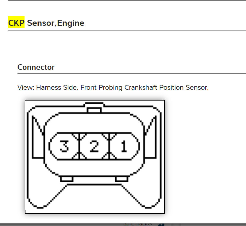

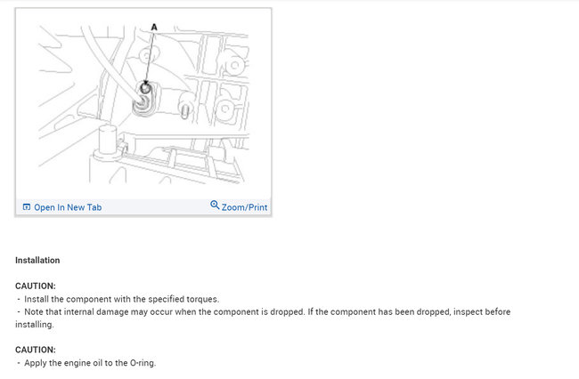

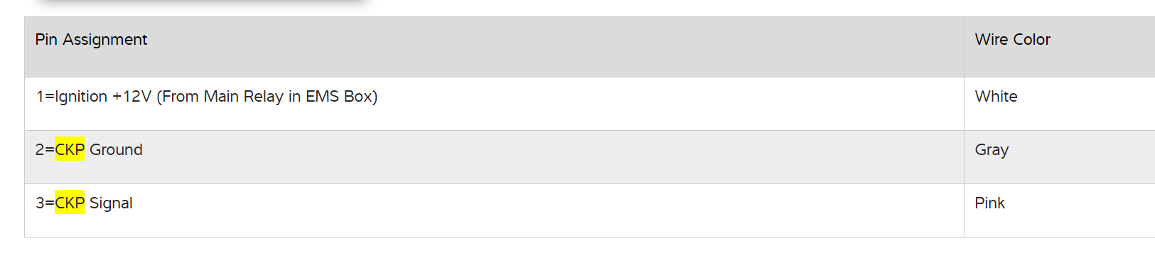

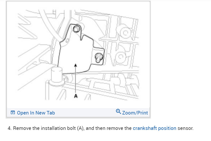

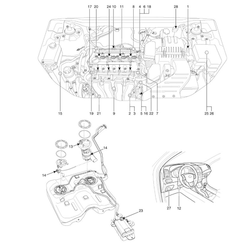

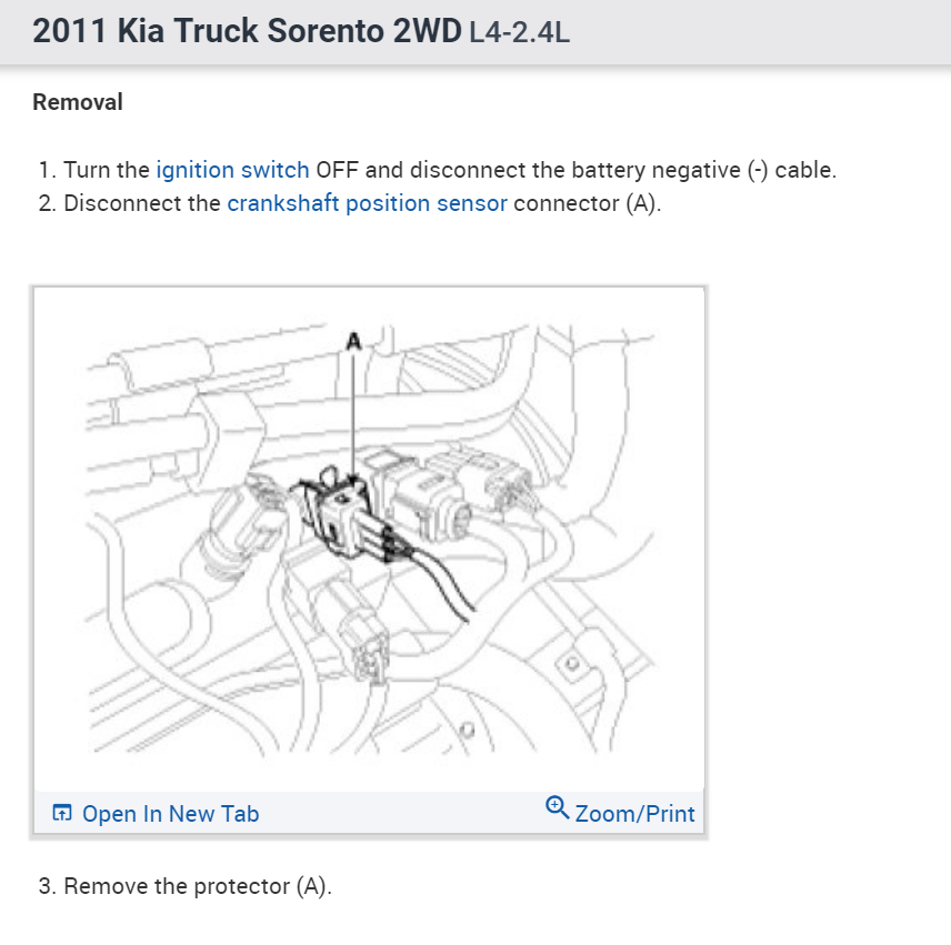

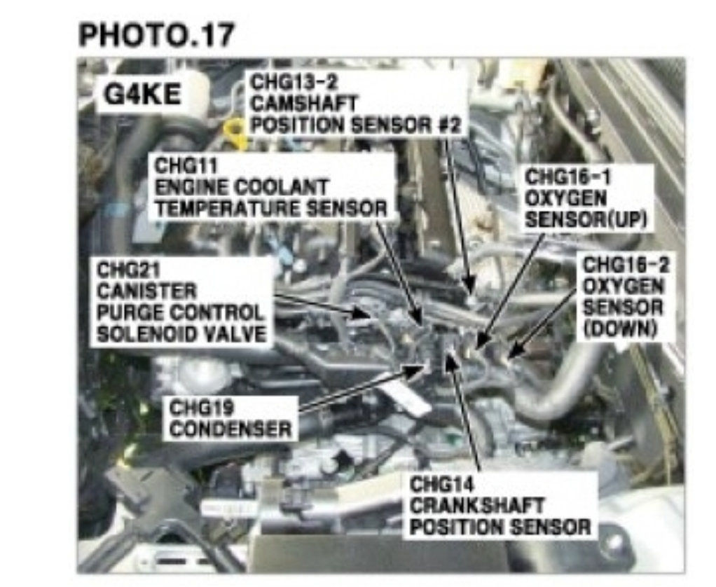

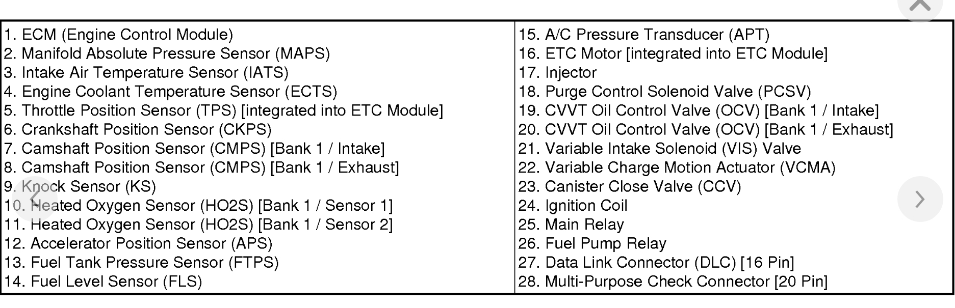

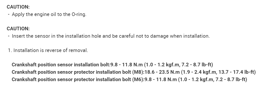

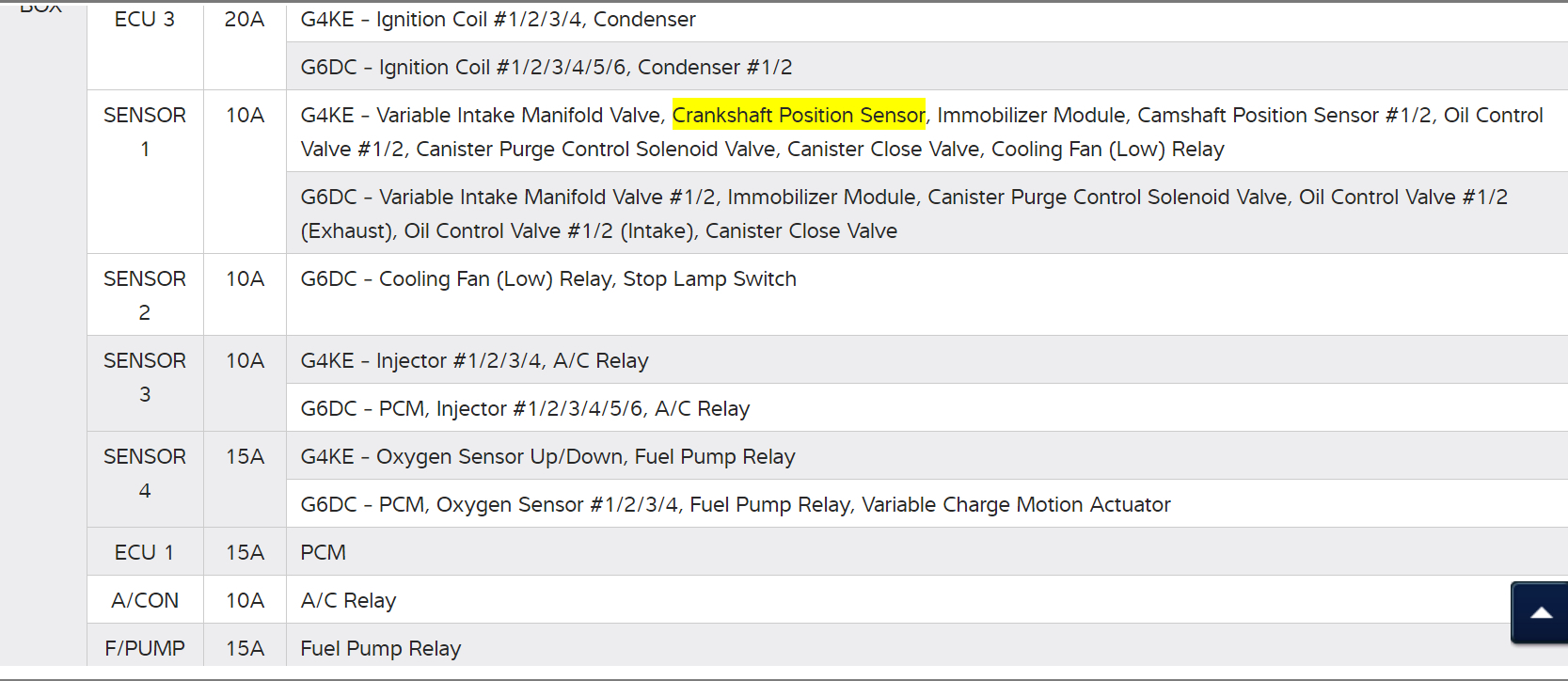

I need to know where to find and how to replace the crankshaft sensor. Thanks.
Mar 16, 2019 at 3:50 AM
SCGRANTURISMO
Experienced Mechanic
4,897 POSTS

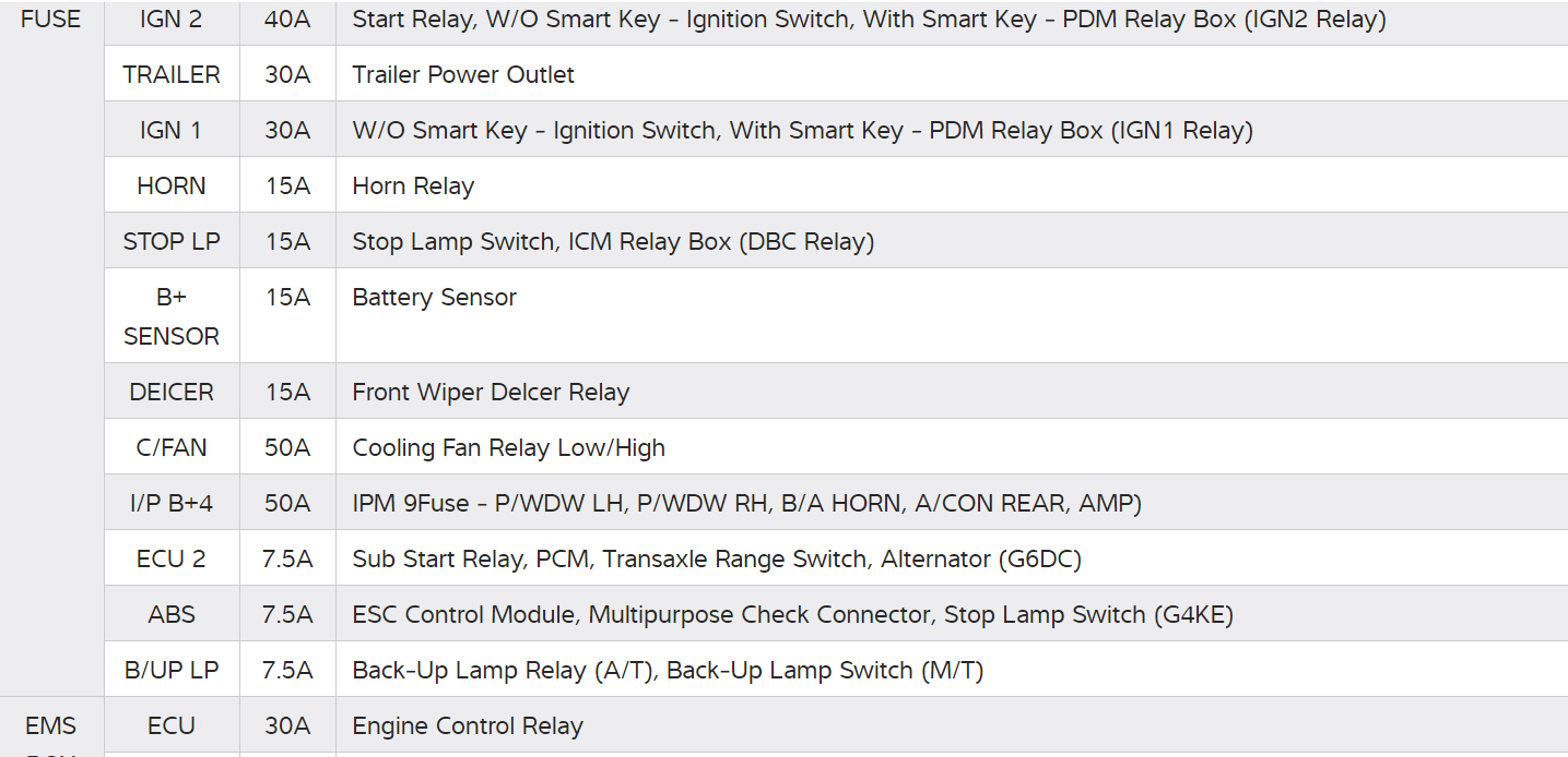

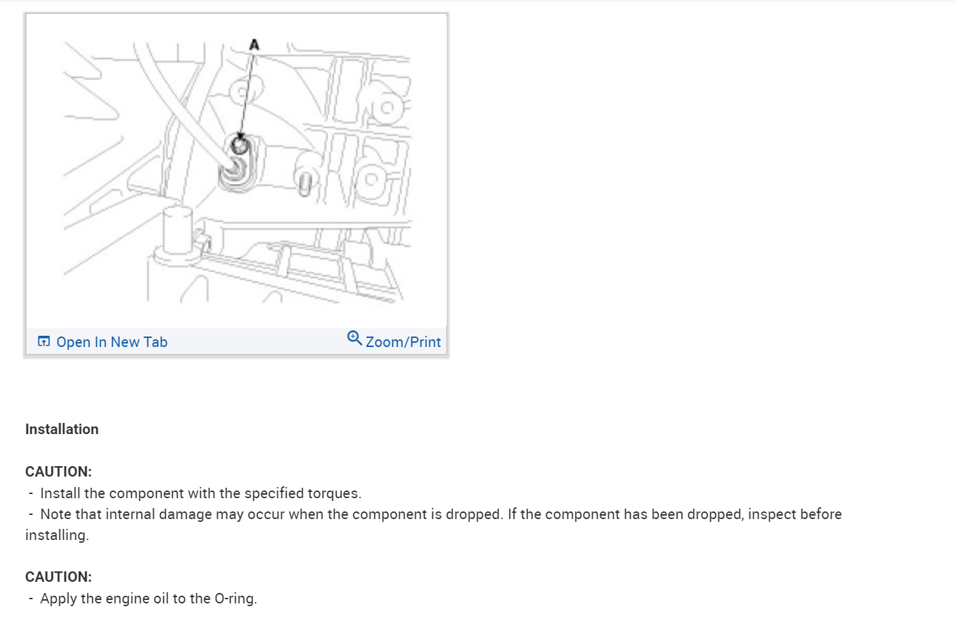

I have included all the information that you requested in the diagrams down below. Please let us know if there anything else we can do to help.
