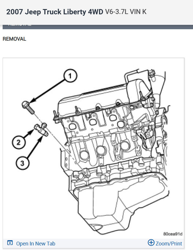

I tried replacing the crankshaft sensor I got from AutoZone. The sensor would not fit, figured it was wrong part, so I ordered from a different store. Same thing happened, the old one goes right back in. I am on my fourth sensor, but they do not fit. I compared old and new and they look identical. Any ideas what is wrong? Thanks
Mar 6, 2025 at 9:58 PM
  • 55,222 POSTS
Can you upload an image of the old and new crankshaft sensors so I can see? To be clear this is the sensor you are replacing, correct? Check out the images (below).

What doesn't fit? Check the old one for the O ring, is it on it? Is it the O ring that blocks it from fitting? They tend to fit very tight as the ring has to compress, I generally apply a bit of silicone grease to the O-ring then rock it a bit to get it started.
Should take a Mopar 56044180AC or an NTK0395.

I am not sure why, first time changing this sensor. The old sensor has o ring and look identical to new sensor. Thank you for the grease suggestion, first time hearing this. Before I do any damage, I am asking, my first thought was to bang it in. Thanks again!
Mar 7, 2025 at 8:30 PM
PJM333
  • 30 POSTS
Greasing the sensor worked, still took a while but I got it in. Better safe than sorry, ignorance on my part but I learned something new. Thanks for everyone's help.
