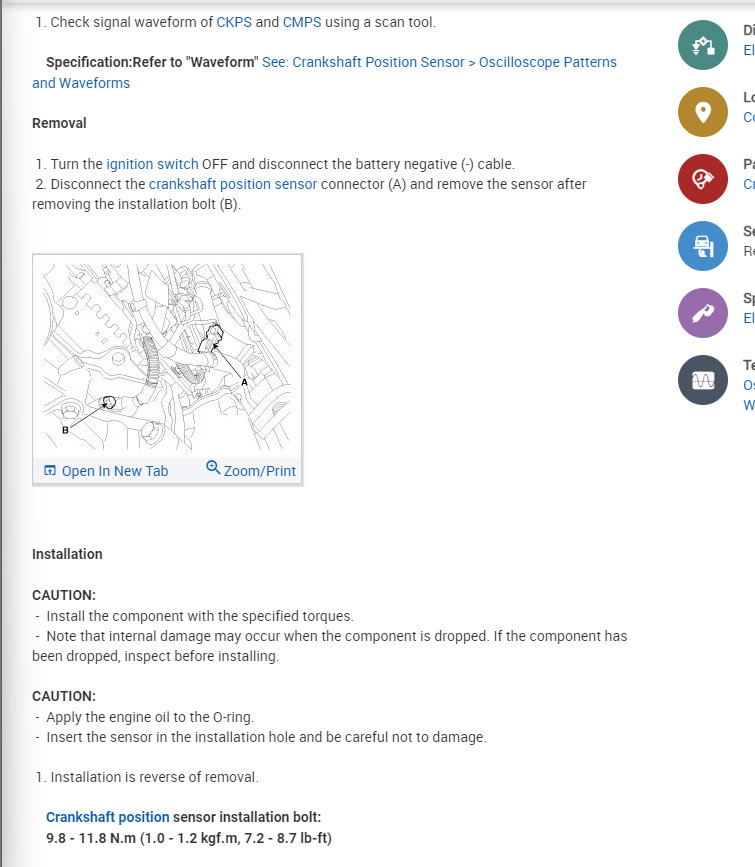

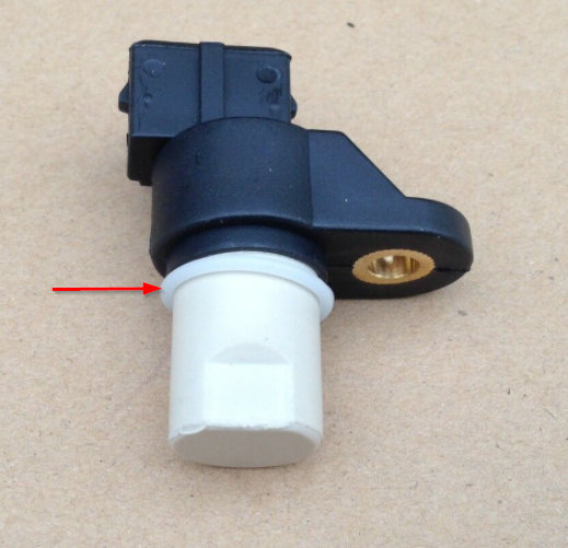

Some crank sensors are adjustable. They have to have a certain air gap or you'll experience these type symptoms.
When you installed the crank sensor was there an o ring with it as shown below? If not, it may not be the correct distance from the tone wheel.
