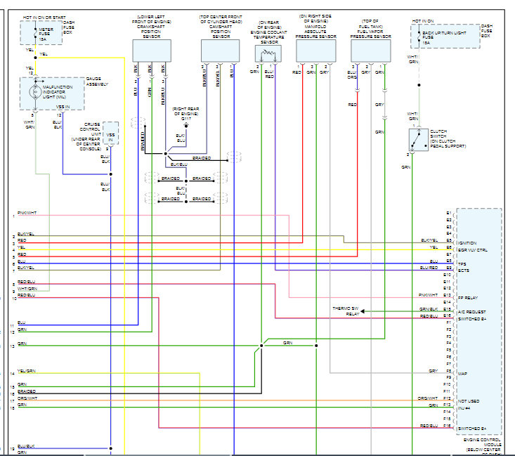

Turns over real slow not getting gas. Crankshaft sensor?
Oct 10, 2019 at 8:56 AM
  • 110,248 POSTS
Welcome to 2CarPros.

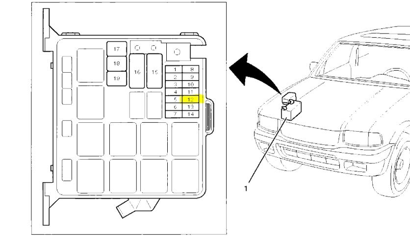

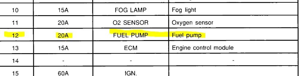

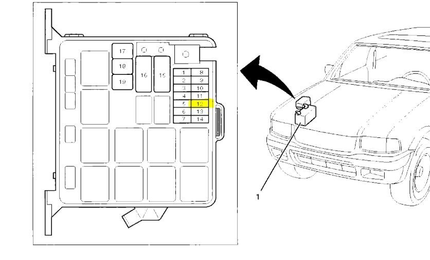

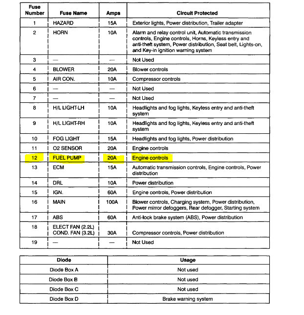

The crankshaft position sensor won't cause it to turn slowly. Are you sure the battery is good? Also, I need you to check fuse 12 in the under hood fuse box. See pics 1 and 2.

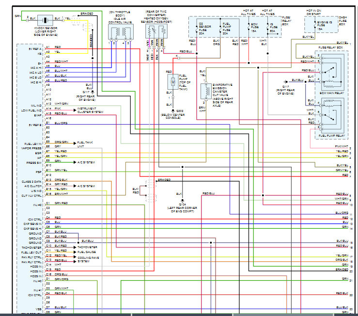

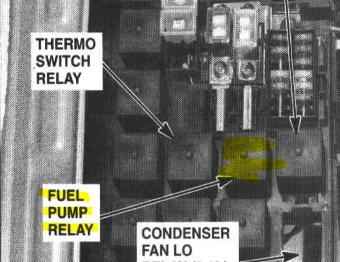

If the fuse is good, check the fuel pump relay in the same power box. I attached a picture of its location. You can switch it with a different relay in the same box that has the same part number or here is a link that explains how to check one:

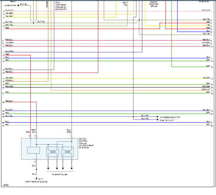

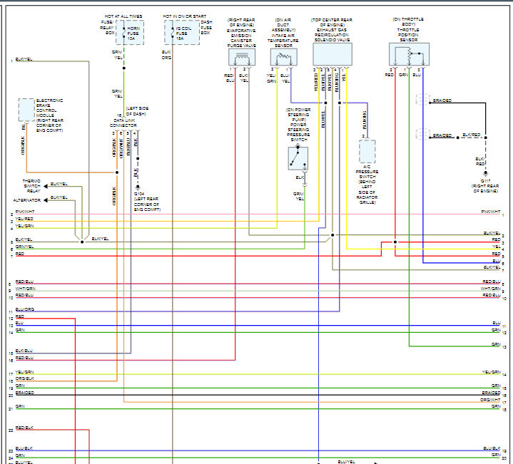

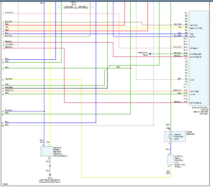

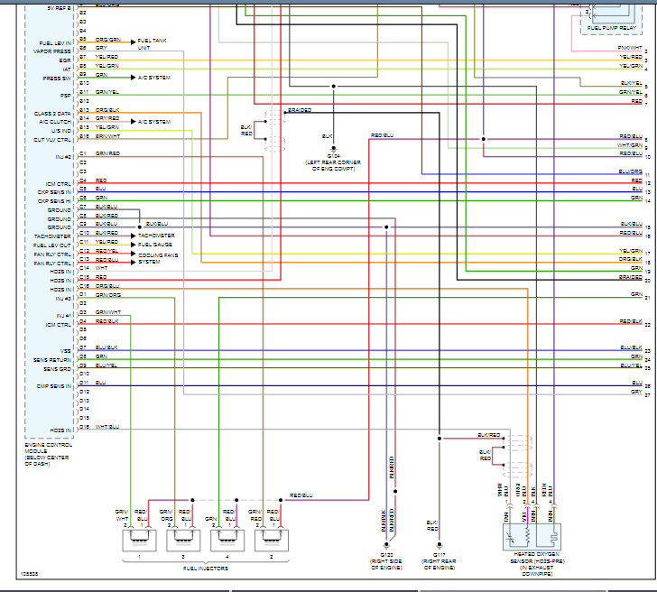

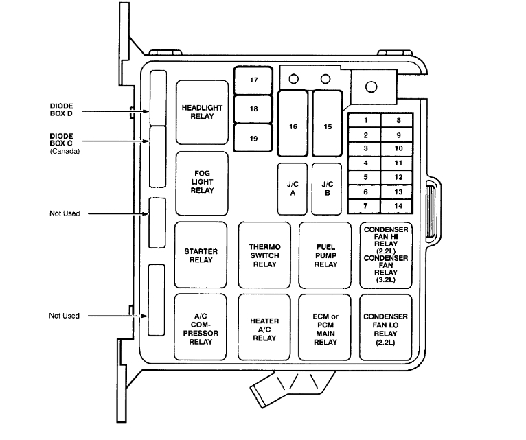

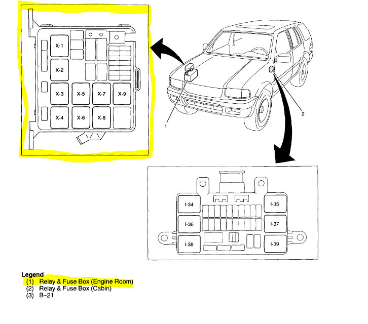

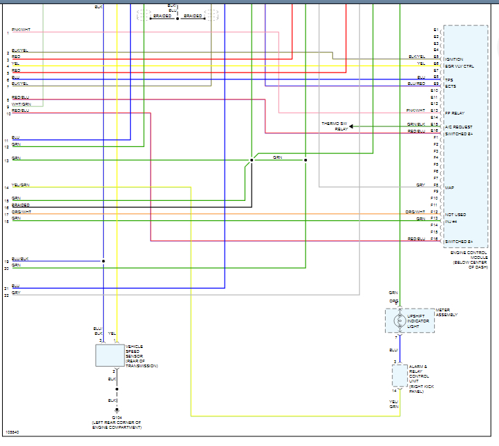

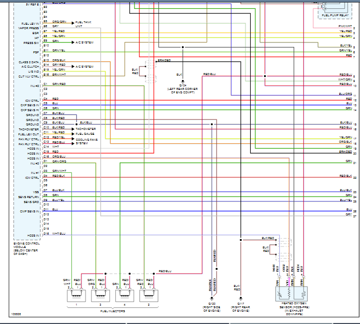

No, this wouldn't be a problem with the crankshaft sensor. This is probably going to be a problem with your vehicle's fuel pump circuit. In the diagrams down below I have included your vehicle's fuel pump wiring diagrams. I have also included the diagram and callout for your vehicle's Fuse Relay Box, as well as it's location. Can you please check fuse 12 in the Fuse Relay Box. Here is a guide on checking fuses, if needed, below:
Please report back here with what you find out.
