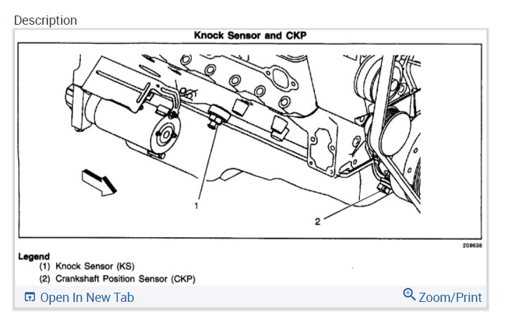

Crankshaft position sensor
1998 CHEVROLET CHEYENNE
220,000,000 MILES • 5.7L • V8 • 2WD • AUTOMATIC
ROBERT85387

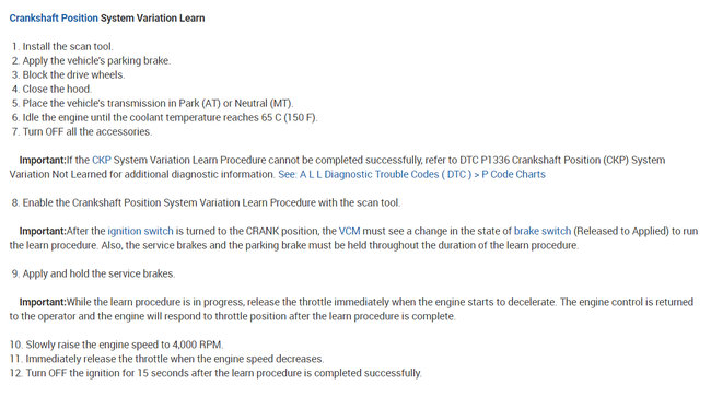

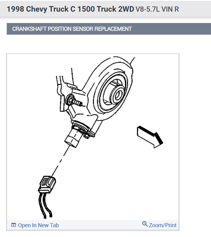

I need to replace the crankshaft angle sensor can you help me please?
Feb 11, 2016 at 4:30 AM
JOHNNYT73
  • 924 POSTS

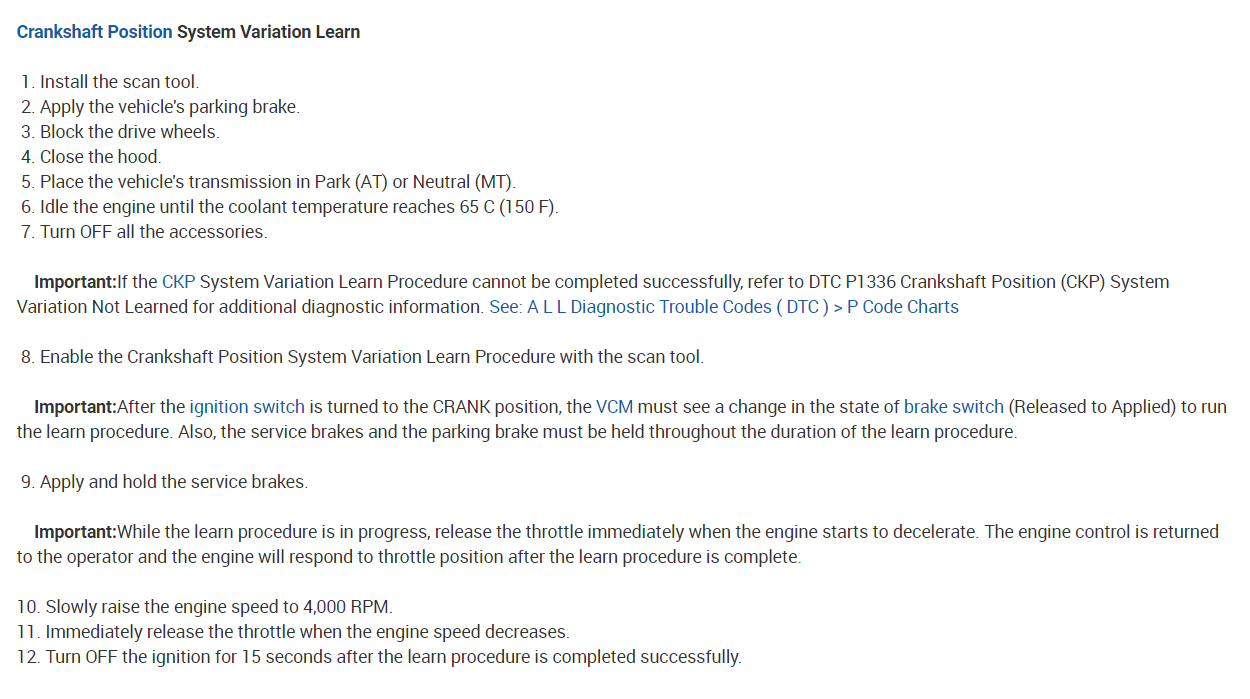

This video will show you how to replace the sensor with diagrams below to show you how on your car.
https://youtu.be/sKo7xRWVNqY
Here is how to replace the sensor with the sensor relearn procedures as well. Check out the diagrams (Below). Please let us know if you need anything else to get the problem fixed.
Feb 11, 2016 at 4:37 AM
ROBERT85387
thanks you worked perfect I cant believe this site if free :)

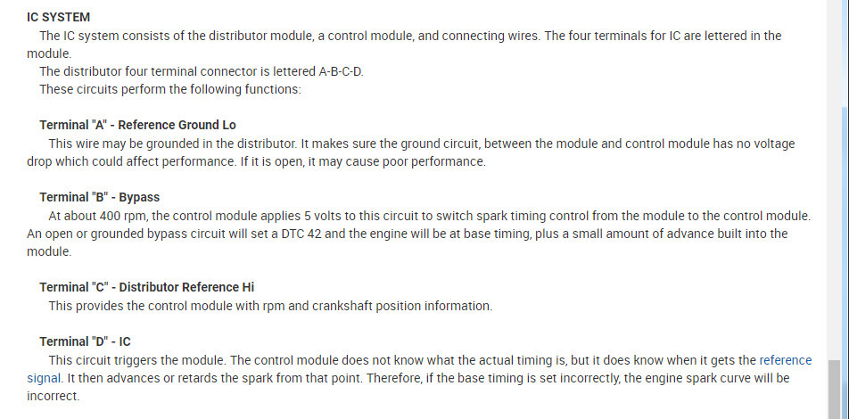

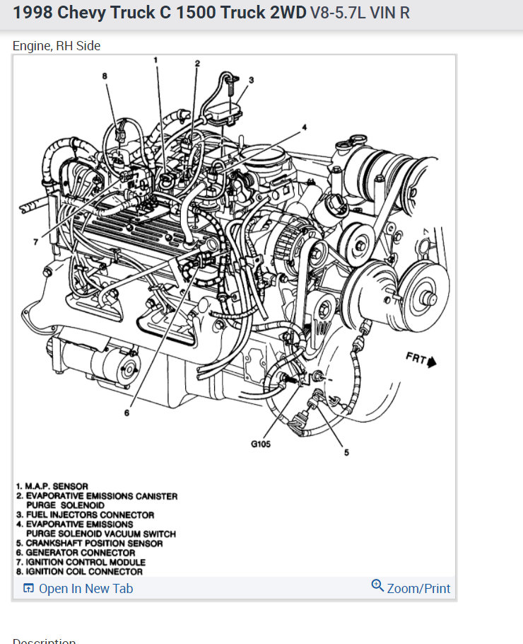

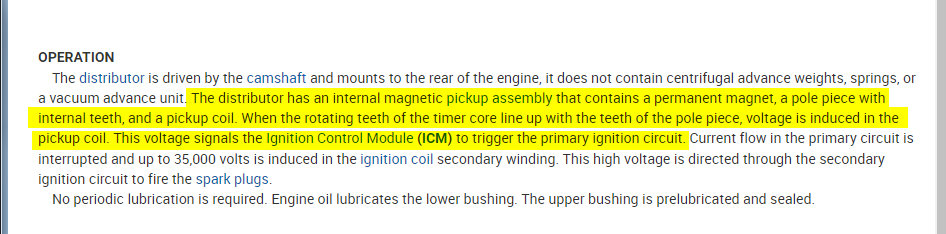

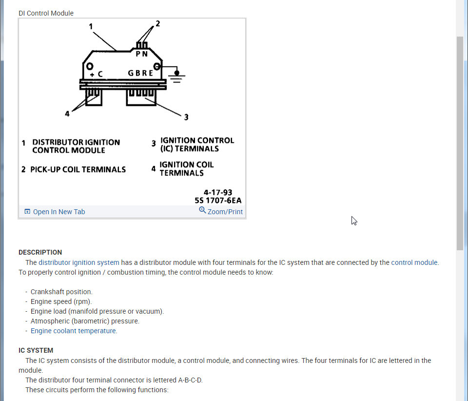

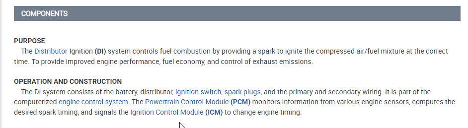

SETITS
c3500 2wd . I have been looking here and other sites for the location on this engine with no good results. I have looked at the engine and it is not on the front lower (passenger side 7 pm) location, or the drivers side at the harmonic balancer.
Jan 18, 2021 at 2:20 AM (Merged)
Danny is correct but just to elaborate a little bit on it. This engine due to it having a distributor uses a pick up coil in the distributor that picks up the rotation of the crank shaft. It sends pulses to the ignition control module and it uses this to determine engine timing.
I am attaching all the info below for your review. Let us know if you have other questions. Thanks
