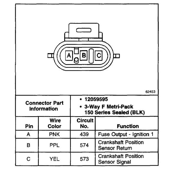

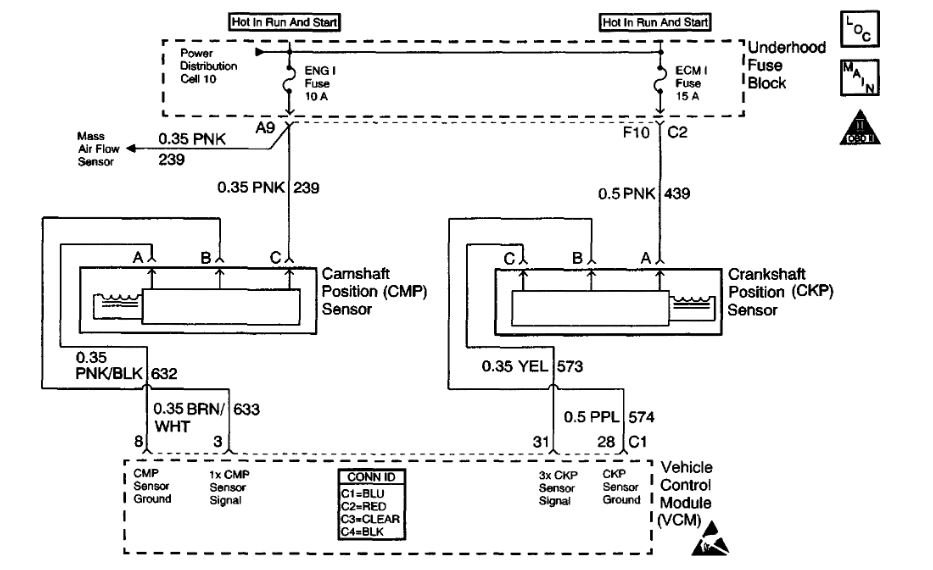

Wires came out of the plug, need to know wire colors to plug. Have yellow wire, purple or brown and looks like orange wire, Have 11.83 volts at orange or pink wire. Have voltage at pink wire at coil and control module. Have no spark out of coil. Will turn over but will not start. Shows code p0336. Need help.

I will attach the wiring diagram for you to view. I will also post the 336 description and needed checks.
The code could be a result of the wiring being incorrect.

Wired the sensor as per diagram. Now get code p0339 and p0336. Is there a way to test crank senor out of the car? Can I rewire the sensor? Thank you for your time and efforts.

Check the connector and the sensor for any damaged pins. Make sure the connection is tight.
