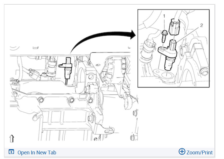

Looking for the location and how to replace the crankshaft sensor.

The crankshaft position sensor is right above the starter motor so you will need to remove the starter to get at it. Here is the location so you can snap it out. Check out the images (below). Please let us know what happens.
