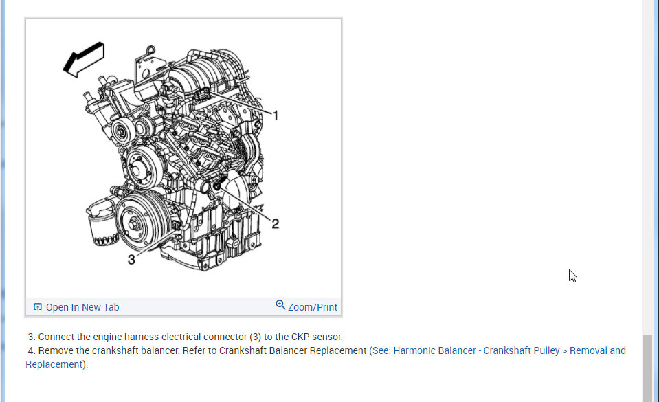

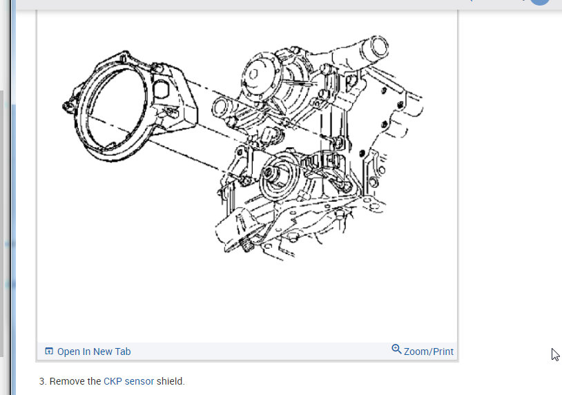

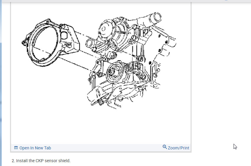

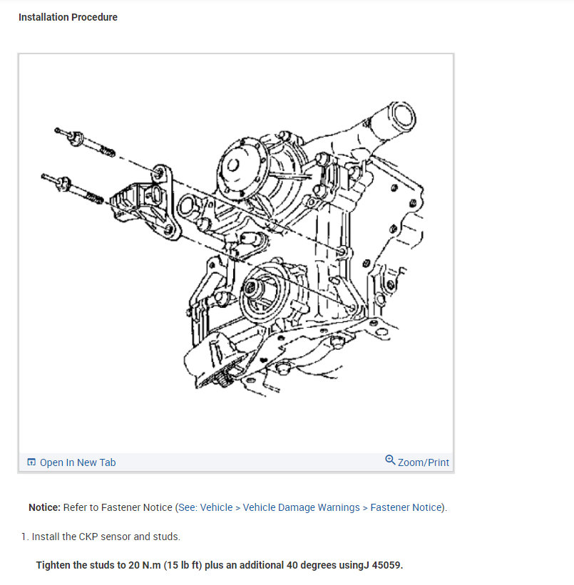

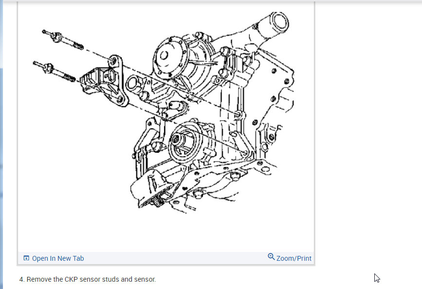

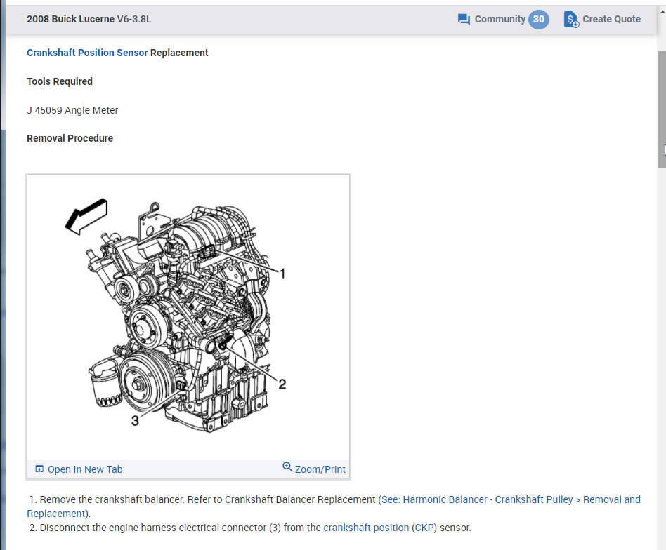

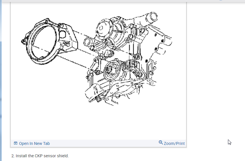

Can anyone tell me where the crankshaft sensor is located on my car listed above CXL, 308 motor?

I attached the process from the manual on how to replace it. Let us know if you need more info. Thanks

Good morning,
I attached the procedure below which is in line with the pictures already provided in the previous response.
https://www.2carpros.com/articles/how-a-crank-shaft-angle-sensor-works
Crankshaft Position Sensor Replacement
Tools Required
J 45059 Angle Meter
Removal Procedure
1. Remove the crankshaft balancer. Refer to Crankshaft Balancer Replacement (See: Harmonic Balancer - Crankshaft Pulley > Removal and Replacement).
2. Disconnect the engine harness electrical connector (3) from the crankshaft position (CKP) sensor.
3. Remove the CKP sensor shield.
4. Remove the CKP sensor studs and sensor.
Installation Procedure
Notice: Refer to Fastener Notice (See: Vehicle > Vehicle Damage Warnings > Fastener Notice).
1. Install the CKP sensor and studs.
Tighten the studs to 20 N.m (15 lb ft) plus an additional 40 degrees usingJ 45059.
2. Install the CKP sensor shield.
3. Connect the engine harness electrical connector (3) to the CKP sensor.
