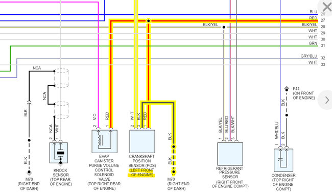

Hi, I need to know the location for the crankshaft sensor. I change the 2 camshaft sensors behind the engine already but not sure where the crankshaft one is located on the vehicle listed above.
Feb 8, 2023 at 6:01 AM
AL514
  • 5,654 POSTS

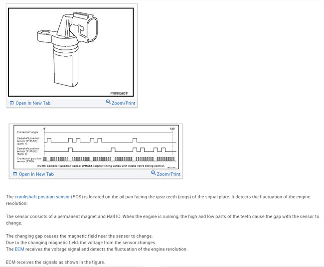

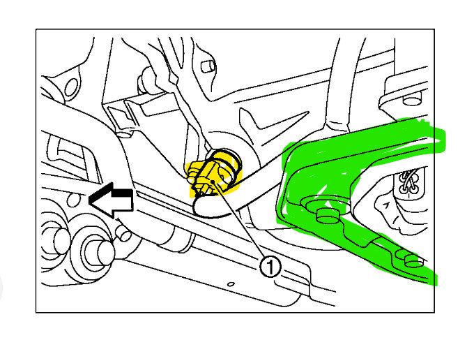

Hello, the crankshaft position sensor is located on the driver side lower down next to the oil pan. I will post a diagram, but facing the vehicle it will be on your right side, you will probably have to look under the vehicle to see it. It has a 3-wire connector,
The green in the 2nd diagram is the oil pan for reference to where the sensor is located. This is a Hall Effect sensor so it should have 12-volts on the red wire for a power feed.
