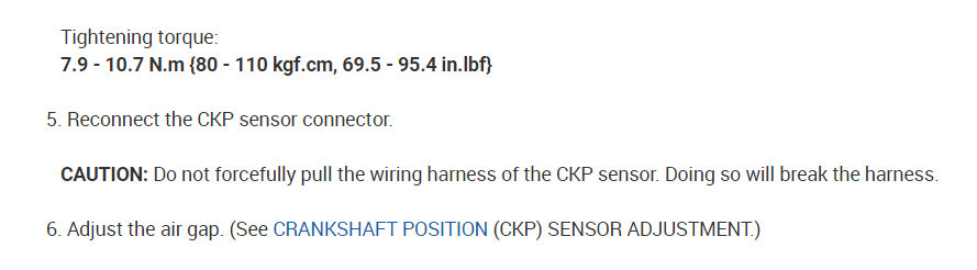

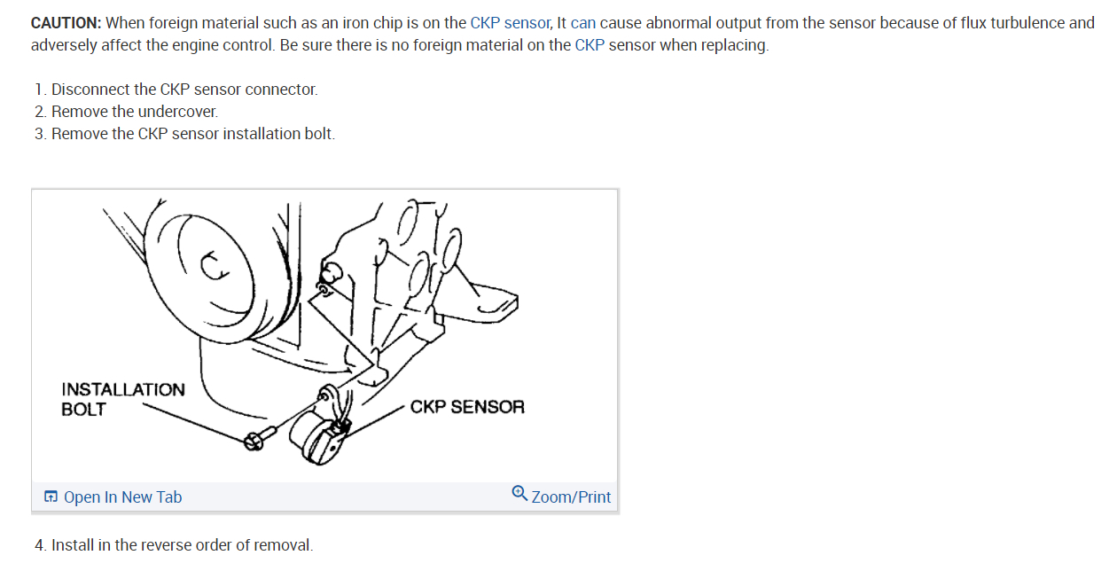

Where do I mount the sensor?
Jun 10, 2021 at 6:12 PM
Experienced Mechanic
52,796 POSTS
Good morning,
I attached the procedure below for you to view. It is external and does not require removing the front cover.
When you release the bolt, twist the sensor before pulling it out. That will release the o-ring and make it easier to remove.
