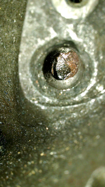

Sensor went bad car stalled wouldn't start again. had it towed home. Located sensor was removing it and it broke off flush with the motor. Drilled it out went to put new sensor in it won't fit. The new one I bought didn't come with an o-ring.

Here's a picture of the sensor hole.

Good morning,
Wow, that hole is not in good shape.

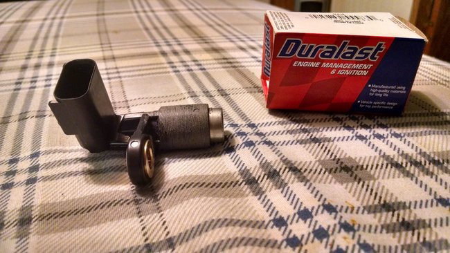

does the sensor fit in the hole?
what brand sensor did you buy and can you upload a picture of it?

Only the metal part of the sensor fits in the hole.

Everyone I've talked to said it should pop out. It's almost like it's cemented can't budge it.

Okay, thanks.
You are going to have to chip the one edge all the way down until it splits and then it should release.
you could also drill it out but the metal chips going into the oil could damage the bearings in the long run.
not a fun job at all.

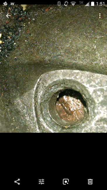

I have been working on the hole. How does it look?
Jan 6, 2019 at 2:55 AM
does the sensor fit in there tight?
Looks better.

It doesn't fit yet. Does the entire dark circle come out? Still just the metal part of the sensor goes in.
Jan 6, 2019 at 3:07 AM
That last thin collar has to come out around the center. use a small chisel and try collapsing it in on itself.

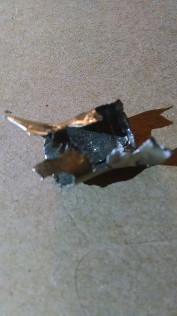

So I got this out of the crankshaft sensor hole. Which I'm assuming is the outer part of the magnet. I'm wondering where the rest of it is? Would it be pushed to the back of the hole or did it fall in oil pan?
Jan 7, 2019 at 9:34 AM
It most likely fell into the pan. drain the oil and see if any of the remnants come out.

How much more is in there?
Jan 7, 2019 at 9:51 AM
look at the new one. compare it to what you have versus what is new.
the only part you got off before getting it out was the top. the rest is inside the pan

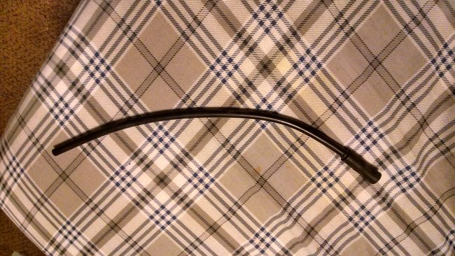

TWIZDID77
  • 18 POSTS
This was on the ground under the car.
Jan 8, 2019 at 4:18 AM
Looks like a vacuum line from somewhere. this will not cause the no start.
