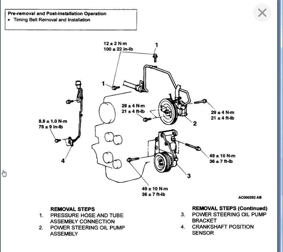

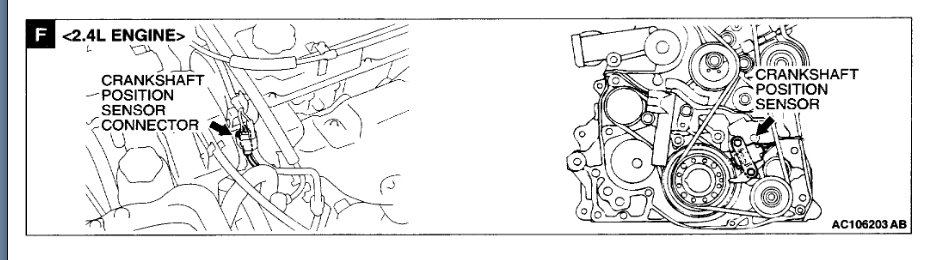

Crankshaft senor replace and a diagram of where it is located.

I attached the info requested. Let us know if you need more info. Check out the diagrams (Below). Please let us know if you need anything else to get the problem fixed. Thanks
