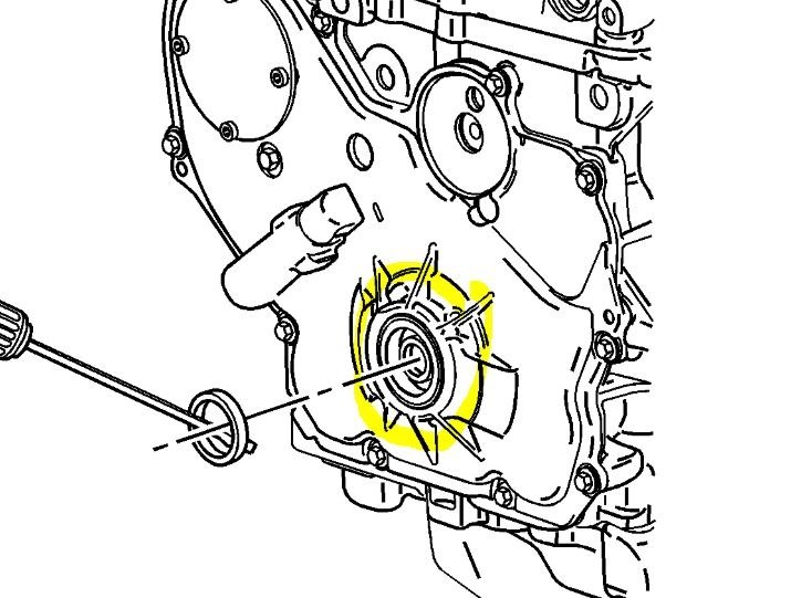

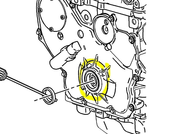

I have had my front crankshaft seal replaced four times in the past year and a half. I've had family and mechanic shops replace it. Each time, it holds up for a little bit then starts leaking again. The most recent time it was replaced was about three months ago, and I also had to replace my alternator because oil got thrown up into it. It's now starting to leak again. The last seal I got was from the dealership, so I'm not sure why the thing keeps leaking. Please help!

It could be that you have a nick or a burr on your crankshaft. It could possibly be out of round. Did anyone that you had replace the seal check for any problems with the shaft itself? Here are a couple of links for you to go through:

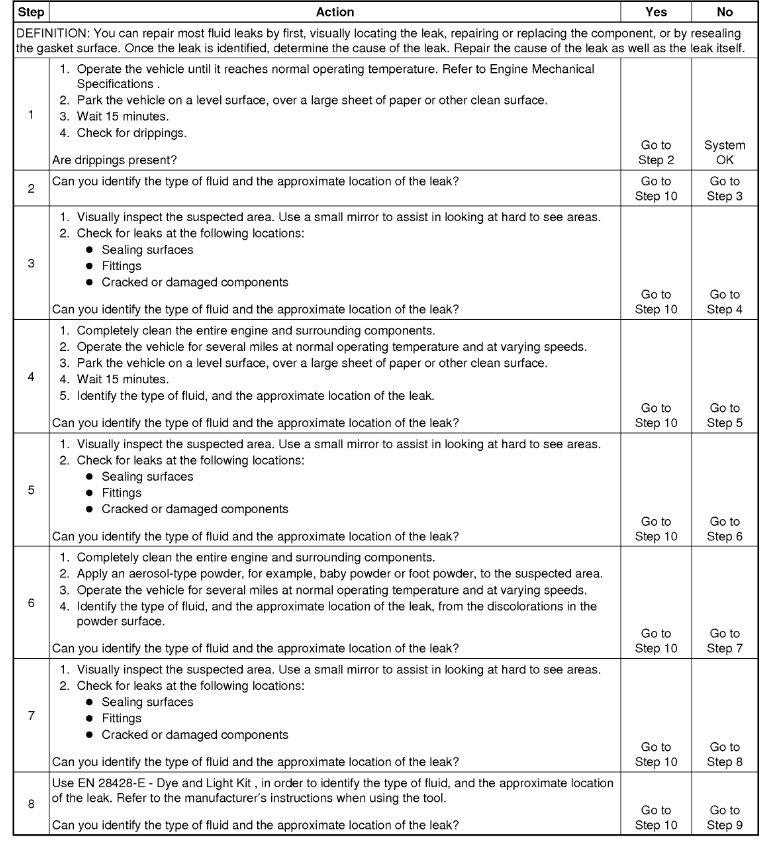

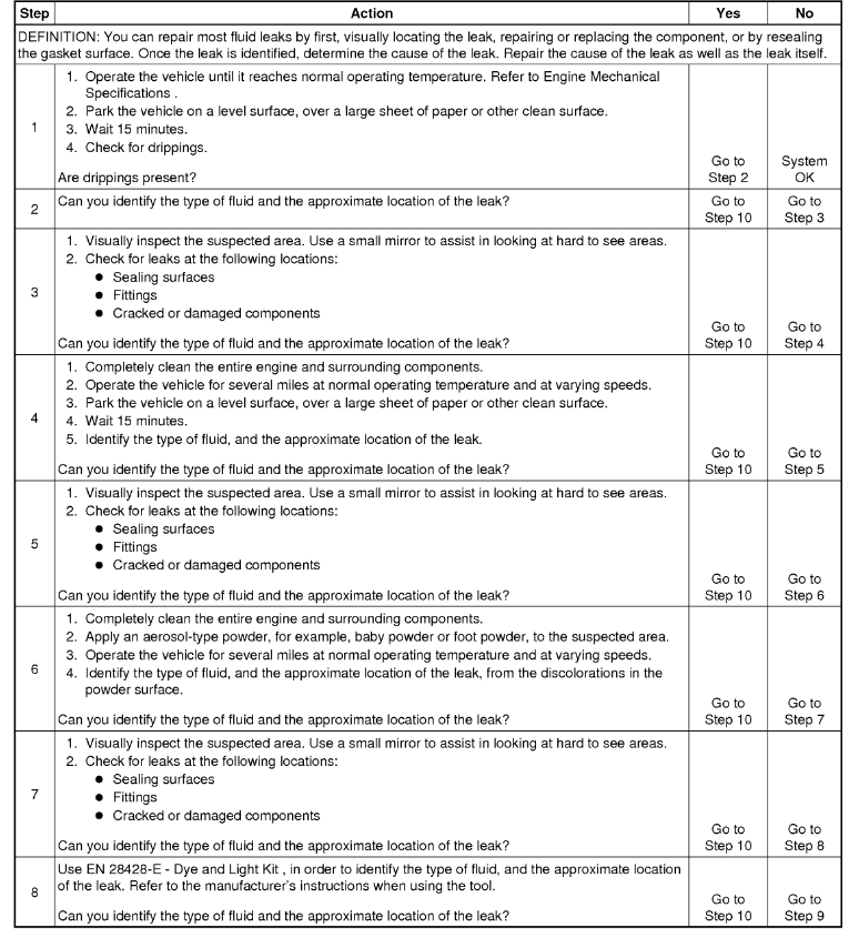

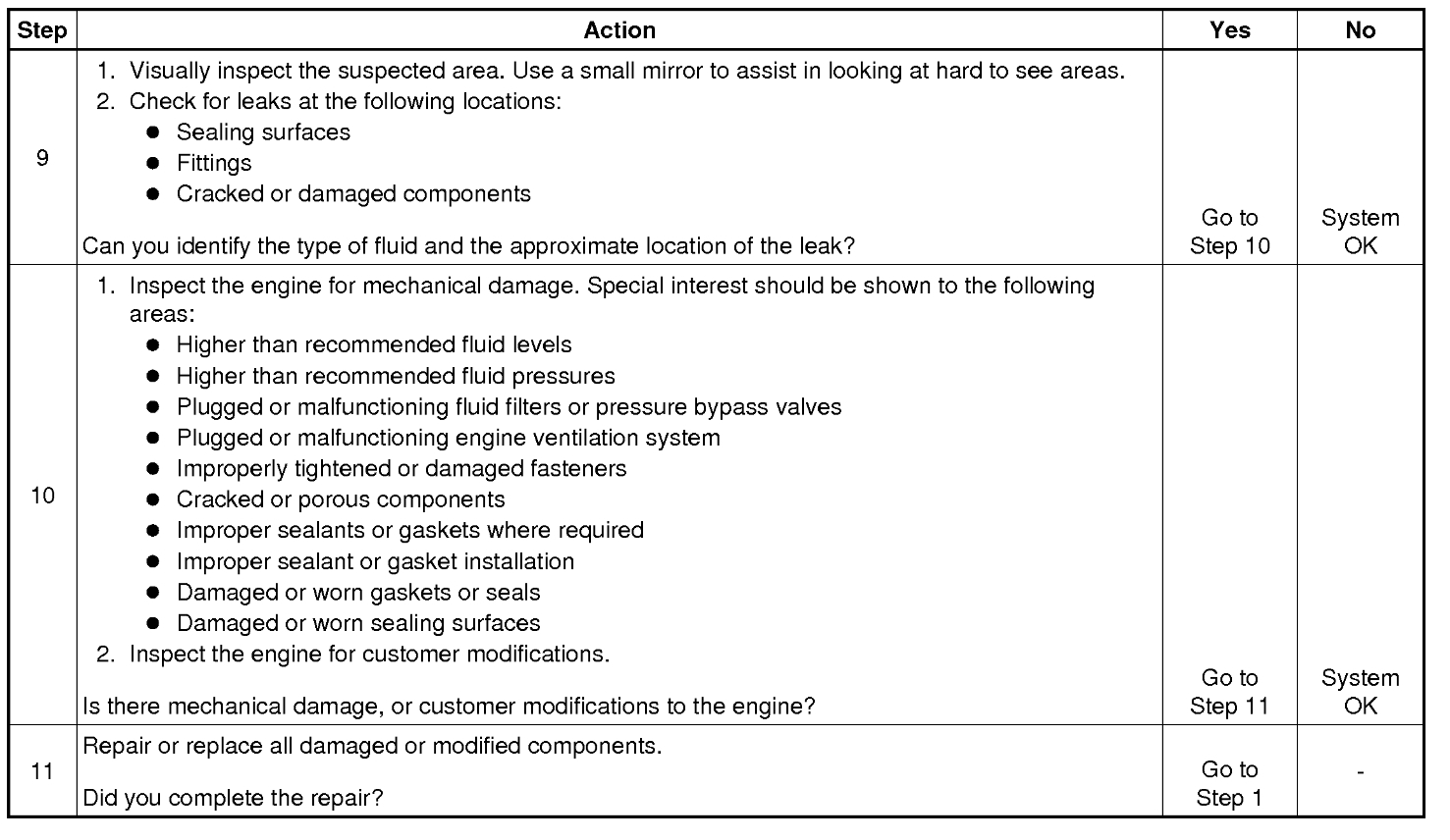

I have included a oil leak flowchart for you down below in the diagrams. Let us know what you find out please. I hope this helps.
