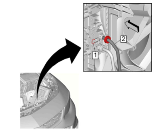

After having the crankshaft front seal replaced and an oil change, it shut off while driving, why?

So, i had a mechanic put a crankshaft front seal in and an oil change. When it was all done, I drove off and a half mile down the road it shut down on me. why is that?

I got in the car a literally drove a mile down the road it shuttered and lost my RPMs and smoked everywhere, total loss of power.

Has anyone been able to identify the cause of the smoke? That is my biggest concern. As far as it not starting, we can figure that out, but I would like to know about the smoke, so we don't further damage something.
When you had the issue, did the smoke have an oil smell or something different?

Okay, the smoke was likely from engine coolant steaming. As far as the battery is concerned, it can cause it. However, it wouldn't have caused the smoke. It sounds like it may have stalled because of overheating. Did you check the temperature gauge when this was happening?

Okay. Then one other thing at the radiator may have been transmission fluid. The transmission cooler is integral to the radiator. There is a supply and return that may have leaked.
I attached a pic below showing the supply line. The return looks the same but is lower on the radiator. Has the transmission fluid level been checked?
See pic below.
