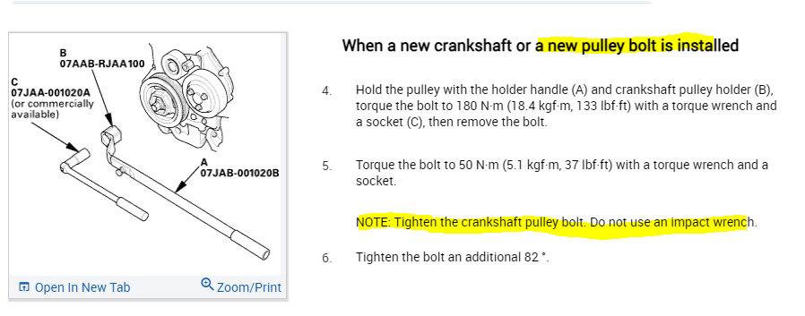

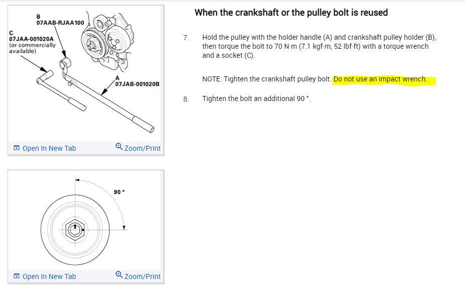

Grab the pulley and see if you can move it in and out at all? I'm questioning if there is excessive play in the thrust bearings on the crankshaft. The pulley itself really shouldn't change. I know when they are reinstalled, it should be done with a wrench and not an impact. That can cause issues.

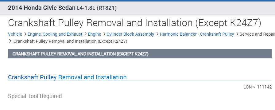

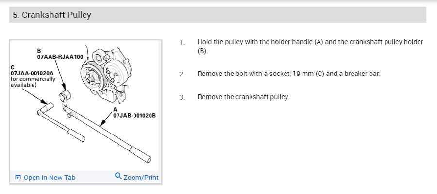

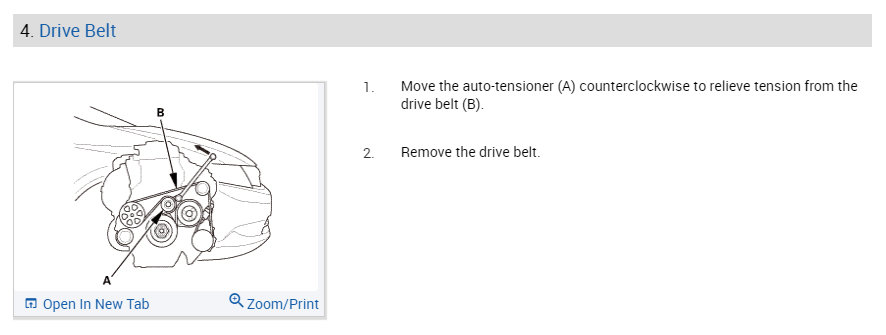

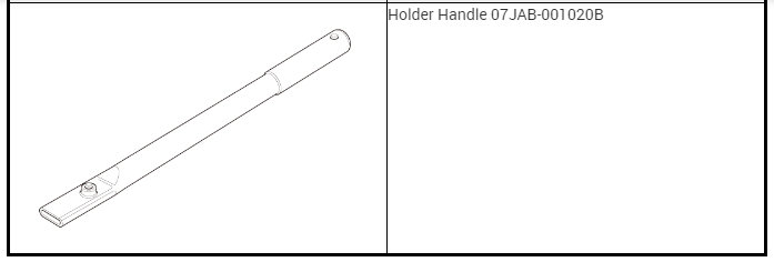

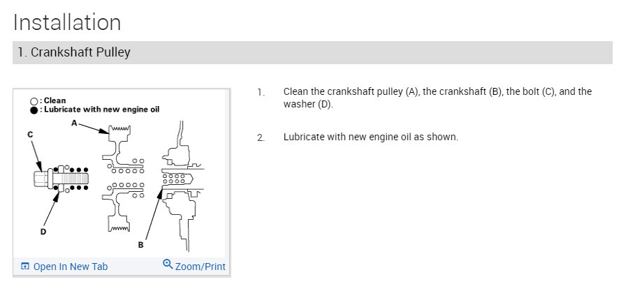

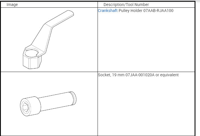

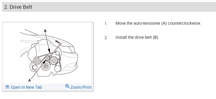

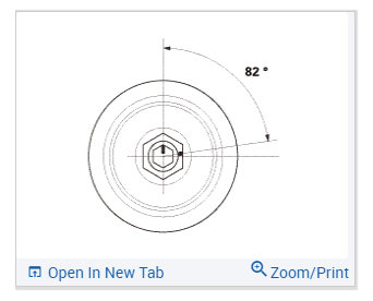

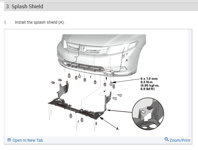

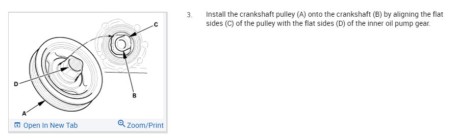

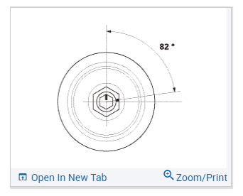

I went through the directions and there really wasn't anything out of the ordinary when installing. The only thing that stood out was not to use an impact when installing. Maybe someone beat it on with an impact and it pulled in further than it should be. Also, I noticed that the torque specs are different if you use the original bolt or a new one. They may have got the wrong info on that.
I attached the directions below for the removal and installation of the pulley. Take a look through them and let me know if you have questions.
Take care and let me know how things turn out for you.
