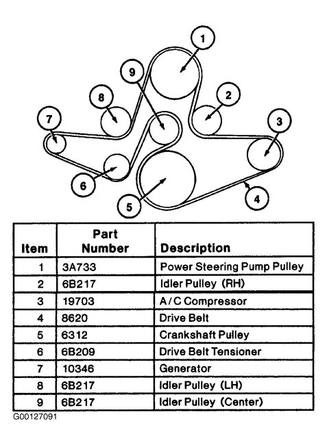

Broken pulley not sure which pulley. This pulley is located on the top left hand side of engine. The first pulley you see on the left hand side of engine. Tried to remove pulley but the bolt broke.
Sep 18, 2016 at 2:05 PM
AL514
  • 5,702 POSTS
Sounds like the alternator or idler. here is a diagram to identify the different pulleys. This is for the 3.0L Engine.
