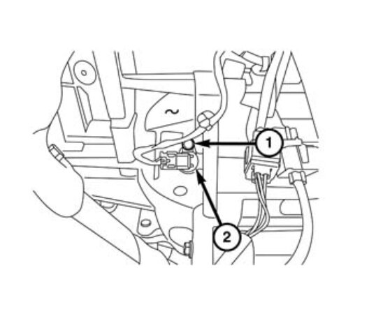

The P0339 is related to the crankshaft position sensor (CKP). However, it doesn't indicate a failed sensor. Instead, it is related to an intermittent signal issue. Yes, the sensor could be bad, but there is a good chance it was installed incorrectly or there is a wiring issue.
When the new sensor was installed, was the connector to it checked for damage or wiring damage to it?
Also, could you confirm the C1211 for me? That code isn't relevant to this vehicle.
I attached a pic below showing the CKP. It needs to be evenly and fully installed. It isn't uncommon for rust to prevent that from happening. Once it's in, there is only one way you can bolt it in place. You could ask the person that installed it if that was done correctly.
Let me know. Also, I would recommend getting an OEM part. So many of the aftermarket parts are faulty. However, I rarely have issues with the place you got the sensor, but anything is possible.

I didn’t see a pic attached to your post.

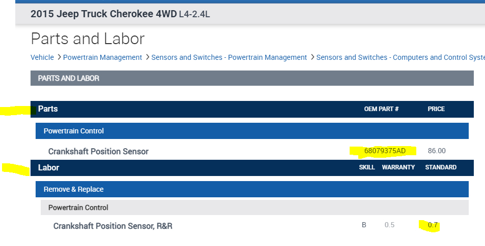

I think that is a good idea. I attached a pic from the manual. I had a better one last night, but I can't find it again. UGH.
Pic 1 shows the labor time and the OEM part number and price.
Let me know if this helps.
Mar 19, 2023 at 12:58 PM
ISUEJENMAR
  • 6 POSTS
The info is for a Cherokee. Is it pretty much the same thing? Now I just have to convince my brother to try the OEM part. If not, I’ll see if a mechanic will do it. Luckily it hasn’t stalled again.

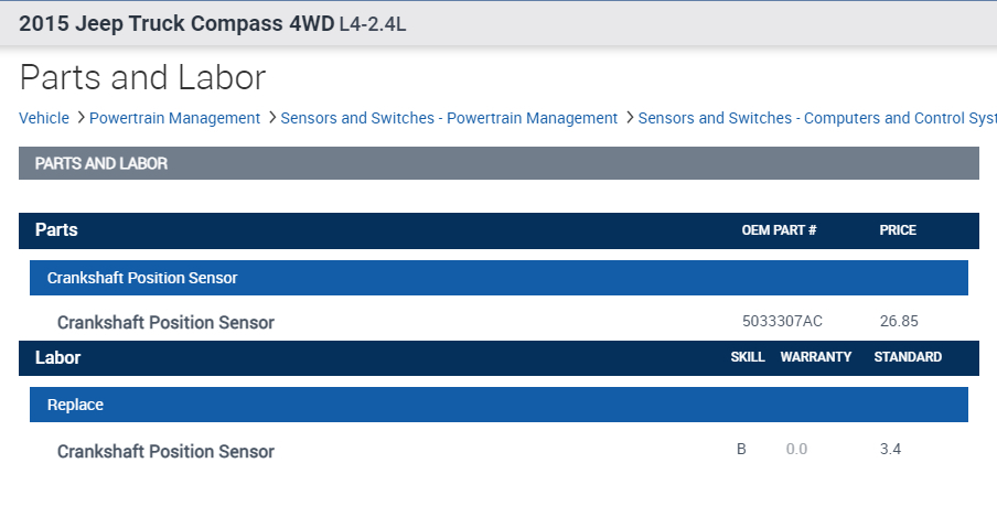

  • 110,244 POSTS
I'm so sorry. Ugh!!! I attached the parts and labor below specific to the compass.
Let me know if that helps.
See pic below.
Mar 20, 2023 at 2:35 PM
ISUEJENMAR
  • 6 POSTS
Thanks for the info. I should have got that part first. I don’t know when it will be changed, but when it is I will let you know if it worked.
