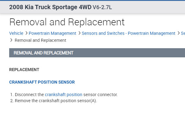

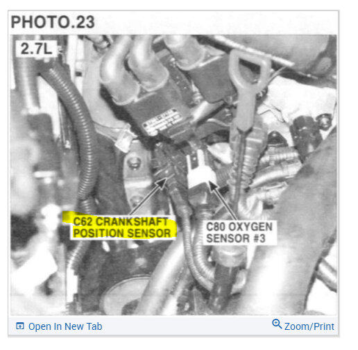

I need a diagram of where the crankshaft sensor is located. What parts will i have to remove?
Apr 18, 2023 at 7:56 AM
  • 110,241 POSTS

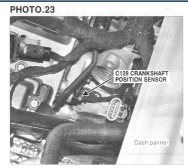

The fresh air intake needs to be removed. (See pic 1) Once that is off, the sensor is located under it. (See pic 2)
Pic 3 is very vague directions from the manual.
Here is a link you may find helpful in addition to the directions:
Take a look at the pics and let me know if they help.

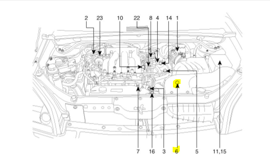

This engine is a 3.3 liter. That's our problem. We can't seem to get a diagram of the 3.3 liter. Although helpful and much appreciated this is not what our engine looks like. KIA Sorento LX 4x4 3.3 liter. Please help
Apr 19, 2023 at 11:38 AM
  • 110,241 POSTS
Take a look at this pic. I am so sorry that I sent the info for the 2.7L. Here is what I'm showing for the 3.3L.
Let me know if this helps.
joe
See pic below.

Thank you so very much! I'm very grateful..
