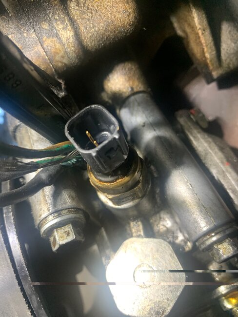

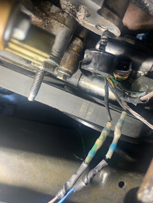

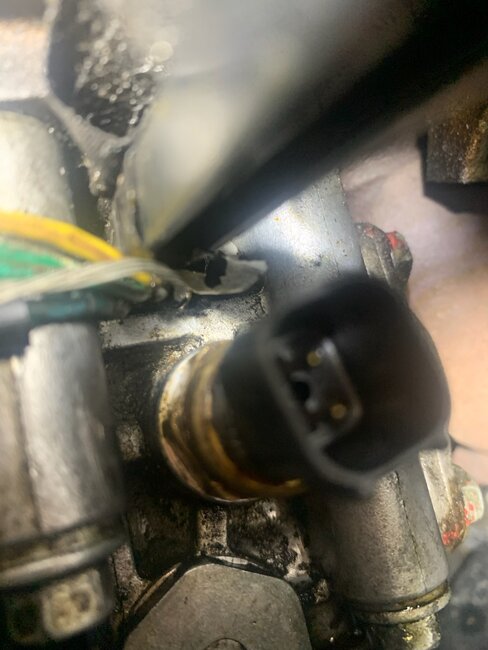

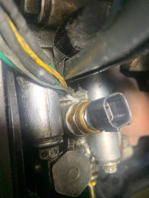

I put some pictures up the wiring is all ripped out cut short and I'm trying to see which one goes to where I'm lost especially the bare one. The car listed above is an SE model. The car cranks fine hard to start though and when it starts it sounds terrible.

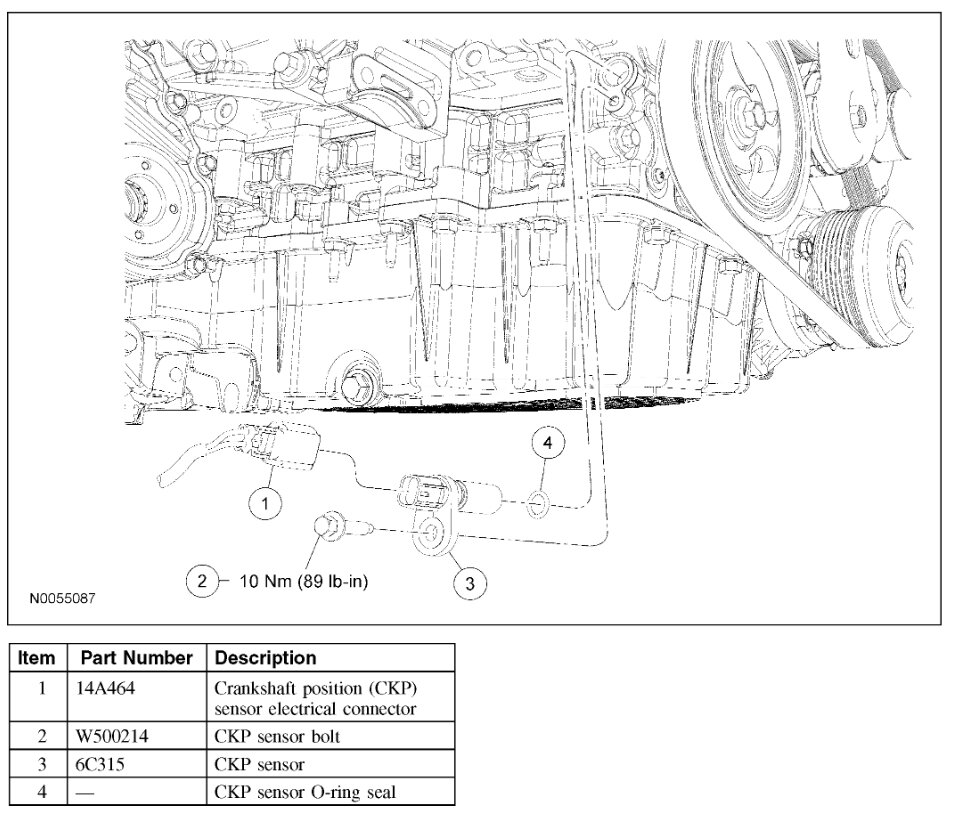

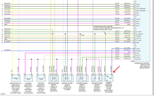

That sensor looks like it is on the power steering pump, correct? I don't think that is the crankshaft sensor because it would be located at the lower right front of the engine block. the sensor in the images above is the power steering pressure sensor, here is the wiring diagrams for it so you can repair the wiring and the location of the crankshaft sensor so you can swap it out. Check out the images (below). Let us know how it goes.
