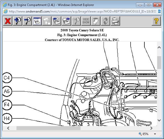

I took the car to sears and the mechanic told me the only code that came up was for the crankshaft position sensor. Shocked again; I was very confused as to why Toyota would say replace the engine if I can just replace the sensor. Can you tell me the location of the sensor for a 2008 Solara 2.4L and offer any advice on what options I have besides replacing the engine for $6000.00

Does the car run all the time or does it not start sometimes?What are the symptoms your having?Also do you know the exact code number it is?I would need a lot more info why the dealer told you to replace the engine.

Its C4 in the diagram

Troubleshooting P0335; I haven't had any major problems
with the car. I just had the oil pan replaced six months ago.

That code is usually a bad crankshaft position sensor but I would inspect the wires and connector going to it.To test it you would have to test it when it was failing.If It was my car I would try inspecting the wiring and connector if all looks good then replace the sensor.

I took my car to the mechanic and the car is burning excessive oil! Will replacing the crankshaft position sensor correct this problem or will I still need to
Replace the engine?

OK that makes sense why they told you that you need a new engine.No replacing the crankshaft position sensor will not stop the oil burning.
