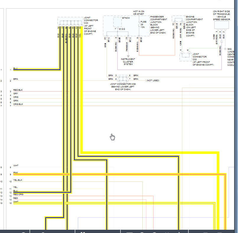

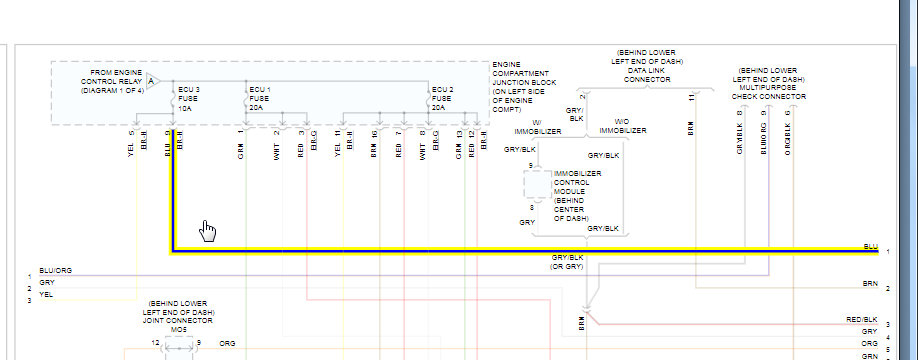

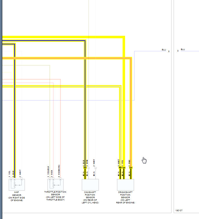

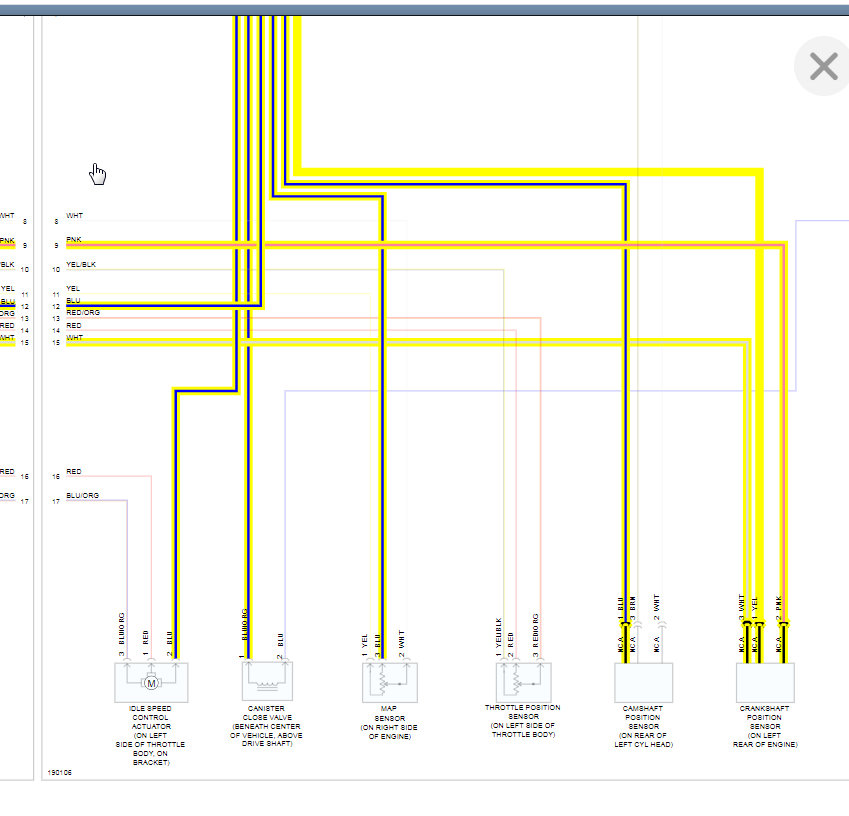

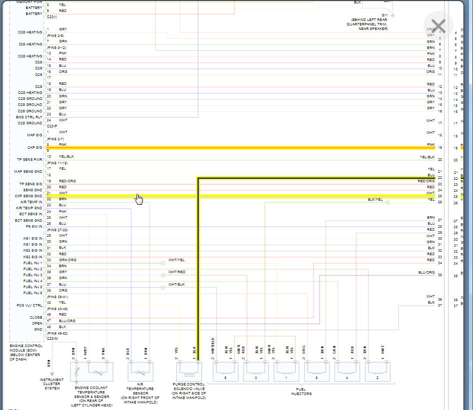

If so, we need to measure voltage at the sensor. You have one wire (yellow) that is from a shared fuse for all the other sensors. It is possible that one of these other sensors/actuators is shorted which is causing an issue with the crank sensor. The other possible cause is as you stated that the control module has a short.
However, lets start with checking voltage at the sensor and going from there. Thanks

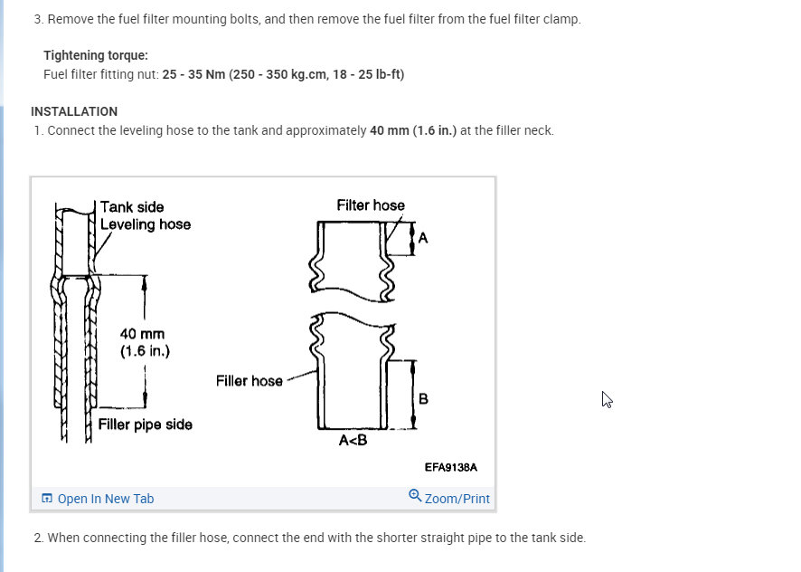

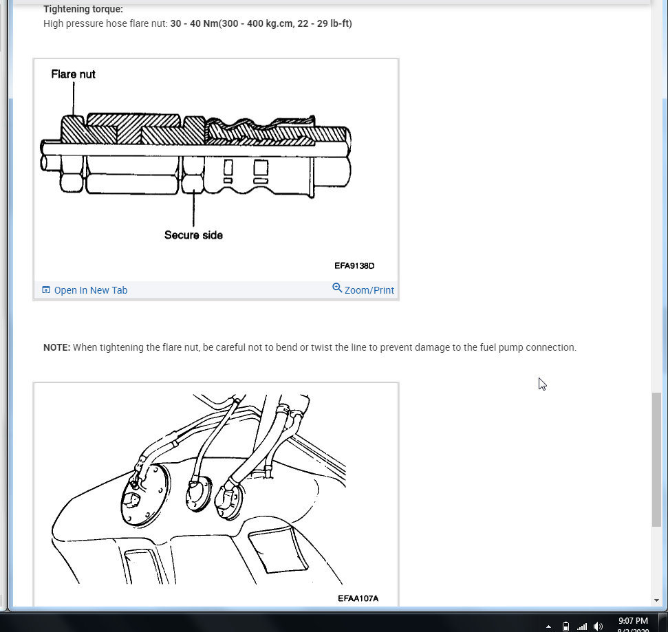

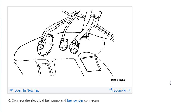

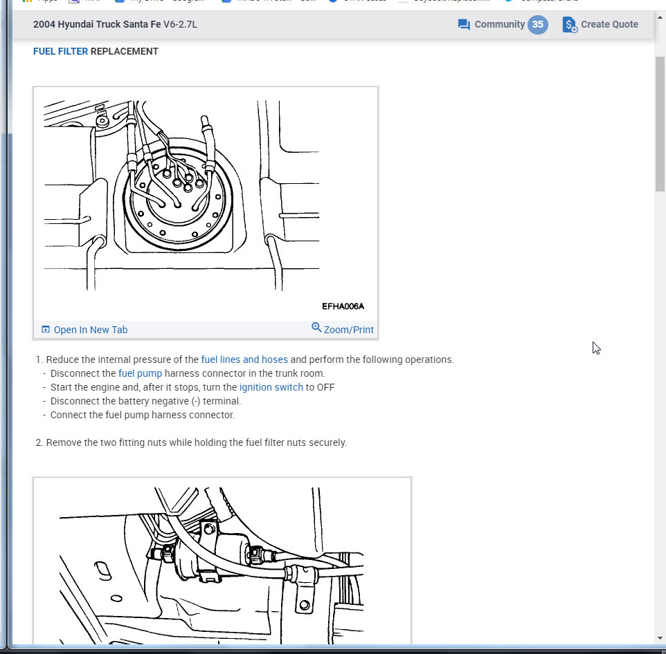

I attached the info on the filter. If they think it is a fuel issue then lets check the fuel pressure to try and confirm this. Just because the pump is new doesn't mean it is operating properly. Was this issue happening before that was replaced?
Here is a guide on how test the fuel pressure:
Jul 31, 2020 at 10:52 AM

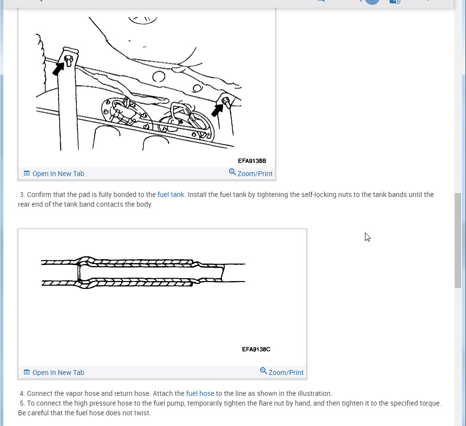

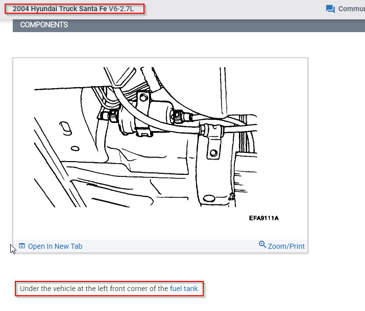

I attached the info about the fuel filter. It is in the left front corner of the fuel tank.
This link will take you to a guide on how to check the pressure:
As for the video, that could be a fuel issue so we need to start with checking these two things (filter and pressure). However, what I suspect earlier is a possible throttle sensor. The fact that you replaced removed it and plugged it back in seems like the PCM may have been learning the sensor again so it worked normal until it learned it and then it started acting up again a block later. Which specific sensor did you unplug? Can you get a picture of it?

The manual for a 2004 Santa Fe 2.7L says it is on the left front corner of the fuel tank. See attached. Unfortunately, I have to trust this info. If it is not there then you don't have one and the filter is in the tank on the pump.
