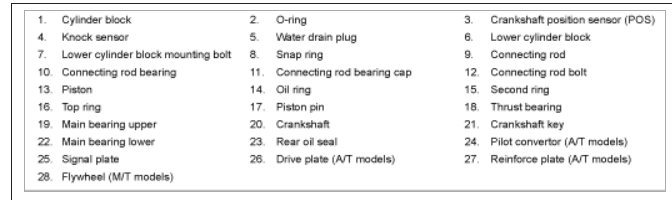

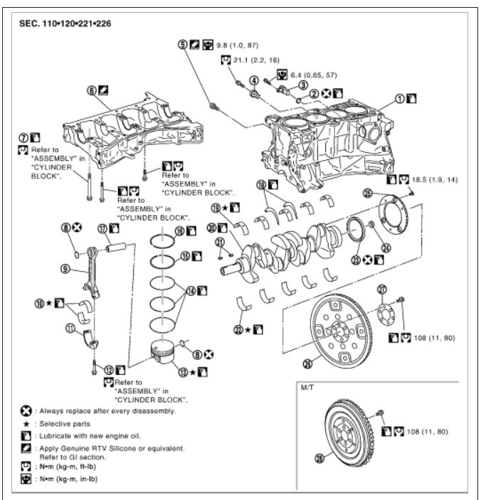

Hi, I currently have error code 0335 CKS and I am unable to locate it. Please help.
Aug 16, 2016 at 7:40 AM
WRENCHTECH
  • 20,761 POSTS
It looks like it is on the top of the block, near the transmission. Check out the diagrams (Below). Please let us know if you need anything else to get the problem fixed. https://www.2carpros.com/images/external/197552680.gif
Aug 16, 2016 at 12:32 PM

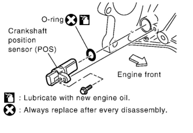

I dectected that my xtrail tends to shut off when driving I put the scope on the vehicle and it read that the crankshaft positioning sensor is defective so I went out and purchased the part.My question is where is the sensor located in the engine
Reguards
Lee
Dec 9, 2020 at 2:11 PM (Merged)
MHPAUTOS
  • 31,937 POSTS
Hi there,
The sensor is located at the right rear of the engine, see pic below. Here is a guide to help you see what you are in for when doing the job.
Here is the location on your car.
Cheers
LIVIO
Thank you worked perfect!
