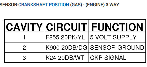

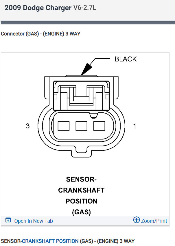

Connection to the crankshaft position sensor got pulled out and I'm not sure what wires go to what pins is it three pin one is yellow second one is dark blue and white, and the third one is a light green.
Jun 28, 2025 at 6:01 AM
  • 55,845 POSTS
Sure, here is the crankshaft sensor connector and wiring assessments. Check out the images (below). Let us know if you need anything else. Yellow, dark green and white wires.
